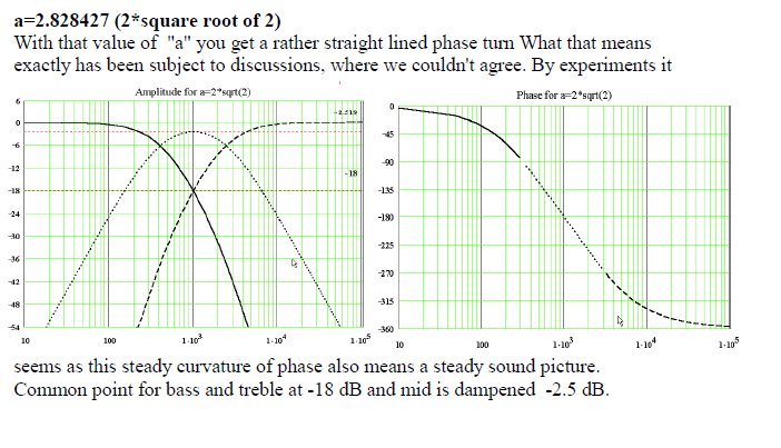

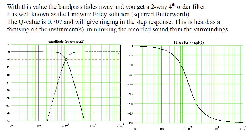

Much better is the Duelund crossover which looks somewhat simlilar, again a filler driver in use. But this time all drivers are always in phase and the slopes on the midrange are second order, much more managable yet still tackling the midrange driver low frequency excursion capabilites which limits its usefulness. Total phase response is that of 4rd order two-way. Phase can always be corrected by pre-distorting the input signal that "unwraps" the total phase contribution of the crossover to zero, via DSP.

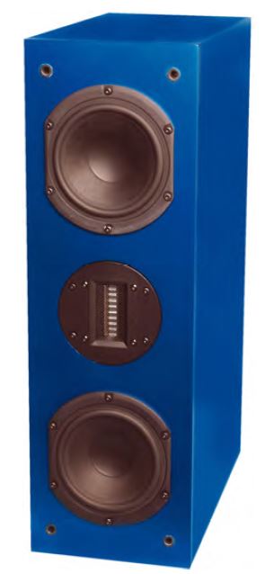

My own speaker designs incorporate a lot of algebra and theory:

Some random images below. All is symmettry! :cool:
