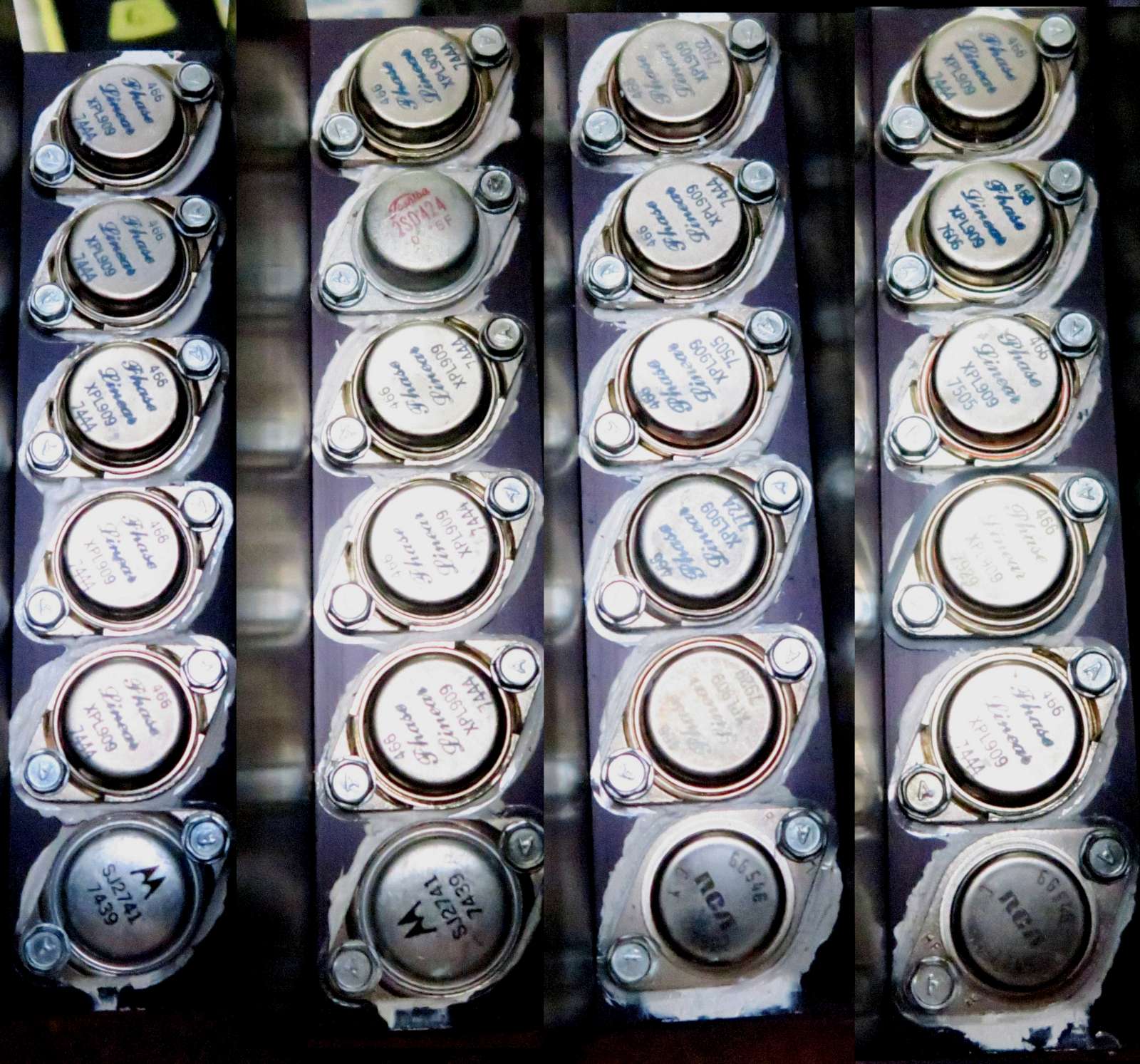

Of the 24 Output transistors on the back 19 of them are Phase Linear so I am assuming they are original, others are 1 x Toshiba, 2 x RCA and 2 x unknown brand with stylised M.

I would be very wary of any PL that had mix-matched output transistors. There are 5 parallel outputs (and one driver) in each group, and all 5 of the parallel units all need to be the same. The driver was originally an RCA house number and there were several versions of the “PL 909”. The only one that was worth a damn was the Fairchild version. If any of the parallel banks are mismatched, they really need to be swapped out with all the same type for reliability. The best type to use as replacement is the MJ21194 (or 21196), for both driver and output. 15024 is good too, and is in fact better in the PL400. The RCA drivers are fine if they are still good, but don’t use a PL909 as a driver. Personally, I would change out any PL909 that’s not the Fairchild type (the “F” logo). The others were all ticking time bombs. RCA1B05 are ok for outputs, if your particular amp had them. I still have a PL400 with them in one channel. There are *no* suitable Toshiba parts for output or driver for the 700. The 2SD424 is fine in the 400 but not the 700. It is only rated 180 volts and the typical is only good for 220. If your 700 has a high line voltage they will blow.
Attached is a photo of the output transistors.
From what you guys tell me I need to replace them all and go through the unit joint by joint and possibly replace everything else as well. Paying a pro to do this would cost me more than the unit is worth and even then it might not fix my problem.
Seems the best use for it is a scultpture for my mantle unless I can find a friend who is into electronics to have a go at it for me as a fun project.

You’ve got to fix your problem first. That’s unrelated to what type of output transistors you have. The bottom row are the drivers. One type in one channel one in the other. No problem at all with that. Those Motorola SJ2741 are MJ410’s, and those RCA’s are similar. That 2SD424 is worrisome, because it is underrated for voltage and mismatched with the rest of the bank. It could hog current and get over stressed, or sit there and not take any of the load. But the other problem s running a D424 on +/-110 volts. They are very rugged, but it is playing with fire unless you screen it for breakdown voltage and be sure it can block the entire supply voltage plus margin. The combination just isn’t safe. I would have swapped all 5 of those out for MJL21194, or maybe the entire channel. Then you would have 4 or 9 PL909’s if you blow any in the other channel. The X PL909 isn’t very rugged compared to the F PL909 or the modern On Semi parts, but it you’re not blowing them under you’re usage they may be ok especially if you have extras on hand. But don’t even fool around with any of that till you find and correct whatever bad connection is causing your immediate issue.

The original caps are long and skinny, but it should be possible to use snap-ins with wire leads added to them. That might be the only thing that will *fit* as you may be stuck using 200 volt caps. The originals will be 125, which is not common anymore. 200 volt computer grade types are usually too big around and 100 volt isn’t enough. They may not be bad, but the fact that it makes a loud buzz when putting DC to the speaker suggests they could be. Once you get the amp working run a short duration sine wave test into an 8 ohm dummy load. If you don’t get rated power the caps need replacing. If you do, they don’t - yet. If you blow XPL909’s with a 5 second full power test at 8 ohms that will tell you they’re not safe enough to use. FPL909’s, RCA1B05’s, 2SD555’s or MJ15024/21194 *will* take that, no if’s ands or buts.
This particular amp (and many like it) have “strange” requirements for setting output transistor bias. You don’t want quiescent current in the outputs, just the drivers. It is supposed to be set for 350 mV from base to emitter of one of the output transistors. That results in zero bias in the outputs, and 60 mA bias in the drivers. The quasi-comp triple is often unstable (it can oscillate) at a few mA of quiescent current in the outputs when running at this high a Vce. They are stable at no bias, and become stable again at high bias (but will generate too much heat that way). Newer versions of the Series 2 switched to full complementary outputs when the MJ15025 was invented. The full comp version was better, because the output stage is locally stable at ANY bias. You can set those to 3 to 10mA per output transistor, which is a good compromise between crossover distortion and heat generation. Most modern PA amps set it there. But with the original quasi-comp stage that almost guarantees oscillation.
