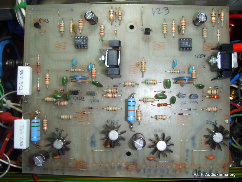

OK, here is the current situation, not that easy: I've put left channel rail fuses. Set main PS at the stepped level of 10-20-30V and measured DC at outputs. Offset voltage was almost equal to PS level. Across both zeners very low readings (1.4-1.8V). Didn't keep the circuits up too long to avoid a new damage. For the same reason didn't want to increase PS voltage - anyway going from 10V to 30V the voltage on zeners was marginally higher (unlike it is the case without rail fuses on). When I took out the fuses, across both zeners the voltage was good = 4.4V-10.2V for the same main PS levels (10-20-30V).
All drivers and outputs were installed. I've checked them with ohmmeter - in line with the service manual - they seem all be good (not shorted).
Can that be one of the faulty drivers, that PL36 is trying to drive and therefore zener's network shows overloading?
Again, please share your views and suggestions. Thank you!

Here is the recent news from my on-going repairs of PL700II (fully comp. model):
  • rail fuses for the left channel in, for the right channel out
  • drivers and outputs NPN/PNP of the left channel (the one with excessive DC on the output) - all temporarily taken out
  • repeated tests to check zener network voltage (at 10-20-30V measured on PS bug caps) - success
  • checked DC at the left output binds - ca. 10mV, seems OK
Then installed ONLY the drivers: MJ21196/MJ21195 (from the pool of taken out transistors, but measured and not shorted). Results:
  • test to check zener network voltage at 10VDC - success
  • checked DC at the left output binds - 8,5V -> bad news.
Unsoldered one lead per D101 and D105 to disable the protection circuit temporarily. Drivers still in the circuit. Results:
  • checked DC at the left output binds - 8,5V -> same bad news.
Conclusions?
  1. the protection circuit didn't cause this problem
  2. pre-drivers seem to work properly (only with rail fuses in they are biased)
  3. after adding NPN/PNP drivers and testing, the problem of excessive DC on the left speaker's output remains...
I am looking to the schematic and more getting hypnotized than figuring out what is happening here...
Quick actions on my side: replace the drivers with factory new ones and do carefully (once more) inspection of the TO-3 sockets wiring.
Still I believe there must be another reason.
Dear Phase Linear Experts - please support!

First check / replace C111 / 211 (100uF electrolytic)
Let's check some voltage points...
Left output fuses installed, but no driver or output transistors. This will power the pre-drivers (40327 and MM4003). No output load or input signal.
What is the voltage between the base and emitter on Q101 and Q105?
What is the voltage across the 180-Ohm resistor (R127 / R140)?
1. First check / replace C111 / 211 (100uF electrolytic)
2. Let's check some voltage points...

When troublesooting the driver board, you have to use full power supply voltage or close to it. +/- 80VDC should be good (this is what the model 400 uses). Then, when the amp is finally working correctly, you can hit it with the full +/- 100VDC.
This and other asymmetrical op amp driven power amps will not "center" correctly at low Vcc. If you're still scared to bring it up to full voltage there will be problems. If it takes full Vcc with no rail fuses and passes a signal into a 1k load you're half way home and the amp probably works.
One thing you can do is to install the drivers - but not outputs - and temporarily put 100 ohm resistors across the fuse holders. The drivers cannot be damaged even in the event of a fault (but the resistors could fry). Adjust the bias for around 350mV across them and you're safe to install outputs.
Of couse, it a whole lot easier to just power the darn thing up through a light bulb limiter.

Hello THD,
I did the measurements. Testing environment first:
  • C111, C211 replaced
  • The amp was plugged through light bulb limiter only.
  • Left channel rail fuses installed, the right fuses out.
  • No drivers or outputs.
  • No input signal, no output load.
  • PS voltage on main caps was about +/- 100VDC.
Here are the results:
  • Pre-drivers (40327 and MM4003) B-E voltage, left channel: 0,58-0,59V. The right channel: 0,68V for the both transistors.
  • R139 180-ohm (between B-E at Q107 driver): 0,59V
  • R140 180-ohm (between B-E at Q108 driver): 0,60V
  • R239 same location and for the right channel: 0,51V
  • R240 same location and for the right channel: 0,49V
  • R126 180-ohm: 0,33V
  • R114 180-ohm: 0,31V
  • R226 same location and for the right channel: 0,32V
  • R214 same location and for the right channel: 0,32V
And DC on the left output was only 3,2mV...
What you think are the conclusions?

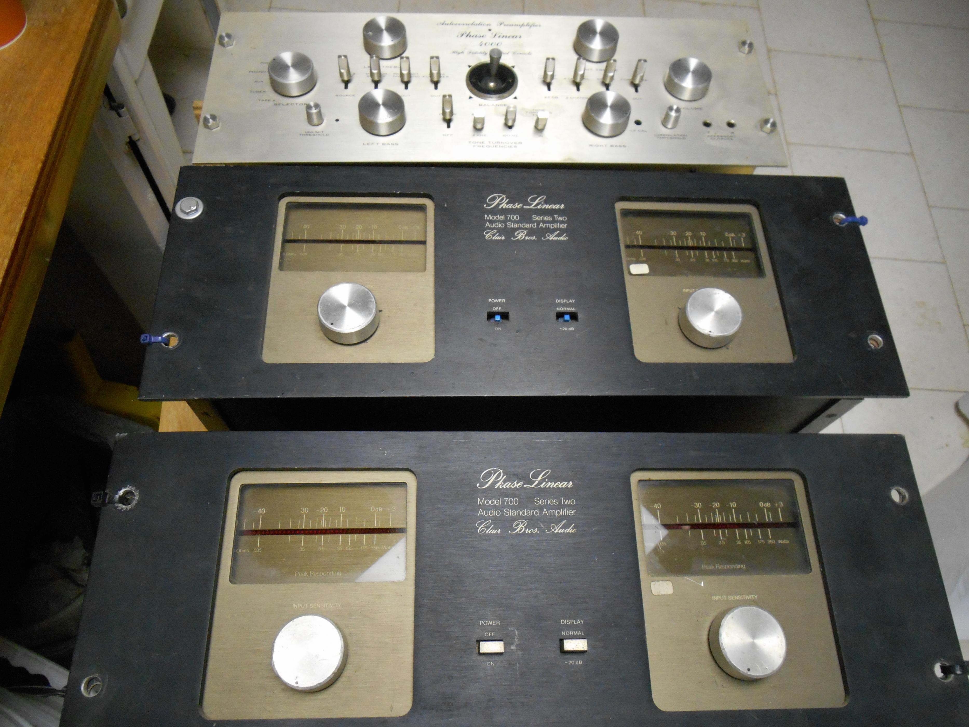

Hi Folks;
Christmas came early! I just had to snap up these (future) beauties! I have been a Phase Linear masochist/fanatic since my teens. Neither amp is functional. I hope to create at least one "WOPL". One amp was plugged in and the first led on each channel lit. The other amp is missing the main PS caps, and some outputs, that one did not even get plugged in.
I will re-read this thread and the link to the other forum.
Regards, Peter in Canada

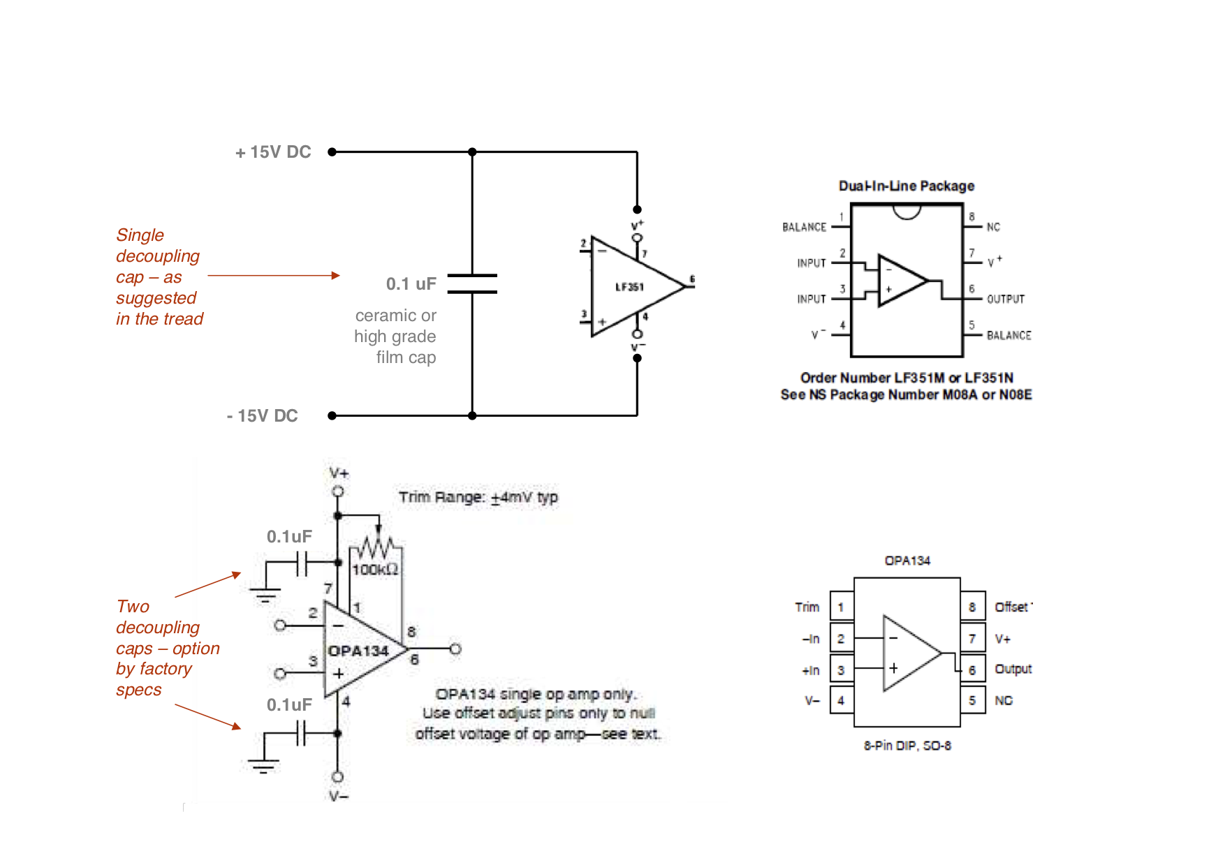

  9. The Op-Amp IC LF356 replacement with LF351 was recommended by the factory, so is the replacement of R1, R2 from 2.4K/5W to 7.5K/5W (the LF351 op-amp has better specs and helps with turn on/off thump). I don’t want to open a separate debate on whether LF351 is fine for front-end applications or not, in view of many options available these days. The op-amp in the P/L design had one purpose: to provide high gain and it was used to replace a traditional differential input pair - much more refined solution known from P/L 400-700 Series I. This had few advantages back in the 70's: all the transistors inside the op-amp could be closely matched (important for a differential amp) and production / testing was more efficient since matching of transistors was no longer necessary. LF351 is not at all a bad op-amp (in later complementary models there were also TL071P Low Noise used as the op-amp). So, you may leave it as is. However, for All who like experiments the use of BB OPA134 op-amp as direct replacement to LF351 might be sound quality beneficial upgrade.
  10. Regardless whether you stay with LF351 or not, there are some common practices you may want to consider for the op-amp working conditions improvement. First is to add decoupling 0,1uF (e.g. per 100V) high grade film type cap on the +/- 15V rail supply and mounted directly on the supply pins for each op-amp (diagram here Any Phase Linear Experts out there? - Page 5 - AudioKarma.org Home Audio Stereo Discussion Forums). The solution helps in removing power supply noise and possible distortions at high frequency. Second would be to add 4,7uF/35V electrolytic cap ('reservoir') in parallel to each D1, D2 Zener diode. Be careful though - too much capacitance increases the turn-on thump.

Hi, from the perspective of time I should say it is the least important intervention to get your PL Series Two gear back alive and kicking. If want to try then just keep the caps polarity vs Zener diodes correct as they go in parallel. That's all. As for IC's decoupling, attached is a simple drawing. More info here: Phase Linear 700 Series II restoration advice - updated | Phoenix Audio Community Forums

Be careful with op amp rolling in this type of amplifier. THE reason the LF35x was used is because it will tolerate the amp sticking to the rail under fault conditions - putting out the full + or - 75V DC though the feedback resistor into the minus input. Turn on transients can put the same kind of peak into the input stage. Not all op amps will take this, even some premium FET input ones will die (ie, OPA260x).
