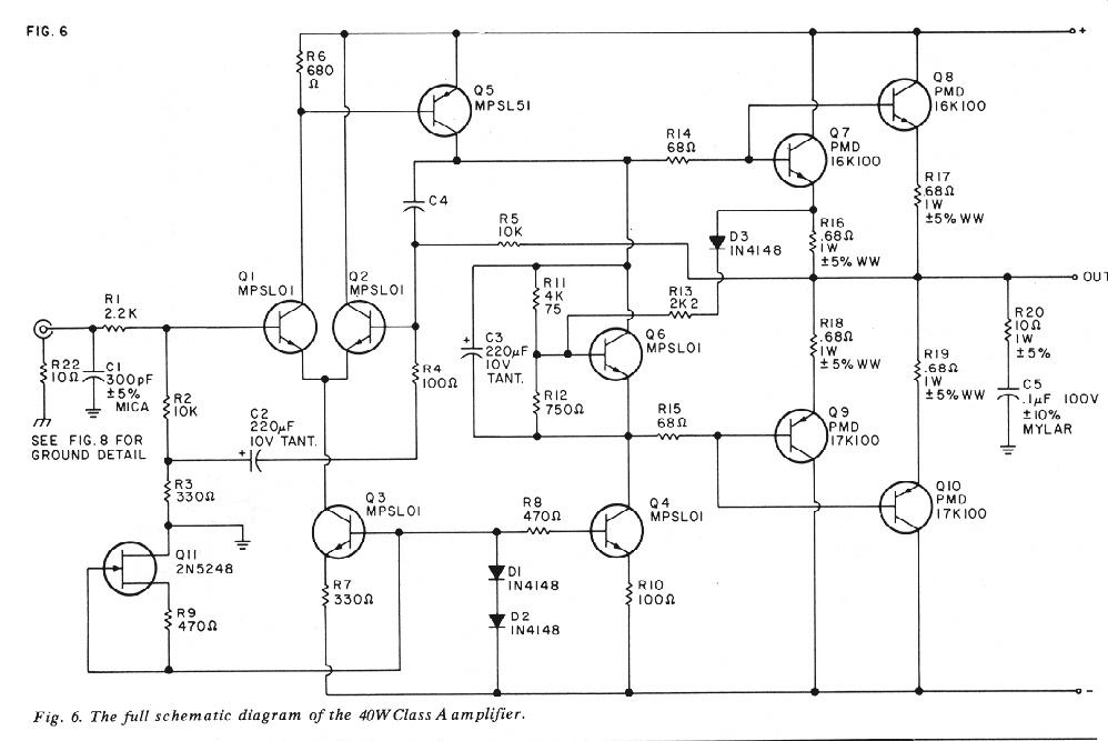

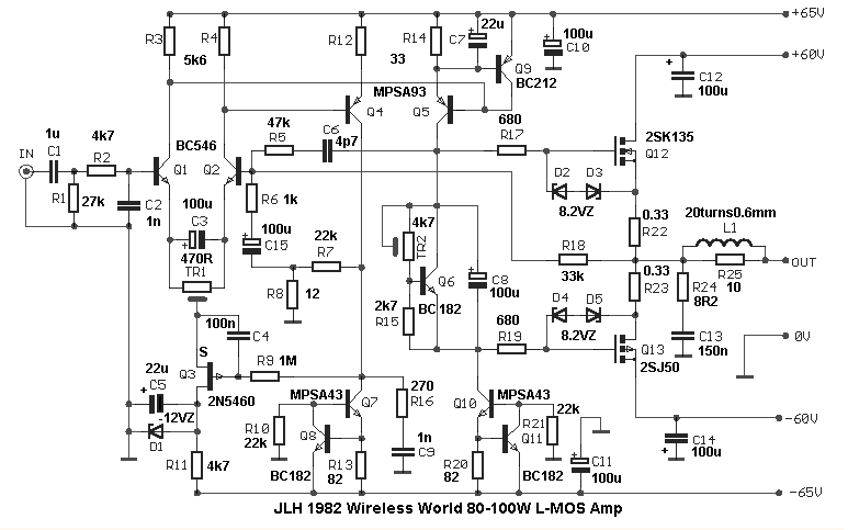

in a later version of the JLH he adopted a variable resistor for R5 and said trim until the squarewave was the most accurate shape. But he had 5 different locations where he installed comp in this one amplifier. Crimson also has multiple comp locations.
This type of compensation is very common in British designed amplifiers. Much less common outside the UK.
Notice the ratio of nearly 3:1 for r20:r14, the delay on the q9 protection and 4locations for comp.
What is the purpose of C4?
