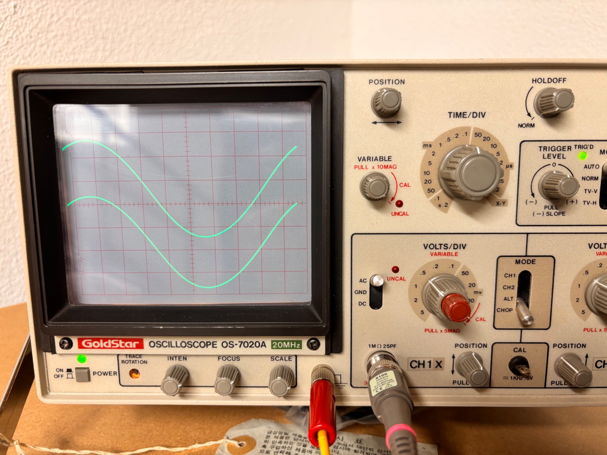

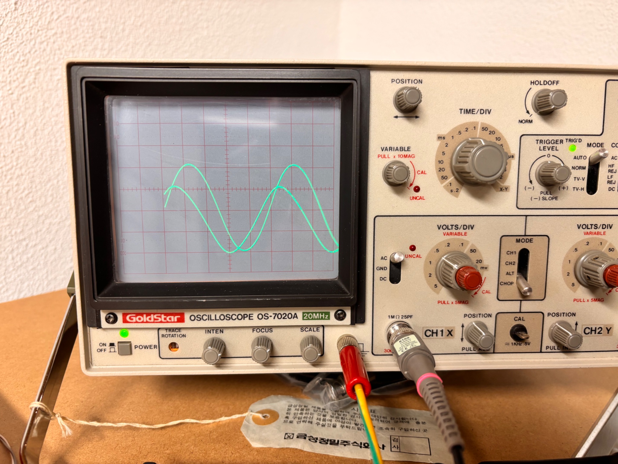

What signal phase delay (input/output) is considered normal in a 2 stage, passive riaa- tube phono amplifier?

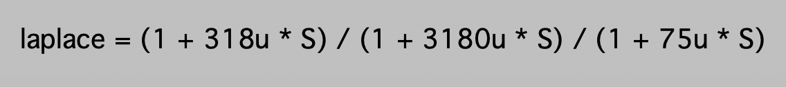

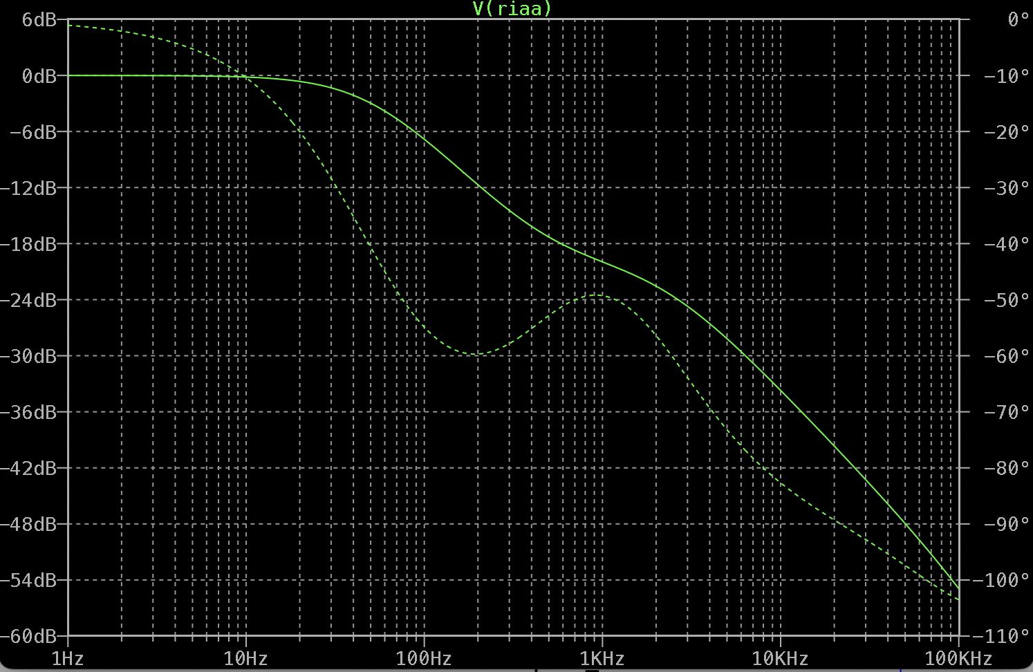

Well, the theoretical values/math are correct. So even if small practical adjustments is needed (after measuring), the baics are right. My question was more of a general one. Is there any charts showing what phase delays to be expected, caused by the riaa poles and zeroes?

So far I haven’t measure the frequency responce. Just connected my signal gen (at a mV level). To see if the amp was alive or not. This measure shows the phase delay between input and output at 1KHz.
Well that’s the ultimate objective. If your EQ has the right number of poles and zeros and the frequency is up 19.911dB at 20Hz and down -19.911dB at 20kHz, both referred to 0dB st 1kHz, both the frequency response and phase response must be correct. So that’s all you need to actually measure.

This will help. Bear in mind that there will be at least two of these HP filters in a tube RIAA phono stage.
The RIAA response is that of the entire phono circuit, not just the passive RIAA components.
Each coupling capacitor adds up to 90 degrees of additional phase shift (which will vary with frequency) near or below the pole.
The phase shift at the pole frequency is 45 degrees, and the HPF adds about 5 degrees even at ten times the pole frequency.
