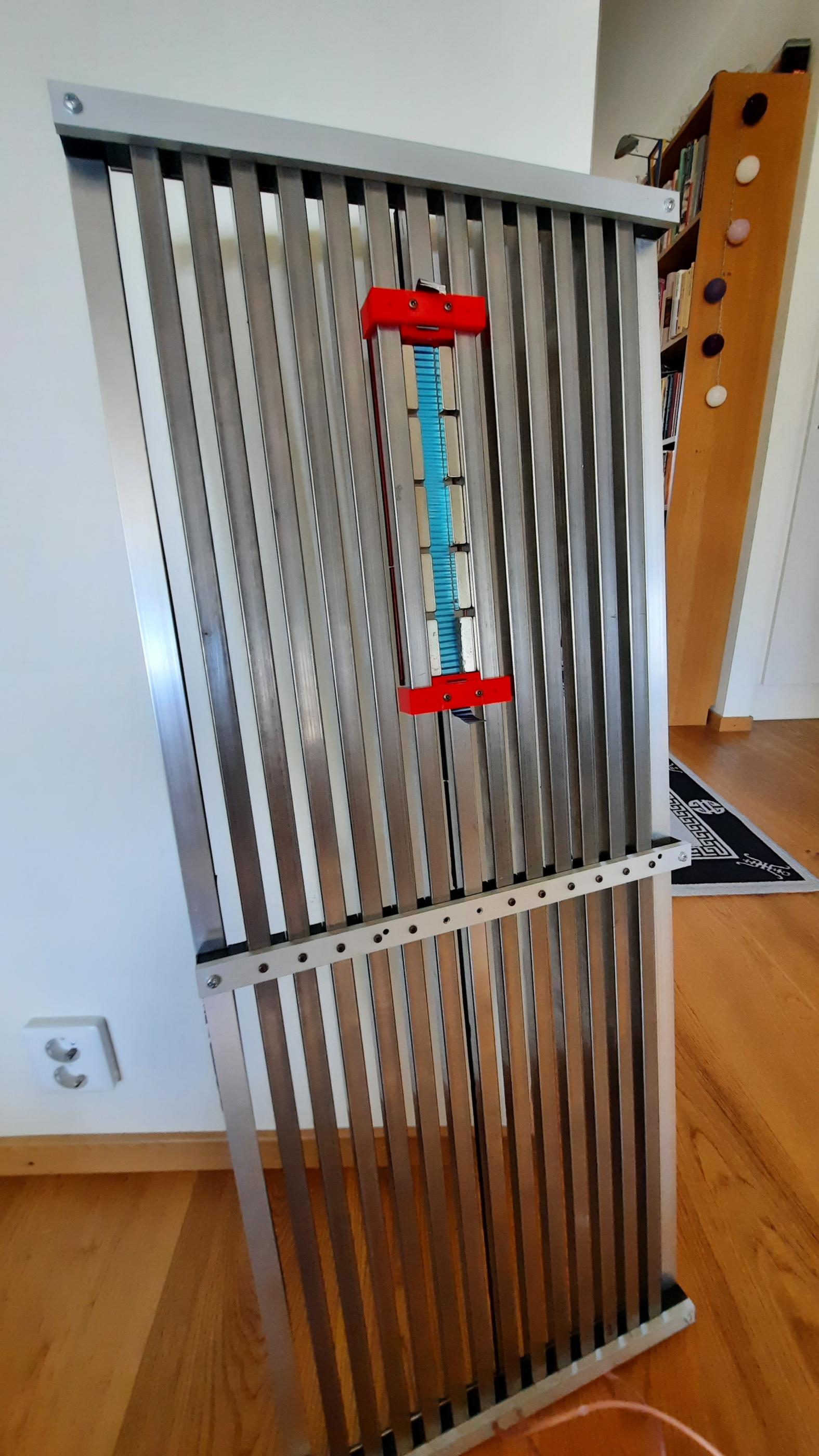

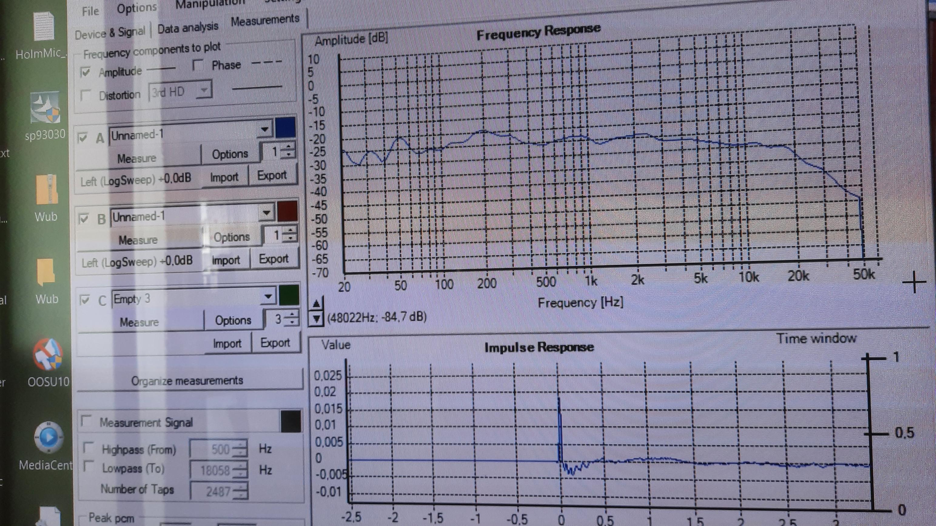

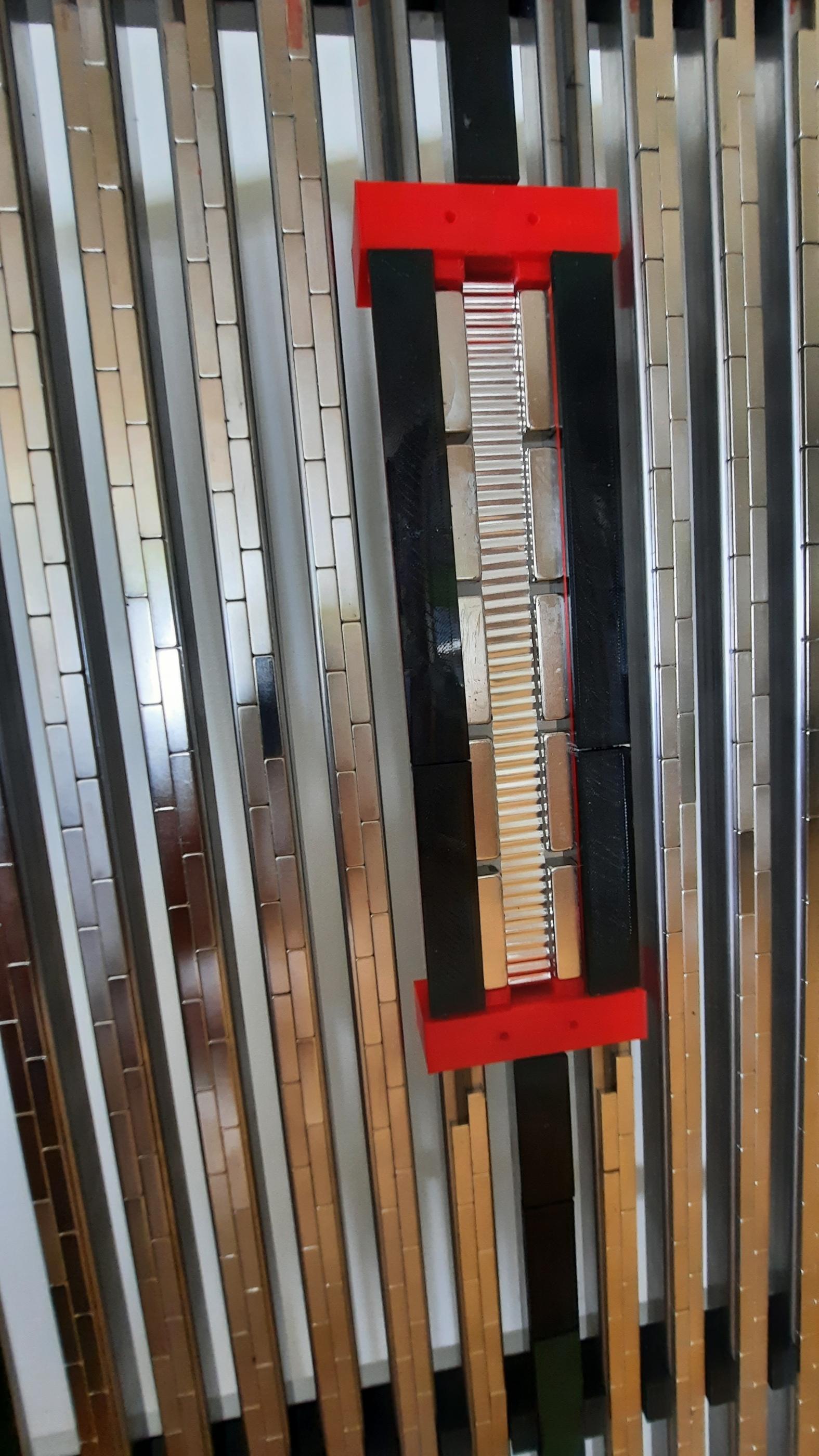

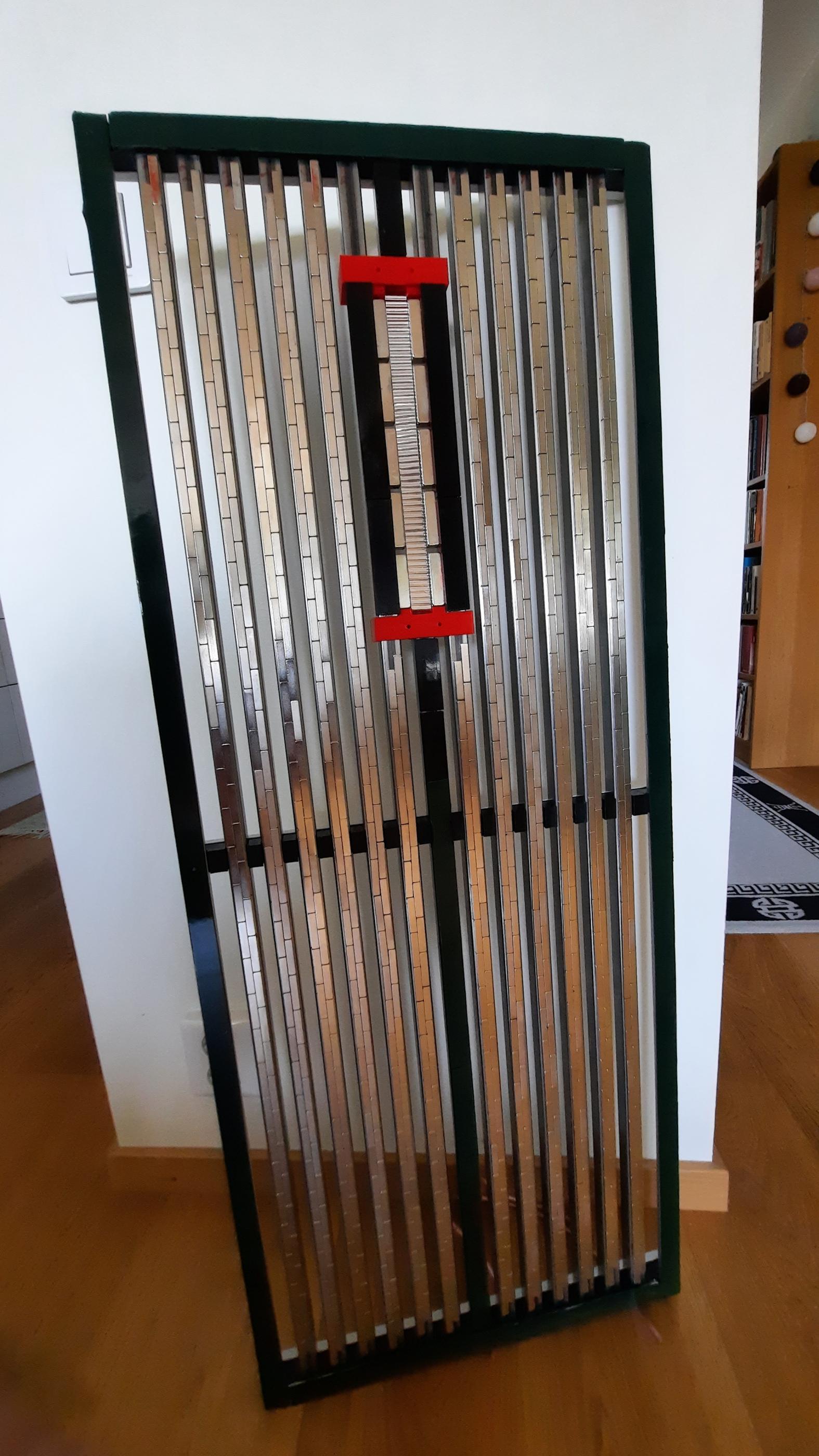

These are my new fullrange phase correct planars! (or at least one half of one speaker)
I´ve integrated the tweeter into the bass driver for easier phase alignment.
Bass magnets are 30x7x2.4 mm, 1320 of them in each speaker.
The reason for phase correctness is the resulting very pleasing sound stage.
I`m planning to build in push pull fashion with an X-max around 10 millimeters and a sensitivity of 90 dB.

Very nice !
I have been considering a real ribbon bass design for awhile but those magnet prices these days!
This is similiar to the Eminent Technogoly series.
I got a chance to hear the Alysvox true ribbons this past weekend at the Long Beach Hilton , and they were stellar
94 db / 4 ohm nominal , not on top of course
Tight impulse response is where it’s at and very nice !
Joined 2002
Very nice !
Not that expensive using these:
https://enesmagnets.pl/shop/en/perm...ts/30-x-6-x-2-n38-ndfeb-neodymium-magnet.html
...around 270 Dollars per speaker. Half that for a one sided version.
