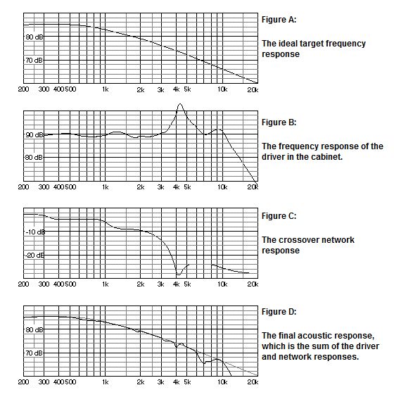

Thiel Inc. is technically based upon 1st order acoustic crossovers, supported by physically time aligned speakers on slanted baffles. "Back in the day" a 1st order crossover was a single capacitor or inductors, a philosopyh of simplicity=perfection. A REAL 1st order acoustic Xover has dozens of components(fig 1&2).
The Coaxial speakers from Theil and KEF appear to be a "white flag" that old-school phase coherence between tweeter+mid is difficult/expensive.
