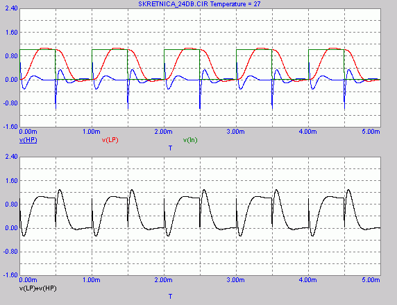

All stock 4th order filters are 180° (more or less) out of phase at XO point (2nd order are 90°), and have 360° total phase shift (2nd have 180°).
Now, here is how it looks squarewave passed through Linkwitz-Riley 4th order crossover.
Pedja
