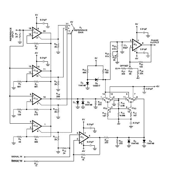

if anyone wants to measure "phase":
I had some boards burned for a DIY Phase-Meter. It's based upon an Intersil application note, uses a couple current-feedback opamps to feed a high speed comparator. The output voltage is a linear function of phase. Since the Intersil specified opamps are not easy to obtain, I used a Texas Instruments part. If you don't need "high speed" you can substitute parts, in the configuration shown, however, it should work to 10MHz . (btw, the TI and Intersil parts have a "disable" function which reduces the amount of switching greatly.) If anyone needs boards contact me at jack@tech-diy.com
Here's the schematic as it appears on Intersil's site.
