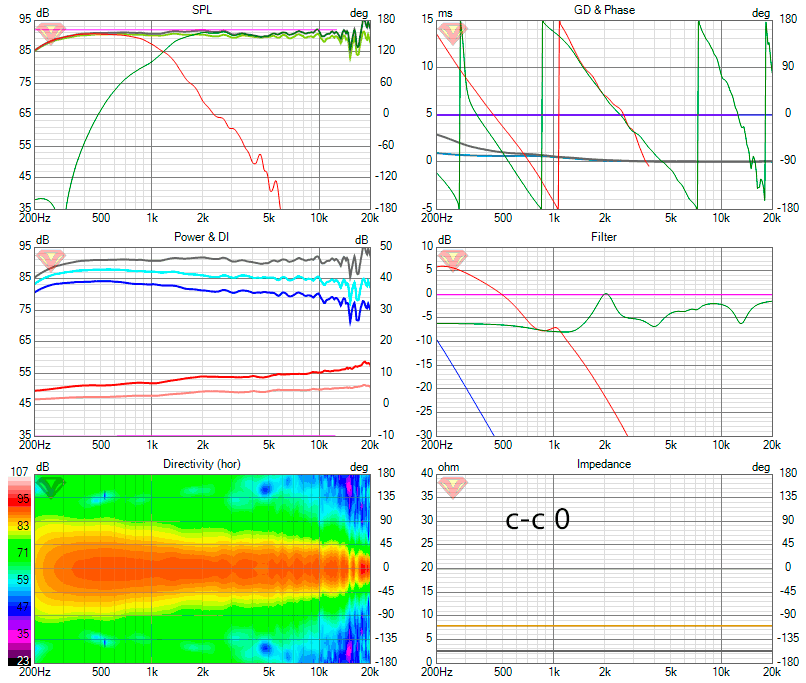

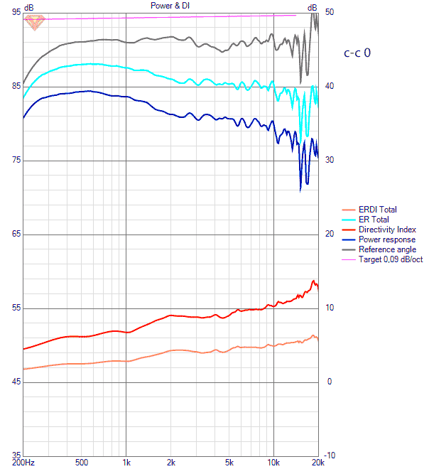

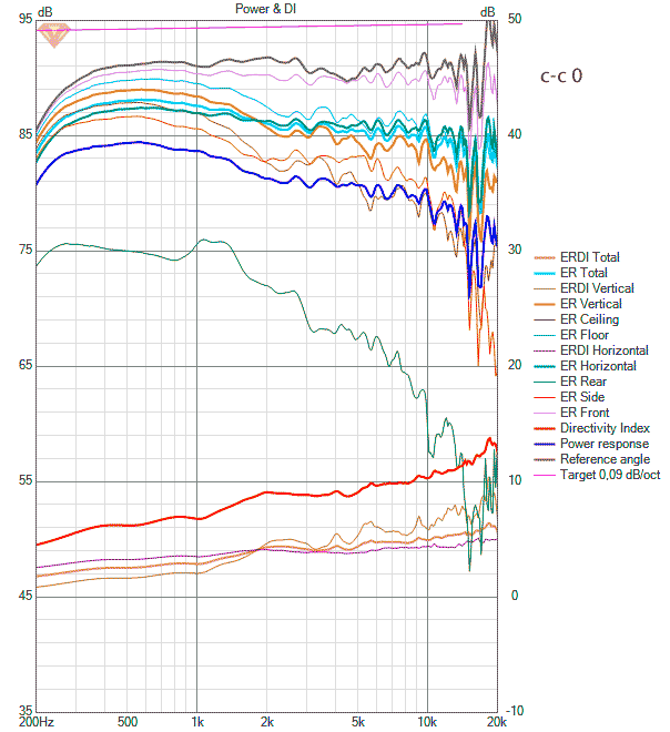

Made few visualizations to support discussion. These are measurements of a prototype box with only mid and tweet and the c-c spacing is changed in the simulator to kind of test what kind of relationship phase tracking and ER and listening window response have.
c-c spacings on all attached GIFs are 0 (coincident), 0.9wl at xo (as close as possible with the prototype box), 1.2wl and 1.4wl increased c-c spacing.
1. VituixCAD sixpack showing phases on the top right, the phase tracking is best around xo on the coincident case and gets more off as c-c increases as expected.
2. Power, DI and ERDI showing that the 1.4wl spacing has closest resemblance to coincident configuration in terms of DI and ERDI, and the as close as possible c-c spacing gives greatest difference to the coincident. The power and on axis responses droop as the c-c increases but could be corrected with a filter because DI is about the same as with coincident case. Interestingly, DI and ERDI seem to be most alike on the c-c 1.4wl spacing.
3. another look showing all the possible ER graphs, The non coincident drivers spacing is clearly different than the coincident, 1.4wl approximating coincident best of the test set. The settings are for my livingroom, 240cm ceiling ~3m listening distance, 90cm reference height, 45 toe in, against front wall away from the corner.
Anyway, looks like the phase tracking requirement is related to the c-c spacing. If the ER sound signature is more important at listening position than the phase as such then it is not necessary to go with phase tracking I think. The observations might change if each of these c-c versions was optimized by some parameters, now only the c-c distance is varied. The crossover is optimized for the 0.9wl situation and it has the smoothest response (DI, listening window) because of this.
More tests in the sim would be interesting at some point, like what the responses look like if phases were tracking on each c-c or the on-axis response were optimized etc. And then test if there is clear winner soundwise 🙂

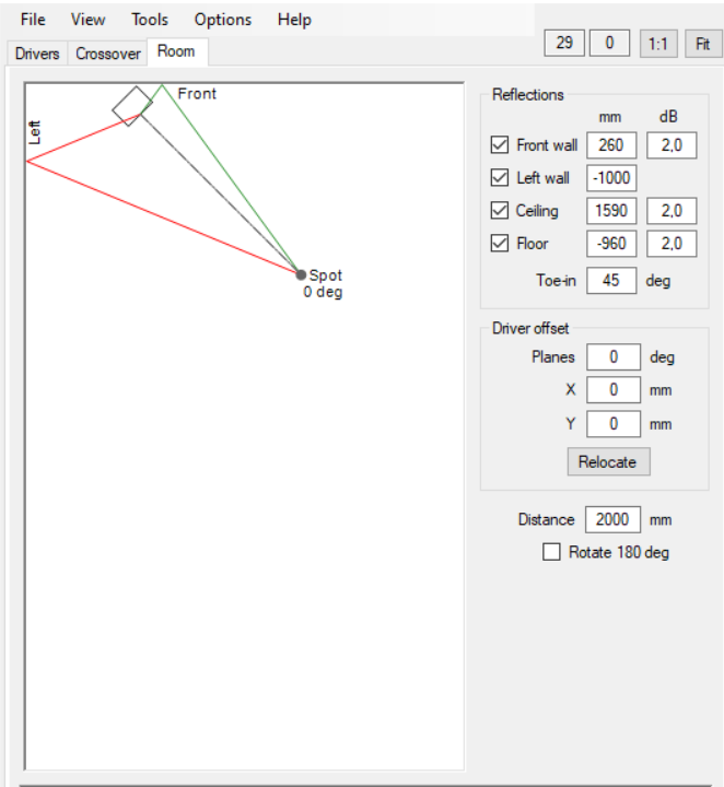

ps. I know ER depends on the listening situation (nearfield / farfield, acoustic treatment) so this is just a visualization with data I happened to have and would not be in favor or against the phase aligned crossover design. I suspect the phase tracking would be more important in nearfield / low ER situation if ever.
edit. added room config for reference.
edit. noticed listening distance is 2m when it should be 3m. Anyway, not much difference as demonstration.

A quickie, same c-c distances but now also delay on the midrange is adjusted for the c-c change. Forgot to mention in previous post that the reference axis is tweeter on-axis and when adjusting c-c the mid driver drops virtually lower in height and thus gets farther away from the listening spot. This is seen in the phase graph, the tweeter phase line (dark green) stays the same and the mid phase (orange) changes when c-c changes. See previous post attachment 1.
This new set has delay compensated, EQ phases are aligned despite the c-c changes by adjusting mid range driver delay with a DSP delay block. As you see phases track each other on all c-c and the on axis response stays now about the same. Listening window changes a bit, DI changes a bit and most change seems to be with the the ERDI.
Reasoning from the data: as soon as the listening position change the phases don't track anymore because the relative distance from each driver to ear changes. For this reason I think the phase match can be adjusted only for one listening axis (vertical) an distance. Phases lose tracking as soon as distance to each driver to ear changes. Although the change is relatively small depending on the listening distance, xo frequency and c-c.
Well, for this reason I'd say phase tracking is not very important for the sake of it. I'd say the effects relative phase of the drivers have to the frequency response to various directions is more important. When the frequency response is similar to all directions then the "phase tracking" is as good as possible to all directions right? And not just for single listening spot. As long as the acoustic design is good enough, so that this "average" good phase tracking (response to all directions) is smooth the speaker optimized for far field listening in reflective environment, where ER contribute to the sound at listening position.
This quality, sound to various directions, is easiest to monitor with the DI and ERDI. Make them smooth and far field sound around listening spot should be as stable as possible. Phase match/tracking could be perfected to one listening spot, which could be advantage on near field listening situation.
Does the reasoning sound valid? I haven't thought or studied this too much before.

yes all the posted graphs include effect of full vertical (and horizontal) response. It is full 360 horizontal and vertical data although taken with 15 degrees resolution. Forgot the polar map to horizontal in the first post so repeated the same on the second 😀 The difference in the graphs posted is mainly due to the vertical offset of drivers, which is standard arrangement for most speakers. Here is vertical polar plots attached if you want to check how it looks like.
Profiguy mentioned effect of phase tracking to sound stage and I started thinking it through, what implication of phase might make or break "imaging" since the phase itself is certainly a mixed bag at listening position due to reflections. I assumed he talked about far field listening.
I tried to test why would phase tracking matter in far field situation with early reflections, and why would it affect the perceived sound. If phase itself was responsible for imaging there would be no imaging in reflective environment. I used varying c-c test as an example here since posted similar thing to another thread recently, but could have used a delay or rotation or something else as well that varies the distance of drivers to the simulated listening point.
Interesting observations from the example is that the phase tracking crossover (roughly LR4) seems to yield smooth off-axis response. Another interesting observation was that the phase alignment is good only for one location since the transducers are not coincident and distance to each changes when ear position moves vertically or closer / further.
My conclusion is that if phase tracking affects imaging in far field listening it has to be due to ER because the phase info is kind of lost in the listening position due to reflections. When the sound of very early reflections is same as direct sound then the imaging should be as stable as possible in this situation, right? If there ever was good imaging it has to be due to good sounding ER, good phase match to the various (important) off-axis angles. And of course to the on-axis, the tracking phase adjusted for the listening spot.
Moreover, the ER can be minimized with speaker positioning, toe in, directivity, nearfield situation and room acoustic treatment. If we make assumption that ER are minimal and don't matter, then in this case the phase should track as well. Verdict, yes, phase tracking matters very much and would be good basis for speaker design. What do you think?
Non tracking phase can work fine, and would be very convenient with passive XO I think, in situation where micromanaging delay and slopes is challenging. Especially in listening situation where the ER don't matter much.

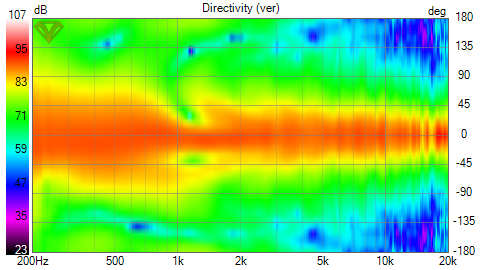

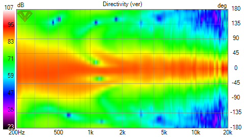

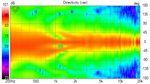

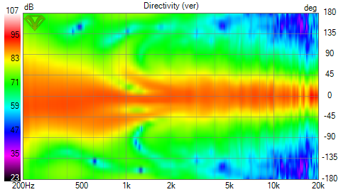

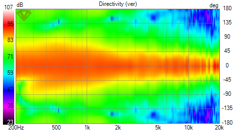

edit. Attachments are vertical polar plots from my first set, where only c-c is varied. Phase alignment changes due to increasing distance to listening spot.
1. c-c 0 wl
2. c-c 0.9 wl
3. c-c 1.2 wl
4. c-c 1.4 wl
5. c-c 1.4 wl, with phases are aligned with adjusting the mid woofer delay.
