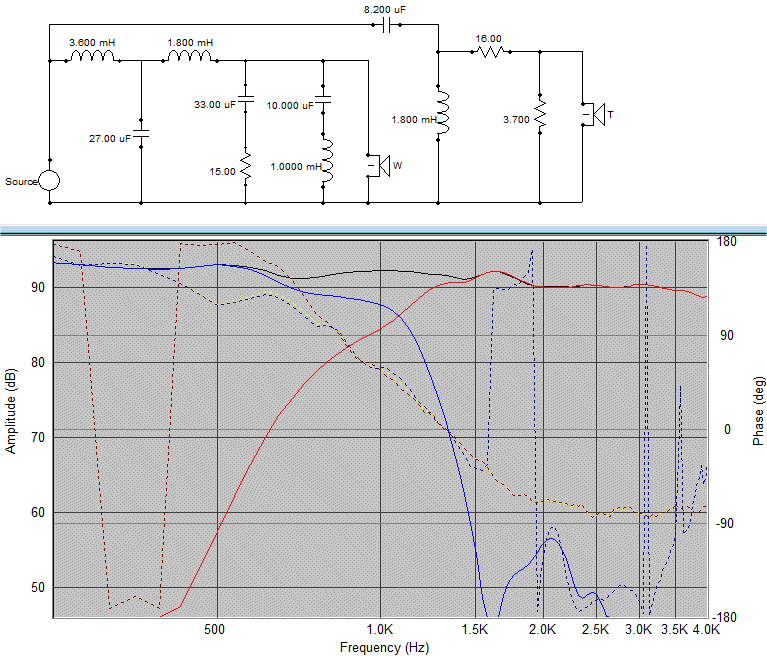

We can apply RLC in parallel to driver to damp resonance first (and achieve flat Z), then apply filters and then another RLC in parallel to whole speaker to correct for sharp peaks of the total output in the same region if they exist. In latter case it will not impact the relative phase shift between drivers (whether it was or wasn't corrected two steps before). As you correctly pointed out the negative effect would be impedance dip as it will "overcorrect" the impedance.
To avoid usage of second RLC filter we may revise our driver choice instead. Sharp response peaks may be the sign of other problems caused by particular design. Use parallel RLC filter in series with the whole speaker to compensate for rather wide "bumps". The latter means losses, so I'd go for re-selecting speakers.
By flattening Z of tweeter in the first place we will also flatten peaks in its response near Fr. Any sharp peaks then would rather be expected from LF driver so it should be carefully chosen to have smooth roll-off towards HF.

Of course, but the way you worded your post suggested that you believe that correcting the impedance peak of the driver is what was reducing distortion, however its only doing so by reducing the output at that frequency to get rid of the peak in the frequency response - you would see the exact same distortion reduction if you applied a line level parametric EQ to do the correction. (Although only in the case of an active crossover where you can isolate the individual driver)Thanks for reminder about THD associated risks here, still they are also very dependent of power level applied and achieved linearity of the particular driver that is proportional to its construction excellence.
Since we presumably want a speaker with a flat frequency response without peaks then we will be correcting any peaks one way or another, and all methods will cause the same distortion reduction near the resonance frequency of the driver because all will reduce the amplitude by the same amount.
You've apparently misunderstood me, what I mean is above the resonance frequency of the driver but below the onset of cone breakup (eg within the piston operation range of the driver) the distortion is almost entirely caused by motor non-linearity with no contribution from the suspension.But isn't it the HF driver's diameter that defines F at which it transitions to pistonic motion and not the Fr?
Below resonance the suspension contributes to distortion and above the cone breakup region the linearity of the cone material itself (since it is bending) contributes to distortion.
So above the fundamental mechanical resonance and below cone breakup onset is generally the most linear region for a driver.
But we do care about the drivers fundamental resonance - but only what shows up in the acoustic response. What we don't care about is whether the impedance curve is flat or not. We hear the acoustic response, we don't hear the impedance curve.I'ts like saying let us don't care about driver's resonance and associated impedance "bump", we can correct it when filters are already applied.
The impedance curve is an internal intricacy within the "black box" that is the completed speaker design. Sometimes the crossover design might be more straight forward and convenient if we add components that flatten the impedance seen by the rest of the crossover.
However sometimes trying to flatten the impedance curve can lead to a more complex design with more components to achieve almost exactly the same result that could be achieved with fewer components by simply altering some of the other component values and "working with" the impedance curve instead of trying to flatten it.
It all depends on the situation. The suggestion that flattening the impedance curve is always the right thing to do is simply wrong. What matters at the end of the day is the acoustic response that comes out of the speaker - how you achieve it doesn't matter. Anything that you do in the network to achieve the target acoustic amplitude and phase response from each driver is fair game, provided the amplifier can drive the load.

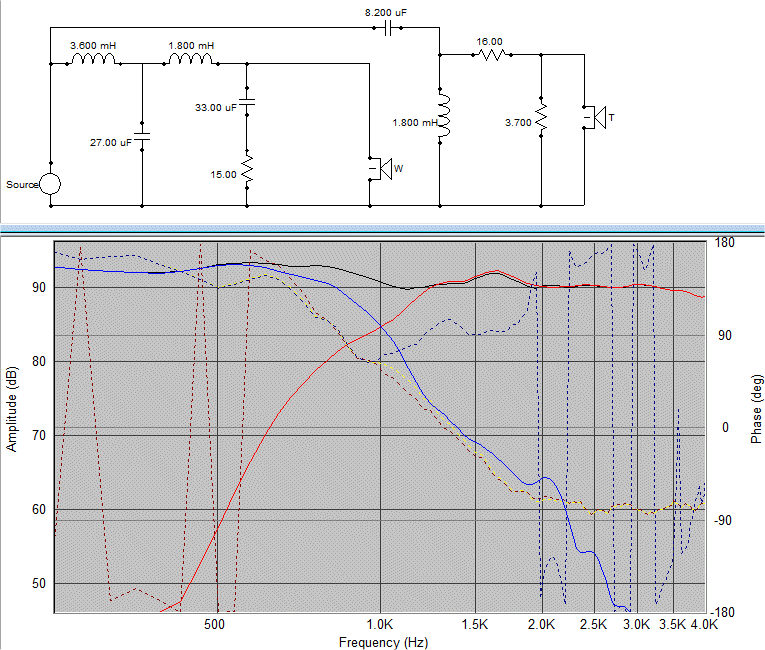

AllenB already answered this point - the only resonance that the RLC compensator is "damping" when aiming for a flat impedance curve is the increased Qt caused by the series impedance of the crossover components around the resonance frequency. If you adjust the RLC to achieve a flat impedance curve you are simply returning to the "natural" damping of the driver when driven directly by a voltage source.We can apply RLC in parallel to driver to damp resonance first (and achieve flat Z),
That may or may not result in a flat acoustic frequency response. If the drivers natural Qt (or Qtc in a closed box like a midrange enclosure) is well above 0.7 then you can still easily have a peak in the acoustic response despite a flat impedance curve. Since we hear the acoustic response not the impedance curve, getting the acoustic response flat is what matters.
What I was trying to describe is that in some instances you can use an RLC compensator to "overcompensate" for the impedance curve to correct the acoustic response - in effect it becomes like the notch part of a Linkwitz transform. The peak in the acoustic response will have a centre frequency, Q, and amplitude which with the correct values of RLC can be corrected. What happens to the impedance curve to do this doesn't really matter.
A couple of points here - the first is that I wasn't referring to any other peaks elsewhere in the drivers frequency range - I was purely speaking about its fundamental resonance, which with enclosed midrange drivers can sometimes be well above Qt 0.7.then apply filters and then another RLC in parallel to whole speaker to correct for sharp peaks of the total output in the same region if they exist. In latter case it will not impact the relative phase shift between drivers (whether it was or wasn't corrected two steps before).
In the case of peaks elsewhere in the response which are due to a peak in the response of an individual driver your suggestion to fix it by applying correction before the crossover to somehow maintain relative phase tracking between the two drivers is very misguided.
Peaks in the response of one driver that occur in the overlap region between two drivers (such as the cone breakup resonance of a woofer just above its low pass frequency) cause a loss of relative phase tracking between the two drivers, and this cannot be fixed by applying EQ before the crossover.
You might be able to eliminate the amplitude peak as measured on one particular axis, but it will not correct either the on axis phase response, (the summed response of two drivers is not minimum phase in nearly all crossover types) nor the relative phase tracking between the two drivers, and the amplitude correction will be wrong as you go off axis as well, particularly the vertical axis.
The correct way to fix the problem is to correct the peak in the response of the individual driver in its section of the crossover, for example an RLC notch. This will improve the phase tracking between the two drivers, flatten the summed on axis response, and also improve the response off axis.
This is where you have misunderstood me 🙂 I'm not suggesting that RLC before filter would change relative phase - quite the opposite. What I was saying is that it can work as a filter to compensate for peaks if they exist after relative phase correction by notches/Zobels are done in parallel with drivers. Most probably there won't be any left.
That's exactly first half of what my proposed method is about 🙂
Thanks for overall clearance to a much better degree than I could do it. I believe the controversy level in this thread will be minimized further on.
