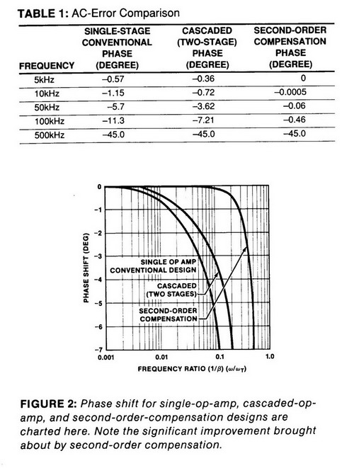

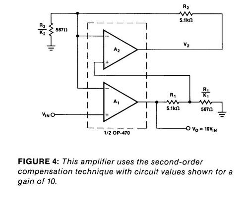

I read this app note from Analog Device, the number is AN-107, title "Active Feedback Improves Amplifier Phase Accuracy". The "Active Feedback" here is using opamp, not like Scott Wurcer's thread.
In this app note, it shows that if we put 1 or 2 opamps in the feedback path, it can reduce phase shift dramatically, like in table 1 of the app note (from -5.7deg to -0.006deg at 50khz)
If this is the same thing with what Mr. Maynard saying, then this trick can be used to any power amp, not necessarily using JLH topology. Anyone has tried this? Does it making better sounding power amp?

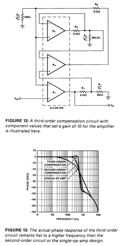

in my view 2nd order compensation is asking for problems, because it makes phase shift of close to 180deg. at high freqs. which can result in oscilation/ringing problems. To compare 1st order never shifts over 90deg. which makes more phase margin.
I think that good approach may be 2nd order pole-zero compensation. Than you should know 'natural' poles produced by amp to know where to place zero. Very hard for DIYing, needs thorougth measurements of open-loop poles. I think John Curl once mentoned making a pre-amp with 2nd order comp.

Very possible, the app note is now disappears from Analog Design's website.

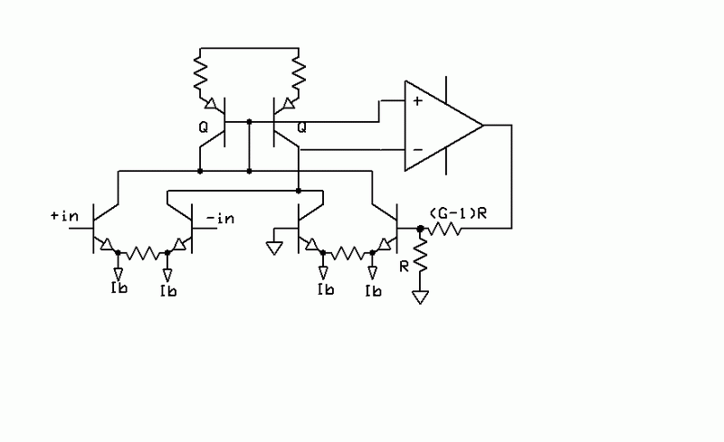

I like the idea of current amplifiers because they obviate a lot of problems inherent in loudspeakers. However, contemporary speakers are all designed to work with voltage amplifiers, so results with current amplifiers can be less than perfect.Workhorse said:

Your 1st circuits are “active compensation” amplifiers, the phase shift of the 2nd (hopefully identical op amp running at the same gain) is “inverted” by the feedback connection and subtracts from the outer op amps’ phase shift, when they are the same the phase shift is largely cancelled, these are sometimes called “0 second derivative” amplifiers – not the same as 2-pole or 2nd order compensation of a multistage amplifier
Active compensation is limited by how well the op amps match – something the manufacturers don’t tell you and which can be changed by load on the output op amp not seen by the compensating inner feedback op amp, and they are difficult to use at lower gains where 2nd poles in real op amp transfer functions limit loop stability
Active phase compensation of op amp circuits relying on matching of op amp transfer functions were explored when op amp capabilities were more limited – I don’t believe they have much utility in audio today when 10 MHz GBW is the low end of the scale for quality op amps
Even a 1 MHz 1st order roll off (closed loop gain 10x with 10 MHz GBW) has a time constant of only 159 nS and looks like ~ 50 um (0.002 inch for us US anachronists) of sound propagation path difference delay at audio frequencies
The generally accepted minimum perceptible time difference is 10 uS interaural delay with headphones; converting to phase shift 10 uS ~= 70 degrees @ 20 KHz, so I don’t get so excited about 1 degree @ 20 KHz
Smooth frequency dependent phase shifts that are common to both channels are much harder to hear ~10x
Which is a good thing for to listening multi driver dynamic loudspeakers; how likely are you to find that < 3 mm 10 uS interaural path difference “sweet spot” in your comfy chair a few meters from your speakers – how about using those pointy cones between your skull and the vise jaws to fix your head position relative to your speakers? – and for heaven’s sake don’t play more than one frequency at a time – even in the best case where the 2 tones are radiating from the same driver Doppler IM can be a bigger phase error contribution than any reasonable solid state amplifier
