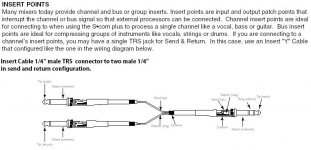

I use a condensor mic that is powered from the mixer. Now what I want to do is to put a samson s-com compressor/limiter in between the mixer and Microphone.
Will the phantom power damge the compressor? and will the power actually get to the Mic?
Cheers for the help.
pinkmouse said:
You need to use the compressor on an insert or FX send/return.
Using FX send/ret for this purpose isn't good idea.
From s-com manual:
Pinkmouse has it right. Effects always go in the send-rcv patch. I haven't seen many consols that supply phantom power that do not have send-receive patch points. That's what the instructions indicate as well.

pinkmouse said:
True, it's not ideal, but if you have no inserts it's better then using it across the outputs, which is the only other option.
if the console we're discussing here isn't equipped with a channel insert point then it is also unlikely that there would be an "on-off channel assign" switch. Also, the FX send is always placed after the channel fader, which means that you can't assign only the compressed signal to the mix out (thru the FX return) without sending the (uncompressed) original signal thru the mix buss. A better idea might be using Aux out, which is pre-fader assigned (if the console has one).

Effects always go in the FX send-FX stereo return path. Compressors always go in the channel-group-mix insert-return path.
Mike levels are not normally high enough for a limiter.
Very possibly. The blocking caps are usually electrolytic and wired to expect zero volts on the output. +48V is high and may reverse-bias the caps. Failure can be quick and costly.
No way.
Use the insert points (or FX in a pinch). That's what they are there for.
