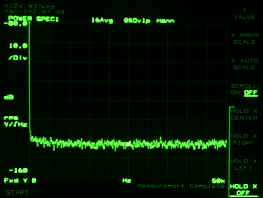

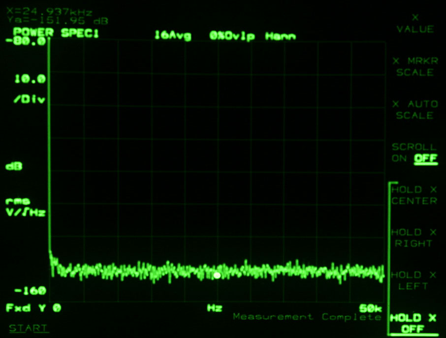

One thing to keep in mind is that the PGA23xx parts are not super low noise. They're about 10 dB noisier than the LME49720 (that granted are state-of-the-art). But it is noisier than a 100 kOhm potentiometer. I am only able to measure the difference. In actual use, I can't tell a difference. I've attached the noise plots for academic interest. The plots show the noise floor before and after the volume control with the volume control set to 0.00 dB.
