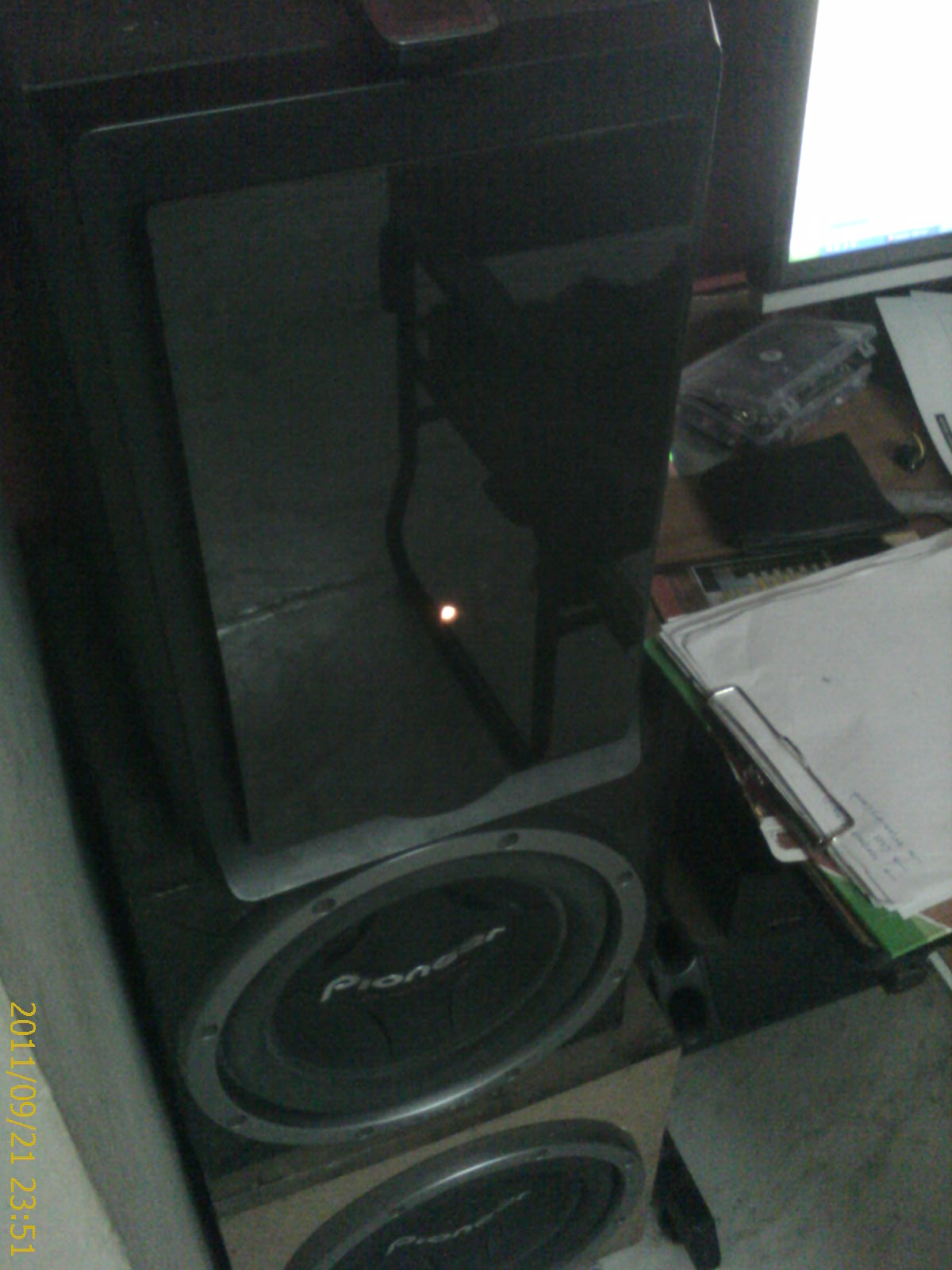

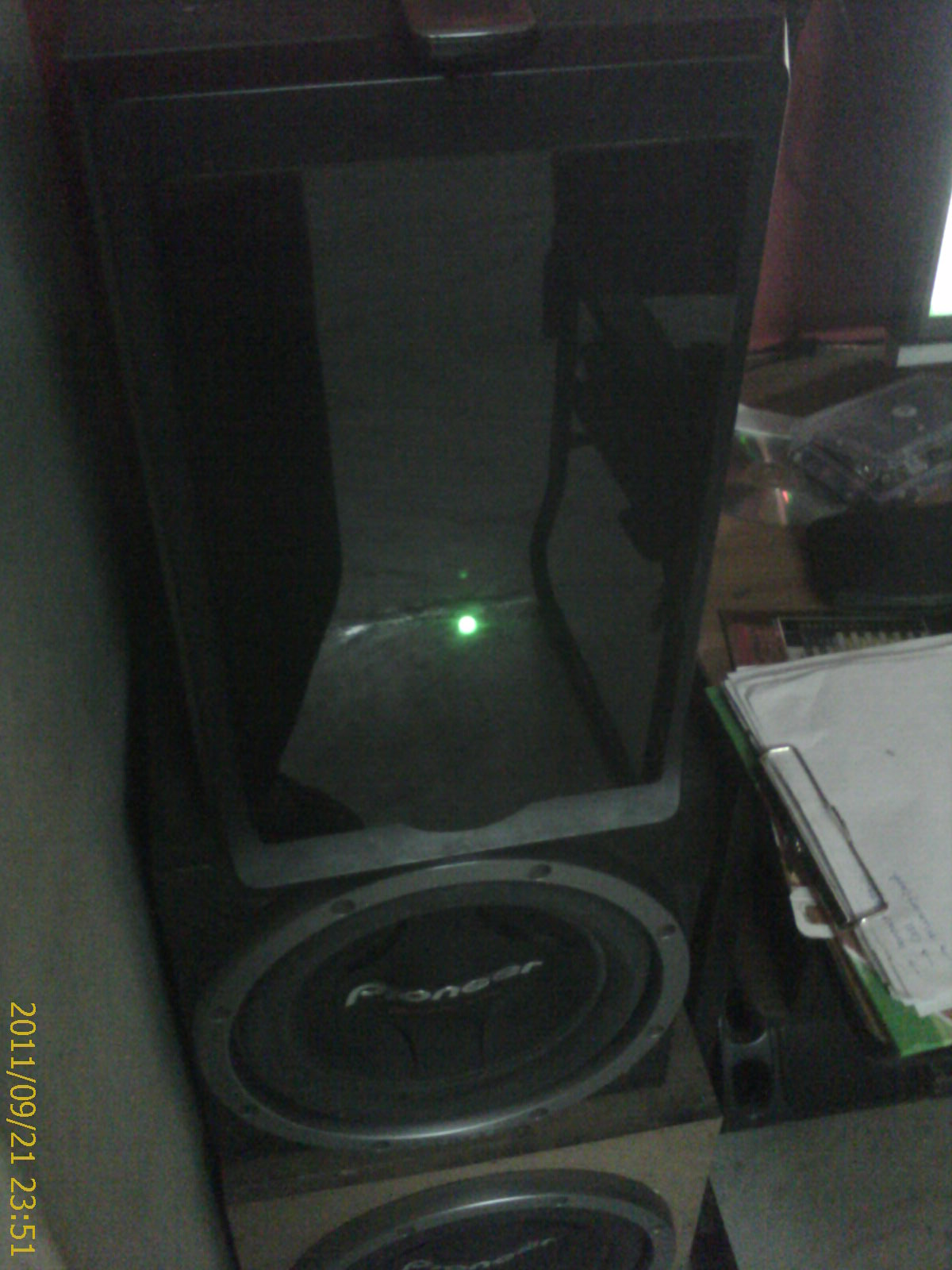

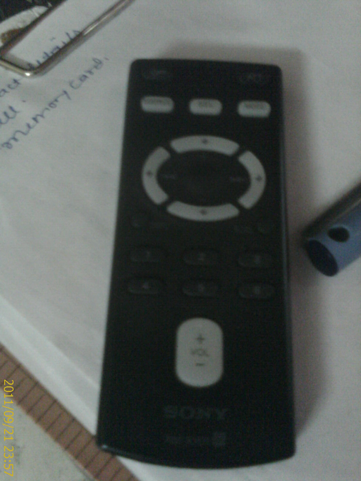

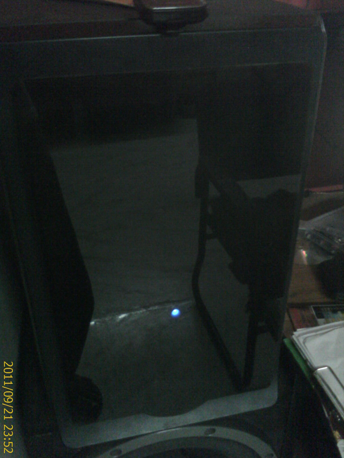

hi mkul,
thanks for your reply.
this was just a basic project to understand the chip. my final project consist of only sony remote controller with single RBG led to indicate all conditions such as stdby mode/mute mode/play mode/vol. full indication etc.
however due to circuit complexity, i have taken same +5 supply for both digi & analog. i understand the consequenses.
rotatory encoders some times misbehaves untill strictly programmed.
i don't know how to use an internal oscilator so generally i use external.
here is the final schematic.
your project is really appreciable. looks cool. do you use BASCOM also for coding.
