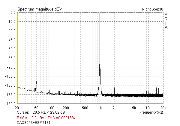

DAC8043 (or similar) in multiplying mode (see datasheet) with quality OA, eg. OPA1642, OPA1612..Results are very good (example in attachment), but uP is a must. It is far better than PGA, MAS, CS or similar..
