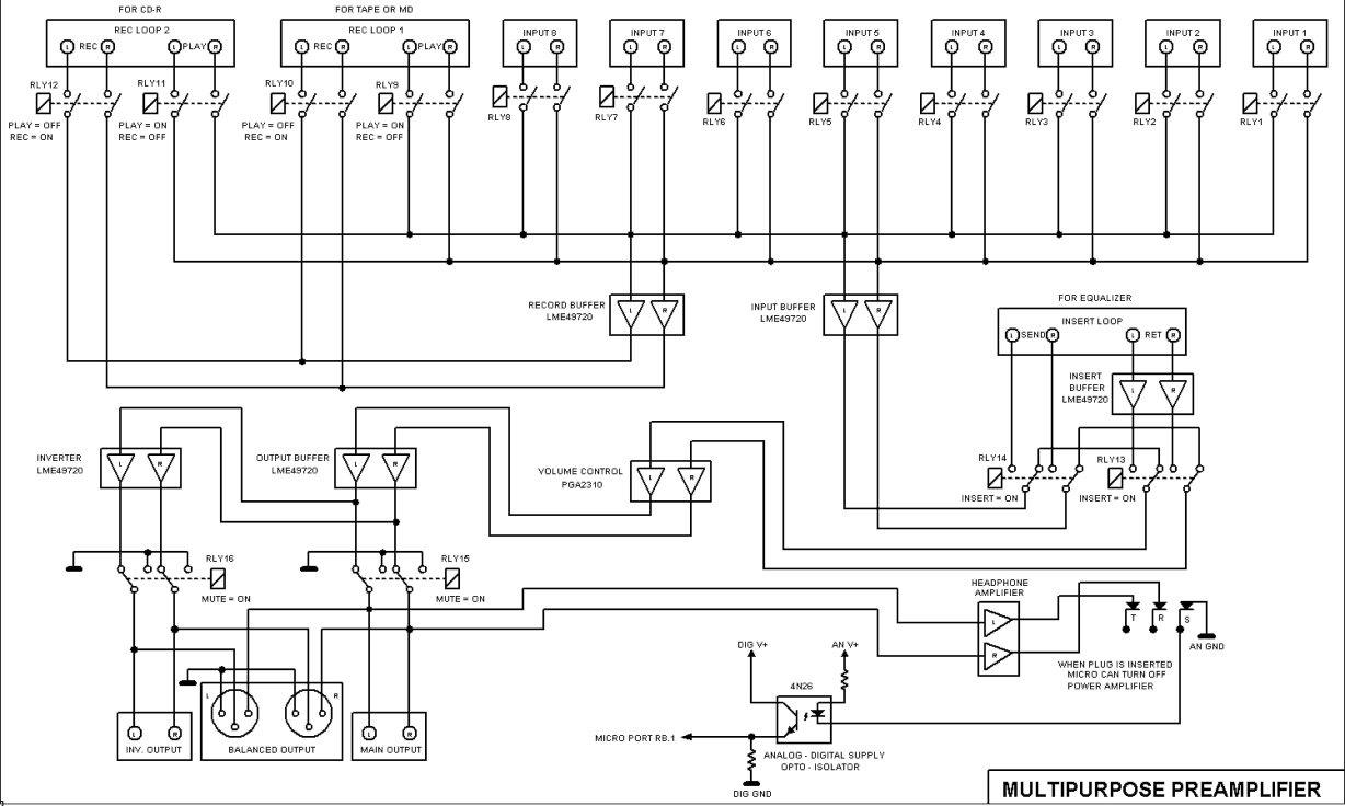

Hi Al
From those that i understand your intention is to manage the volume level of 6 channels simultaneously. A 3 way stereo electronic x-over offers 3 outputs (Low-Mid-High) per channel, so total 6 outputs.
I don't know something about this DCX, but from those you refer i can perceive that its headroom is some small. Using 3 PGA2310, you could get same volume level and more gain at the same time.
To manage just the gain of the 3 PGAs, is very simple. There is no need for a big micro like this on the current project, a 18 pin device can do the job just fine. The only external part needed is the encoder, so 2 - 3 inputs. Outputs to manage 3 PGAs are the same: CS - SDI - SCLK. The program code will be very small.
Well, tell me if you have available a PIC programmer. In this case i could post you the program in HEX file. Then you will be able to test the program on actual project and you will notify me if there is need for any correction.
Hi Fotios, i'm paying a lot of attention to this thread having a strong need to build a source selector for my amplifier. Do you sell also some pcb's or publish some pdf to etch opur ouwn boards ?
Ps. It's possible to come to Thassos this june 😉

This is my last post in this already polluted thread, and i simply publish the last and definitive upgrade on which i am working. The preamplifier will have the shape appears in the block diagram. I am already working on the upgraded program and the microcontroller used is a PIC18F45K22. The display is also changed to 2 lines X 20 characters. Of course i will provide you again with all the necessary schematics and artworks to make your own PCBs and the program of microcontroller. I will also provide you with ready made PCBs for the analog part and the control board.
I ask your patience for few days.
We meet again in a new thread
Thank you.
