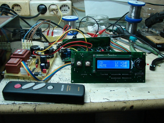

This is my last preamplifier project. I simply started an experiment with the PGA2310 that finally led me in a complete project - as usually .
A summary of its properties:

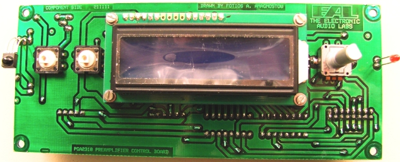

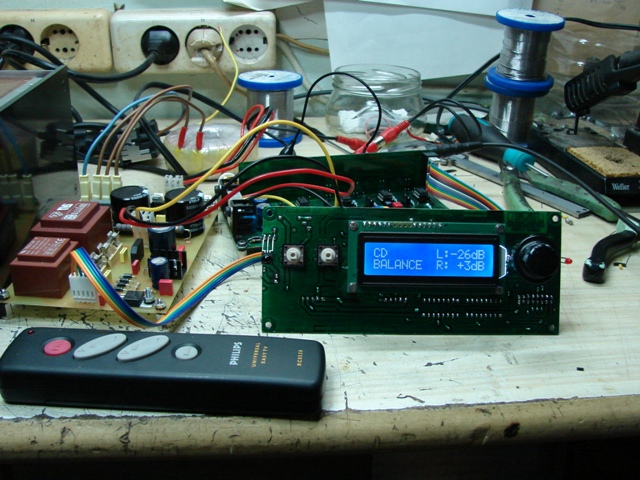

1) It can be managed either locally thru 2 push switches and a rotary encoder, or remotely from a RC5 compatible universal remote control handset. Includes 5 Inputs, 1 Main Output and 1 Record Output. Control functions are the 7 basic: a)Power On/Stand By b) Mute c)Volume increment d)Volume decrement e)Balance f)Input selection in forward sequence and g)Input selection in backward sequence. All these functions are also supported by the remote control except the Balance.

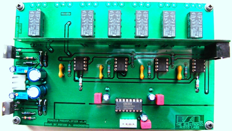

2) The analog signal process is obtained thru a PGA2310 programmable volume control IC. Voltage gain can be adjusted from -95 up to +6dB in steps of 1dB. Volume control IC is buffered from input and output devices like CD players and Power amplifiers from four LME49710 operational amplifiers configured as voltage followers.
3) Separate power supplies are used for Analog and Digital section..
4) Input selection and Output Mute functions are obtained with the use of high quality Latching relays. The Stand By function (i.e. enable – disable the analog power supply transformer) is also obtained with a powerful SPNO/10A Latching relay. Latching type relays ensure both power saving and noise immunity on audio signal as their coils are inactive for most time. A momentary voltage pulse of 15ms is enough to change the location of their contacts.
5) The whole device is managed by a PIC16F887 microcontroller. The appropriate program code has obtained with the use of the powerful Visual Programming Software FlowCode v5 of Matrix Multimedia.
For a more detailed description, schematics and an offer to you my good friends a free copy of code in hex format so you can program your PIC16F887 with any type programming device you own please here:

Here some pictures showing its functionality

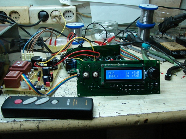

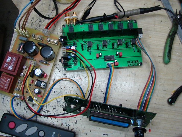

PGA2310 Line Preamplifier - Part 2
Here is a general view of project, and a very - very interesting second picture. In the last you can see the performance of preamplifier. In this DSO screen shot it is obvious the rise time of signal at the output of preamplifier. After a pass thru 3 ICs: LME49710-->PGA2310-->LME49710 the square wave rise time has increased just to 200nsec! That means bandwidth: BW = 0.34 / 200nsec = 1.7MHz with negligible overshoot. Voltage gain was "1" (or 0dB) in this measurement.

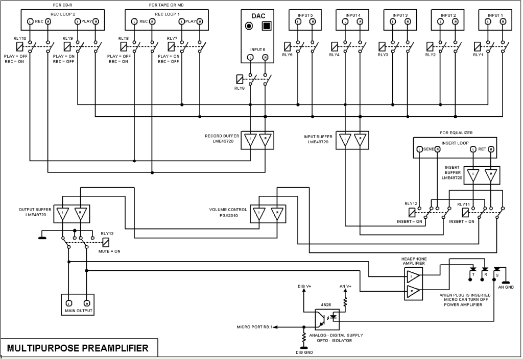

VERSION 2
Because enough people asked me for a version with common type relays instead Latching ones, i decided to design this time a multipurpose preamplifier - control unit with any possible facility.
To the present, i can show you only the block diagram to get an idea of what i have in my mind. Enough from the things included on block diagram are requests and advices of a friend from Wales who is working in recording studios and live stages. I have finished the program code today and i am in the process of drawing schematics and PCBs. I also wait to receive parts that i ordered to complette the unit.
I haven't yet decided what OPAs i will use. My main choice are the dual LME49720 or LME4562. But i have still in my mind the LME49710 which offer 125dB PSRR, instead the 120dB of 49720 - 4562.
Tell me please your opinion on this.
Thank you for your attention.
Fotios, I would put 47 or 50 ohm resistors in series with all your op amp outputs just to make sure if you do end up driving a capacitive load, you won't have an oscillation problem. Nice to see that you have buffered your rec loop by the way!
Opamp choices are ok in my view. Look at the PSRR at HF as well btw -so 50 or 100KHz.
Nice overall design and very flexible in my view. Look forward to seeing the finished result!
Thanks Andrew for information, i will put these resistors. I have in my stock 2 - 3 hundreds of 49.9Ω / 0.6W Vishay SFERNICE. Looking at your X-Ultra, i saw that you use DALE resistors. I don't know if these make some difference in sound. To be sincere, i didn't any audition test! Just only measurements with DSO. Fortunately there is a guy who made this project and informed me that, in audition test, -95dB attenuation is quite extreme for PGA2310. He told me that -60dB max attenuation is more than enough.
Well, i already had in my plans to make more flexible the control unit taking into account demands of some members. To obtain it, I have to upgrade the mcu from P16Fxxxx to P18Fxxxx. The current mcu that i use is a PIC16F887 and i spent a 90% of its small program memory (8192 words capacity) so far. Its software stack level has also just 8 level depth.
10 days ago, i received some samples of new PICs from "mom" Microchip in which were included two tremendous new micros. The P16F1827 and the P18F45K22. With the second i can do everything i want (big program memory of 16384 words and 31-level stack) and much more. It offers possibility of capacitive touch on many inputs, so no need for traditional push-button switches.
Currently i am working with P16F1827 to build my own remote control handset compatible with the last upgrade that i have in my plans. I will show the block diagram in the next post.

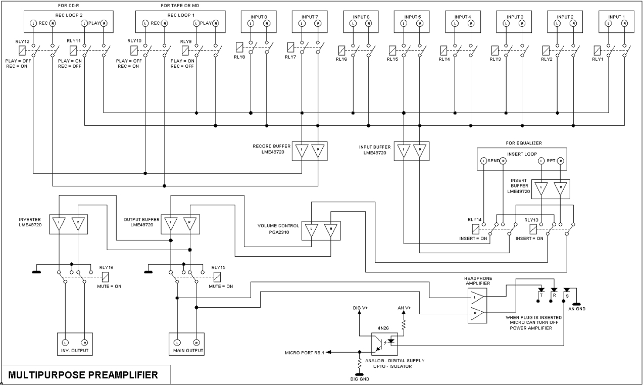

Last upgrade
In this upgrade I will include:
1) New powerfull PIC18F45K22 MCU.
2) Replacement of 2 X 16 characters display with a 2 X 20. This will give possibility of printing fractional numbers, e.g. -37.5dB, -22.0dB etc.
3) Additional menu functions for the user:
3.a) Selection between 1dB and 0.5dB step for PGA2310
3.b) Selection of max / min attenuation-amplification level of PGA2310
3.c) Naming of inputs
3.d) Naming of recording devices
4) All main functions will be remotely controlled with the new (12 to 16 buttons) remote control handset.
And much more
Here the new block diagram
