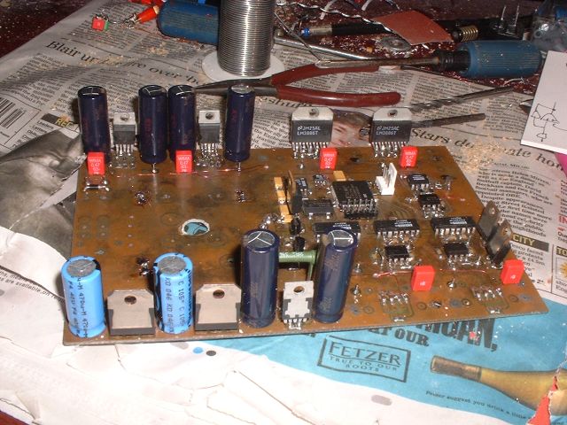

Hello Everyone,
I'm building a 5.1 channel amp for my PC. The PCB contains five TDA2050s for the main channels, two LM3886s for a dual VC sub and three PGA2310 chips for volume control, as well as the control logic to generate SPI commands (from an normal up/down switch).
Connecting this lot together on a double sided PCB is a pain but I've decided on three power planes: digital ground, analogue power ground (for localised resovoir caps) and signal ground. All three planes will be connected with a star.
My question: should the analogue ground on the PGA2310 chips connect to the signal ground or power ground?
Attached is a work-in-progress pic of the Mark1 version. It worked by there was a noticible hum on some outputs. I traced the cause to the power electrolytics sharing a ground plane with the signals. I want to do it right this time!

The PGA2310 requires a digital ground which is the return for the +5V logic supply and this should be connected to your digital ground. Also, each one of the analog signals have a ground reference which I believe is labelled AGND. These should be the same potential as the signal references which are being amplified. It will probably be your signal ground.
I would also like to tell you about the PGA4311 which is a four channel version of the PGA2310, however, the analog section runs from +/- 5V and not +/-15V.
I can tell you from experience that these chips are rather nice. They work well as long as the control signal is good. It is not an SPI signal rather a data stream which is shifted in more like a serial to parallel shift register with a load. Once you have the signal timing correct, which isn't too difficult. They are rather sweet and can control volume over a large range or levels from -95.5dB to +31.5db(which usually is too loud any way). Good Luck and keep us informed of the progress.

The Analog and Digital grounds should be connected at a single
point, as stated in the Datasheet, p. 11.

My current PCB has the PGA2310 AGND connection going to my analogue power ground. I started having second thoughts about this and now I'm going with Beanz suggestion of connecting it to signal ground on my redesigned board. I don't want the voltage spikes caused by the electrolytic charging currents from putting 100Hz hum into the volume chips so signal ground it is. I'll let you know the result!
