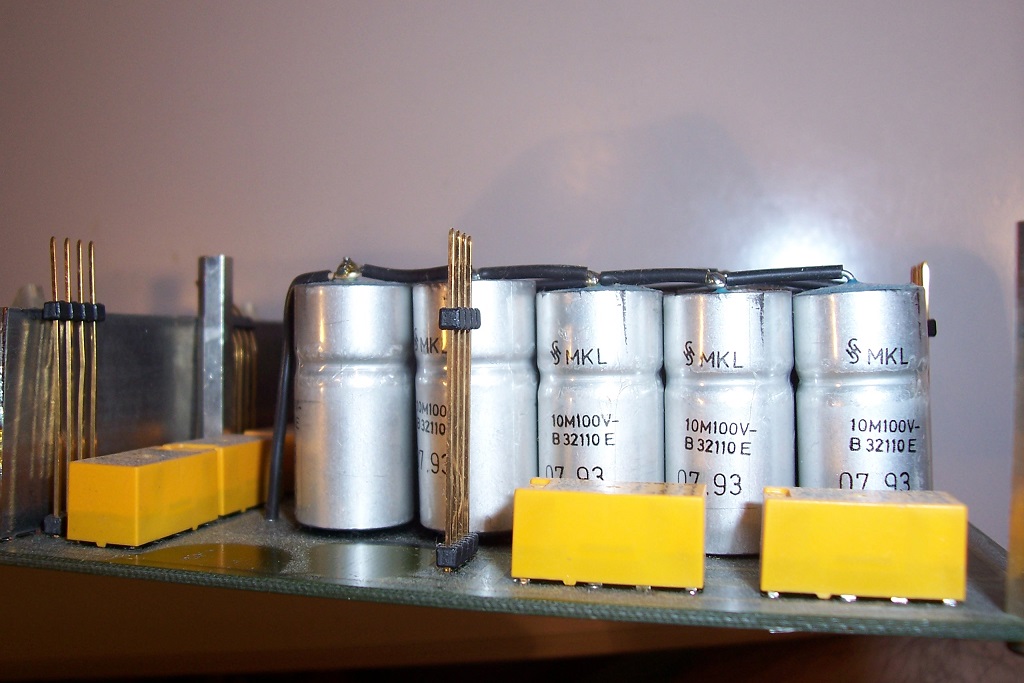

I would be slightly less affirmative about that: for example, take the MKL series, developed in the late fifties or early sixties in what was then the BRD (Western Germany, RFA) by Siemens.For all the obvious faults in a State Capitalist/command control system, the profit motive was irrelevant, so production cost didn't have the importance of the classic western Capitalist mentality. Where do you see the expensive aluminium shell type construction in even the most expensive western caps - you don't.
The construction is absolutely similar: an aluminum tube sealed by epoxy resin:

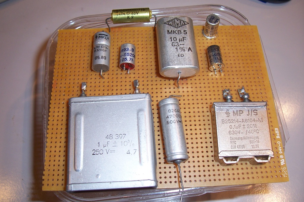

The performance is comparable to PETP (=mediocre), but there are much better examples of "decadent capitalistic" products:
Top left, another Siemens MKL example, followed by a 147nF polycarbonate from LCC, completely hermetic, 2% tolerance, then (below) a 5520pF polystyrene again made by Siemens in an aluminum case sealed with resin, then a Wima of comparable construction but larger, and then two examples of completely hermetic PS caps in transitor-like case also made by Siemens.
Bottom left, a PIO made by MBLE (subsidiary of Philips), followed by a 47nF metallized paper also MBLE, and finally a 100nF/630V metallized paper made by Siemens.
These are just examples, and you could find many others, both from the western and eastern blocks, and also from non-aligned origins: politics have little to do with the quality of products, and crap was produced everywhere, including both sides of the iron curtain....

the performance is not mediocre. Apart from one actual user, all the other detractors of these caps have a theoretical dislike of them.
50s & 60s - I was talking about present day production of caps produced in Germany, USA.

PETP is a cheap, general purpose dielectric. As soon as you need some quality, like stability, dielectric absorption, dielectric losses, stability vs. frequency, etc, you have to turn to other alternatives: PC, PP, PS, etc.
The metal sleeve construction had been adopted mostly to slow the ingress of humidity. Nowadays, because the fabrication techniques are much more advanced, such an expedient is not necessary anymore.
For extremely critical applications, completely hermetic models still exist (I have shown a few examples), but they are extremely expensive and use better dielectrics than PETP.
That said, for non-critical applications like coupling, bypassing, etc, mylar caps work perfectly well.
