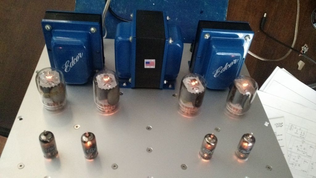

I haven't tried a Hammond style chassis for an amp this big, but my guess is that it will be OK if the transformers are located near the edges of the top.
One amp was made on an aluminum plate with a wood base, one was given to my boss without a chassis, and the third is being built into a large PC case with the PC and a few other goodies......it's not done yet. That one is multi purpose. It will play music from the internal hard drives, run a recording studio style DAW (Digital Audio Workstation) and has inputs for a guitar and a MIDI keyboard. A phono stage is in the works.
All three were built according to the 125 WPC mods that I outlined in the original thread. Yeah, a PC with 125WPC for its internal sound card.........

Those chassis look nice. I keep on looking at eBay options for this. Going by Pete's top down layout view, I think there's scope for placing the trannies right at the edge.
T
Plate is 2.5mm. The countersinks are all for #8 screws. The 2 for the mosfets should have been smaller. I'd use #6 or even #4 I I did it again as the holes in the FETs are small. I used Front Panel Express. Pricey but came out really nice.

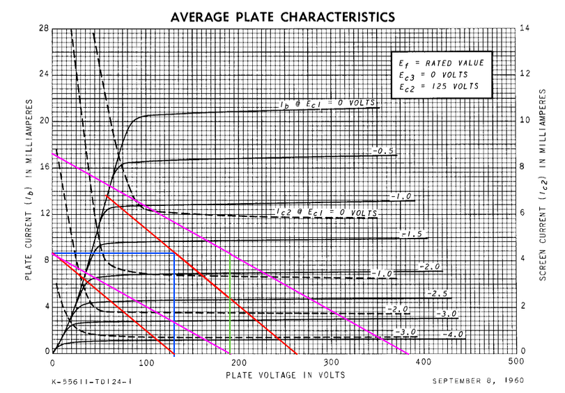

voltage gain of the input differential = 1/2(gm x Rl)
gm can be seen on datasheets taking into account g1 and g2 voltages...
the 100 ohms is added to the gm...say 50 ohms per tube...
open loop gain is high, then the global feedback lowers the overall gain,
and calculation for this is over my head for now....
perhaps the tube gurus can chime in...
