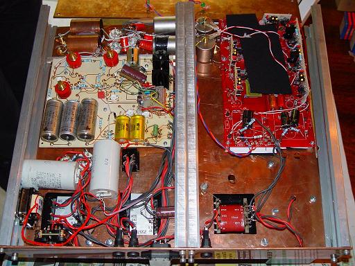

wazzup said:What are those white cylinders on the left, in the dac? Coils?
Foil capacitors

Guido Tent said:
Foil capacitors
Ciao
And what brand of foil caps? I`m quite interested in those... They look ...musical 🙂
I will ask him then, whenever I have another question for him. I will be building my Mp dac, soon as I finished my cd player. There will be a lot of questions, on THAT dac 😉
Ciao
Ciao
just asked Peter:
Arcotronics motor run caps.
Ciao

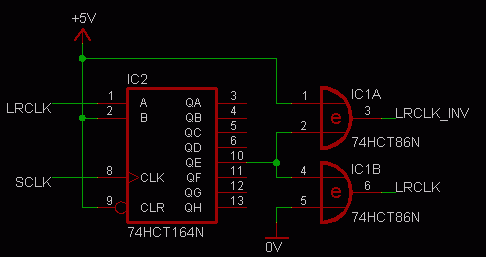

Hi; This all sounds very interesting OS vs Non OS. I have question, how do you seperate the L/R channel signals. Because this is normally done by the dig filter isn't it. Is there a schematic of one I could look at to see how this is done.
WTS said:Hi; This all sounds very interesting OS vs Non OS. I have question, how do you seperate the L/R channel signals. Because this is normally done by the dig filter isn't it. Is there a schematic of one I could look at to see how this is done.
If the interchannel delay is of no concern to you then this circuit should do. I say should as I haven't built it because the delay does bother me.
The LRCLK is delayed in order to align the MSB of the 16bit data with that of the 20bit input register of the PCM63 and LRCLK to one channel is inverted. Serial data is sent to both channels.
The circuit is intended to work with the YM3623 or mode 5 of the CS8412.
