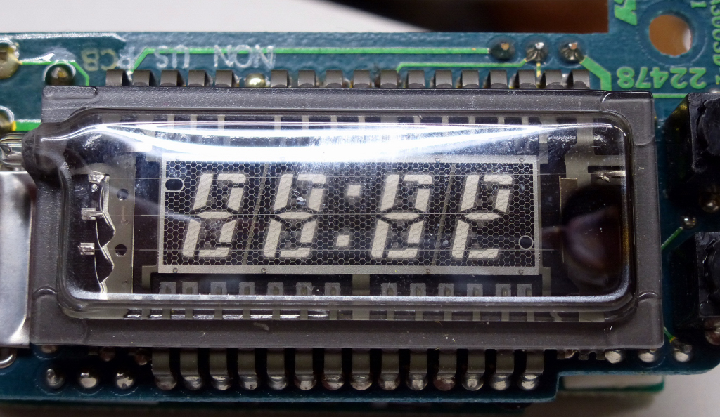

My experiments with the cheap clock display have been done with all (or most of them, I might have missed a few) plates wired in parallel. I only played with it for an hour or so before losing interest.

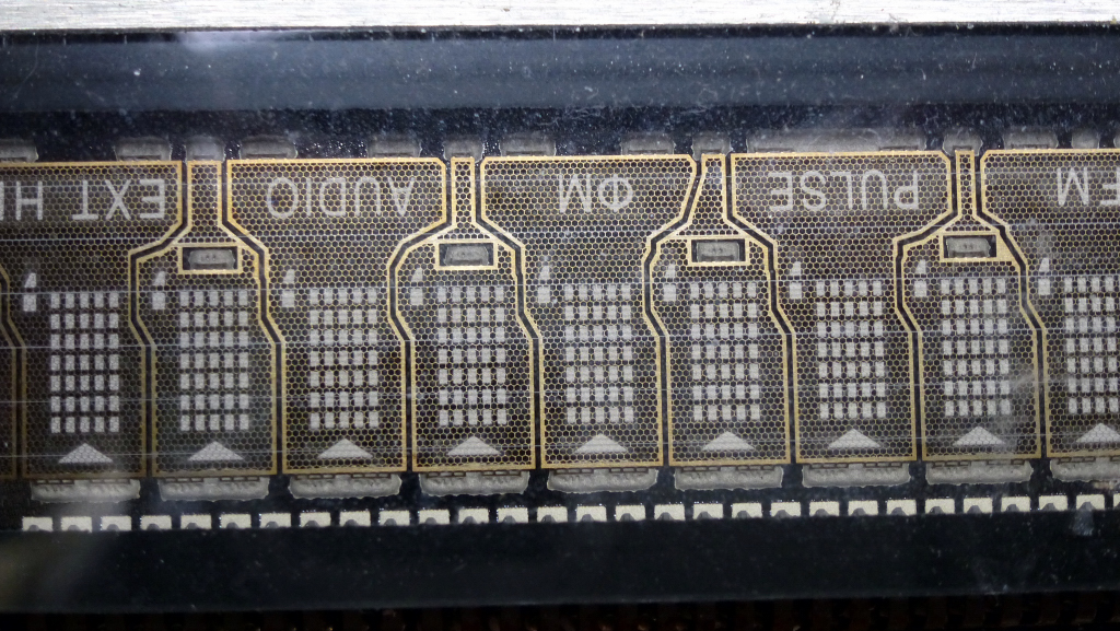

The "plate" in a typical small VFD is segmented. There are several "plates," one for each segment in the display. In a small VFD the grid is one piece that goes between the filament wires and the array of plates. A positive voltage is applied to the grid to attract electrons from the undersized filaments and toward the plates. Each plate is controlled, zero or a negative voltage turns the segment off, and a positive voltage turns it on. Sometimes the grid voltage can be varied (or pulse width modulated) to control the brightness of the entire display.
The grid voltage to plate current relationship has no meaning to the use of the VFD, so it's not even a parameter that is tested during the design or manufacture of a VFD. Display brightness is the major design factor.
The Korg NuTube has one large plate for each triode, with a grid structure optimized for some degree of linearity. The plate could be coated, which may or may not affect linearity, or at least a cool logo graphic could be printed over a small area. The photo posted on the early release data that I have shows a small phosphor patch in the center of each plate structure. No idea if this made it to production. There is only a single filament wire running across the entire "tube" tapped in the center to allow separate operation of each triode. The filament is rated for 0.7 volts and 17 mA. Clearly not a huge amount of electron emission. The clock I have has 3 filament wires, and the HP display has 6.
Larger VFD's have a segmented grid structure in addition to the plate. This allows for multiplexing of complex displays. Both grid and plate must be positive for a segment to light up.
Enclosed are two pictures. The first is the $2 surplus clock that I have. The grid is ole piece of perforated metal. The second is a piece of a large Hewlett Packard VFD in a $20K RF signal generator. You can see that each digit of the display has a separate grid, and each tiny segment of each digit is a separate plate. There are several TI SN75518 VFD display driver chips on the board to handle the display multiplexing.
