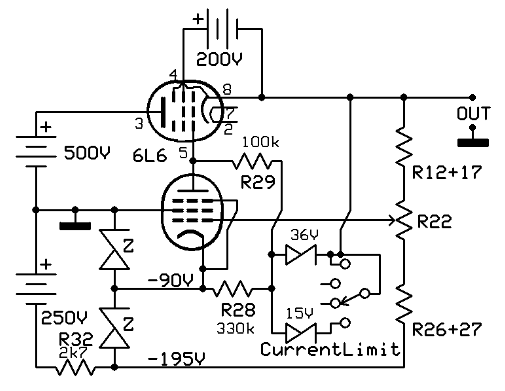

I recently built Pete Millett's hv bench power supply ( High-voltage bench supply ) and am having some trouble getting B+ voltage. I have filament voltage and negative bias voltage, but had -
6v on the B+ out. After tracing my work and comparing it to the schematic a few times, I'm 99% sure that my wiring is correct.
I contacted Mr. Millett directly for advice on what I may have done wrong. He responded promptly and told me that he didn't see how the circuit could work as drawn, as the error amp plate (V5 pin 7) should be connected to B+. He suggested I connect the 330k resistor in the schematic at the current limit circuit from pin 7 to B+. This gave me +.4v and some current meter swing when playing with the 100k pot, but nothing more. Unfortunately, he said he may have found the problem after he uploaded the pictures to the web page and corrected it later, however that was 15 years ago and he no longer has the unit.
I'm curious if anyone here has built this supply and run into a similar problem? How did you correct it? I'm learning tube circuit design, but I am in no way experienced enough at the moment to figure out why this supply isn't working without help, so if anyone has any ideas on what could cause my issue (assuming it is a design flaw and not just a wiring error on my part), would anyone be willing to take a look at the schematic in the link above and make any suggestions? I spent months building this and I'm not quite ready to give up on it, but I'll admit I'm getting close.

I don't think connecting the R28 (330k) to the B+ is the solution.
Like that the zeners of the current limit are allways conducting in the opposite direction (only 0,6V) making them useless.
Could it be that the screen supply doen't function ?
Mona
Tubes are depletion mode devises, no start-up problem.
The R28 (330k) provide a bias current for the current limit zeners.
With the output to low the control tube is blocked and the Vg1k of the pass tube is equal to the selected zener.
Depending on the load on the output the voltage goes up until the current is the maximum possible with the chosen -Vg1k. If the output voltage try to go to high the control tube wakes up and start pulling the g1 of the pass tube down.
Now with R28 to a positive voltage, all zeners give a +0,6V = Vg1k at start-up and the pass tube will allways pull with maximum possible current on the load.
So again, is the 200V present on the pass tubes screens ?
Mona

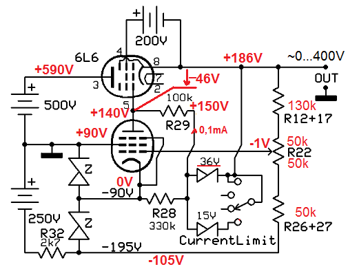

As I wrote before, connecting the 330k to a positive voltage is no good idea.The zeners in the current limit get biased in the wrong way.
There is no need for a positive voltage.
Only the values of R12 and R27 are odd, not the values to get 0...400V out with the 100k potmeter.
Here the voltages I expect in respect to the cathode of the control tube.
Mona

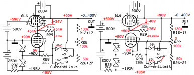

Yes but how does that look when B+ is dialed down to 0V?
With the 36V zener for the max current limit there is a problem, there isn't enough negative voltage to block the pass tube(s).
With the 15V limiter all is well if there is enough load.
If there isn't the circuit fails and the output remains to high.
Problems of a circuit with an active pull-up and a passive pull-down.
Mona
