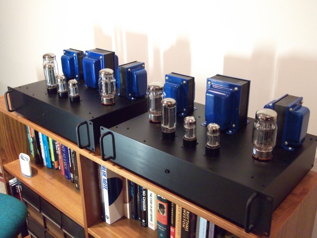

I really like my Millett Uniamps. They have several hundred hours of flawless operation on them now, impressing everyone who has listened. They run cool and are as quiet as a graveyard. I'm so pleased with the performance, I haven't had the yen to build anything else since the day I first turned them on.

Thank you for the compliments. I'm very proud of this project, especially how good it sounds. I currently have some PrimaLuna tube gear that I use as a reference. The PL products are very good performers. The Millett Uniamps compare favorably except when it comes to imaging and soundstage; things the PL gear are superb at. But the comparison is not really fair considering the respective costs. I have also compared the Uniamps to a Dynaco kit built by a friend. The Uniamps sounded better in all respects.
I don't really have a tally on the cost. I didn't keep track and never do . Of course, monobloc construction adds to the cost. I used Edcor xfmrs; nothing exotic. Decent parts on the PCB but no "boutique" caps or resistors. Tubes are SED KT88 and E-H. The chassis is a standard 19" rack case which I always use for my projects. Plenty of room for the xfmrs, PCB and tubes.
I wanted more room in my layout as opposed to Pete's prototype as shown on his website. My amps run cool and very, very quiet.
Pete's boards are top-shelf. I also built his "Engineers Amp" and it also worked well right off the start. However, the Uniamps are a big leap ahead in performance; far more than I expected actually.
Taking the usual care in construction, and using Pete's excellent documentation, you should have no trouble building a pair of fine-sounding amps. Like I said, I haven't felt like building anything else, feeling these would be very hard to top. Good luck with your build!

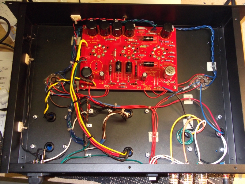

layout and wiring
Neonthecat,
I'm collecting my parts to build these amp. This will be my first amp build and I too thought the design was easier. I was wondering if you had a picture of the bottom of your amps? I would like to see how you ran the wires. As you mentioned you didn't have any noise problems.
I've seen several different builds including Pete's layout. Gio's uniamp build in another forum looked nice. lI already have the James output transformers and have contacted them for a quote on the PT and chokes. I will order them when I go back on holiday to the U.S. Wire transfers from China can be a bit problematic.

...I was wondering if you had a picture of the bottom of your amps? ...
Sure. Nothing fancy here. Lot's of room in the chassis.
Thanks, I was just curious about the heater wiring between the KT88 and overall wiring layout. I understand the transformer orientation and heater wiring from MJ books.
Just curious why you split the power tubes up? Did you do it because you like the look better? I'm just trying to learn. I only want to cut my chassis holes once.
I just wanted it to look symmetrical. And there is lots of space around the KT 88's for cooling.
