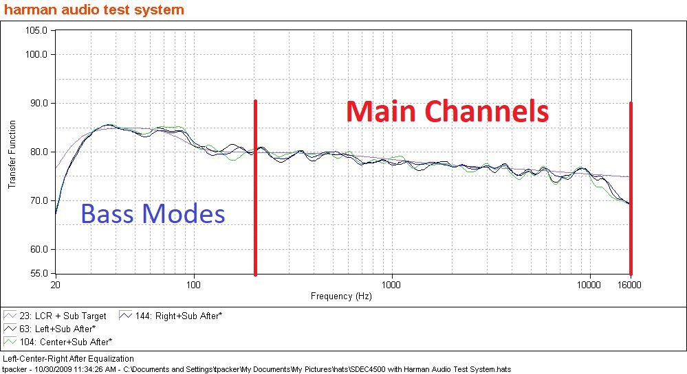

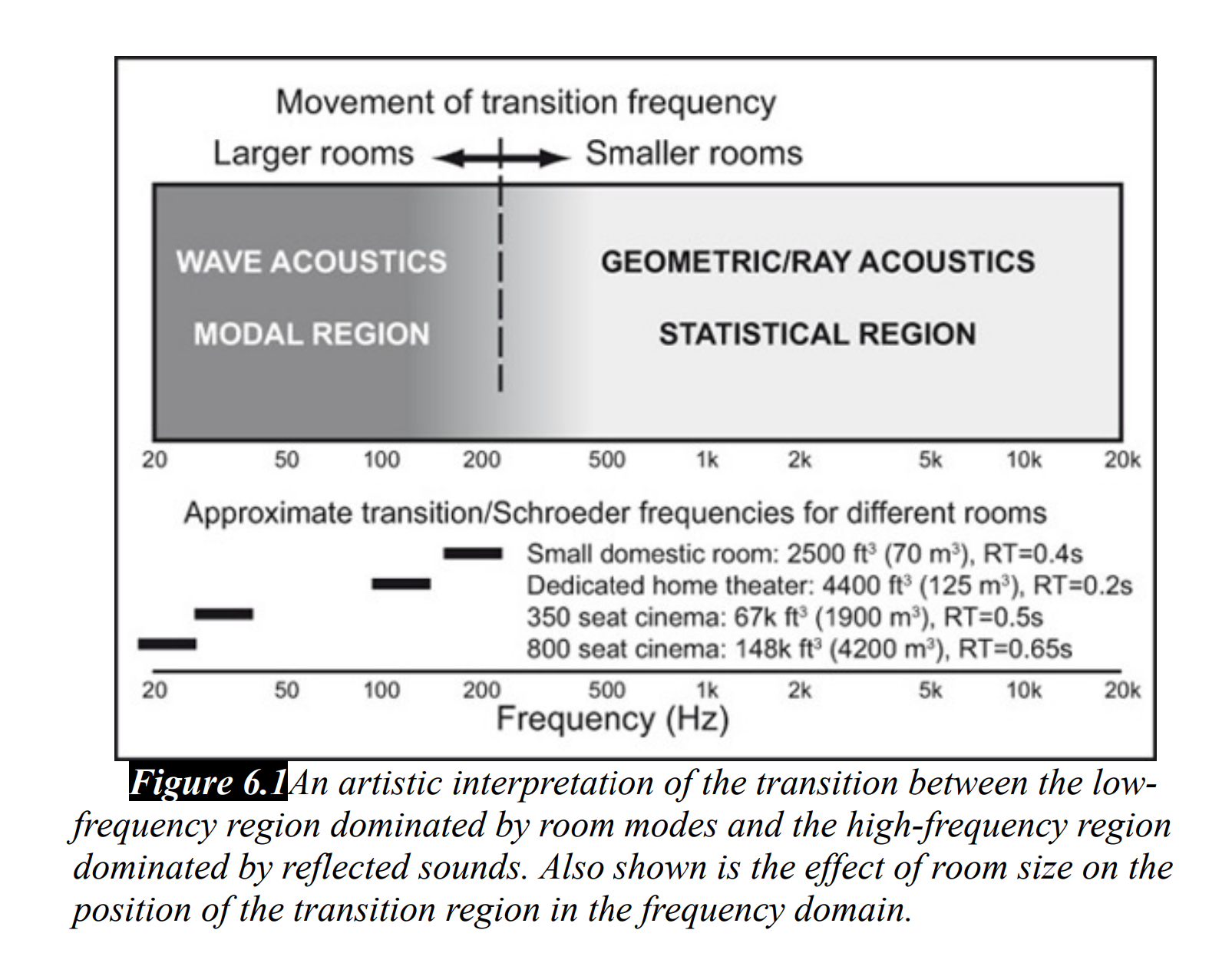

Room modes dominate frequencies below 200Hz, or so. Adult humans can't hear above 15kHz, maybe less. Consequently, I equalize the main channels between 200Hz and 15kHz using a Harman preferred curve then adding small tweeks on top of that to compensate for my personal hearing deficiencies.
To me, it doesn't make sense to design main channels with the intention of reproducing low frequencies. Not as a goal. Though they may reach down into lower frequencies as a result of other design choices such as building arrays.

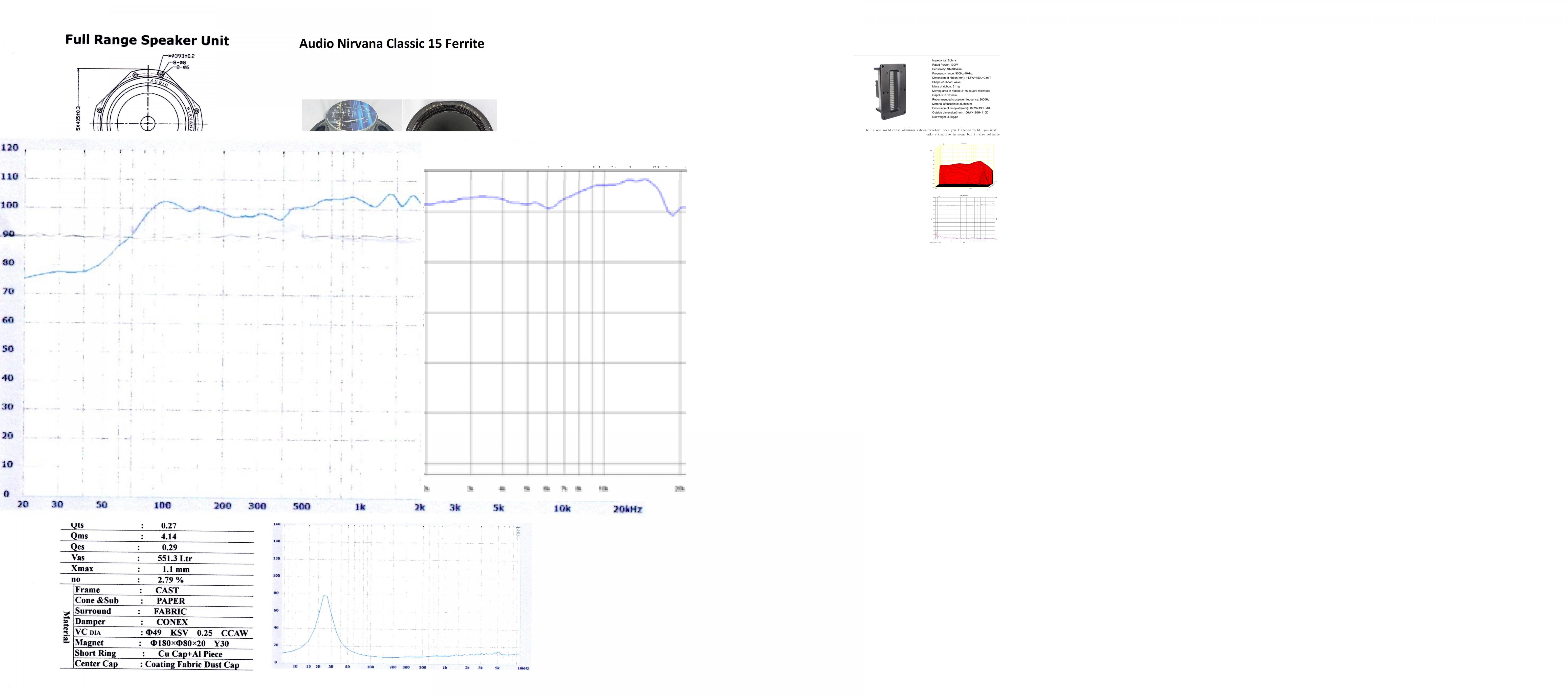

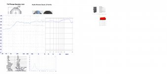

For myself, the issue is HF beaming...I currently have a vintage 12 " full-ranger in a modified form.
I'm contemplating a AN 15 classic ferrite and an Aurum Cantus G1 working together...the big fifteen full-range, with the inevitable falling HF performance, mated to the ultra efficient G1 ribbon.
No horns, no exotic baffles, alignments...straight forward, an Ampslab Synergy two-way, 2K crossover, dual amp per , to correct for the phasing.
My current FR is just fine, as long as I'm sitting exactly inline with the voice-coil...about knee-high.

Hey Richard,
That's close to what I have at the moment. Works great. I have the 15" AN fertile (non classic" with a Aurum Cantus. What works well, if you could device a mechanism that points the tweeter towards yourself or (Toe in whole speaker and have a rear firing tweeter ( cheaper stuff)... I use a Tangband micro tweeter.
