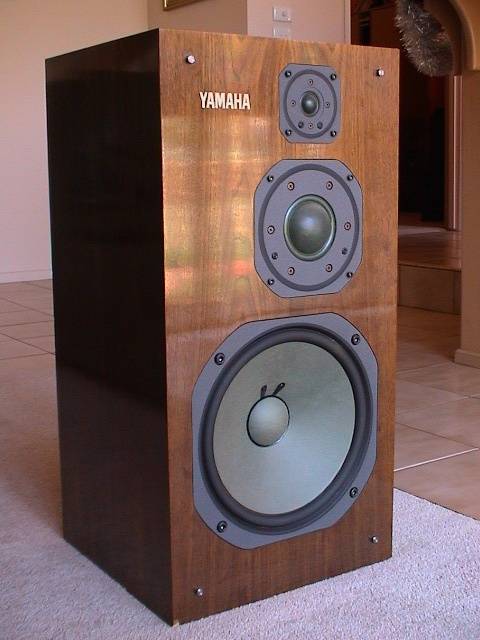

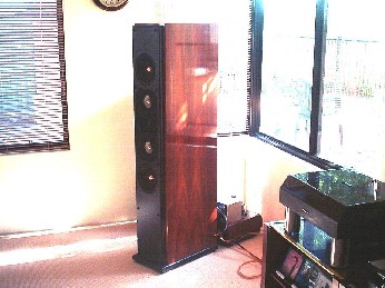

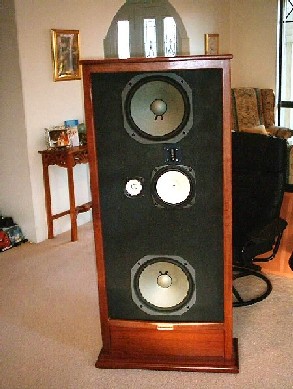

Seeing I'm currently using various speaker technologies including Bass Reflex (Proac 2.5 clone & Fostex 206E in 20L cabinet); Infinite Baffle (expensive Yamaha NS1200 Monitors); Open Baffle experiments with Fostex & Raven ribbons; and Electrostatic speakers ( see the Mackinlay ESL-3 a kit spkr at www.eraudio.com.au ) .
I would recommend to any beginner that in order to get instant gratification - go for the Fostex 206E ($84USD ea A Madisound) in a 20L BR box ! You get elctrostatic-like sound without the cost, hassles of construction or size limitations. Also, the Fostex is a crossoverless point source driver that requires no tuning or tweaking for the beginner. You will need to sort out the bass later, which in my case is currently TL subs or a pair of 150L BR boxes with the superb Eton 11" hexacomb driver.
I have to say though that of the speaker technologies mentioned above, my favourite is the electrostatic Mackinlay ESL-3. It has lightning fast transients and leaves the others behind for sheer detail retrieval ... it's not perfect either, but to my ears and taste in music the best I've heard!
Just my two cents worth...
