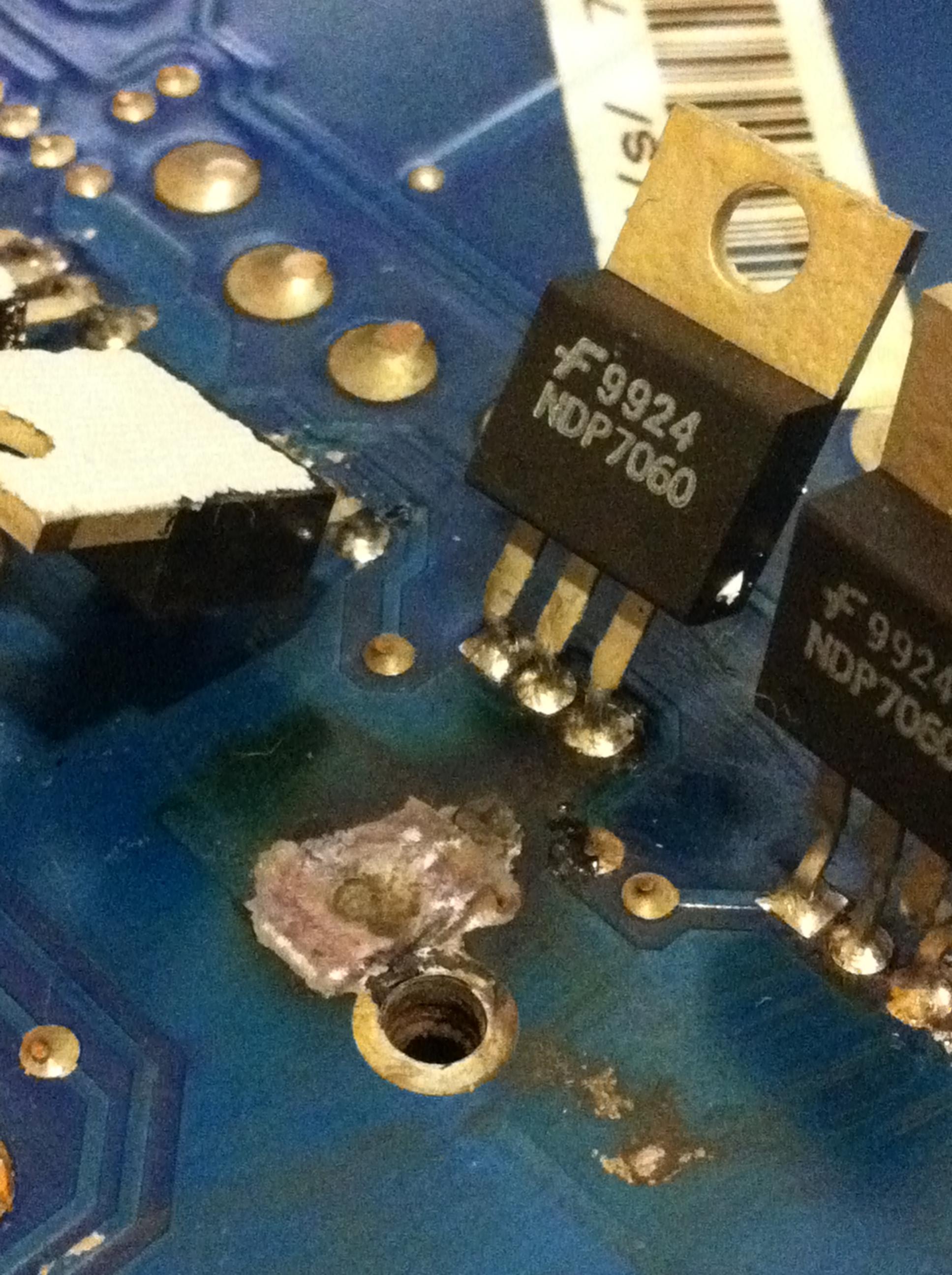

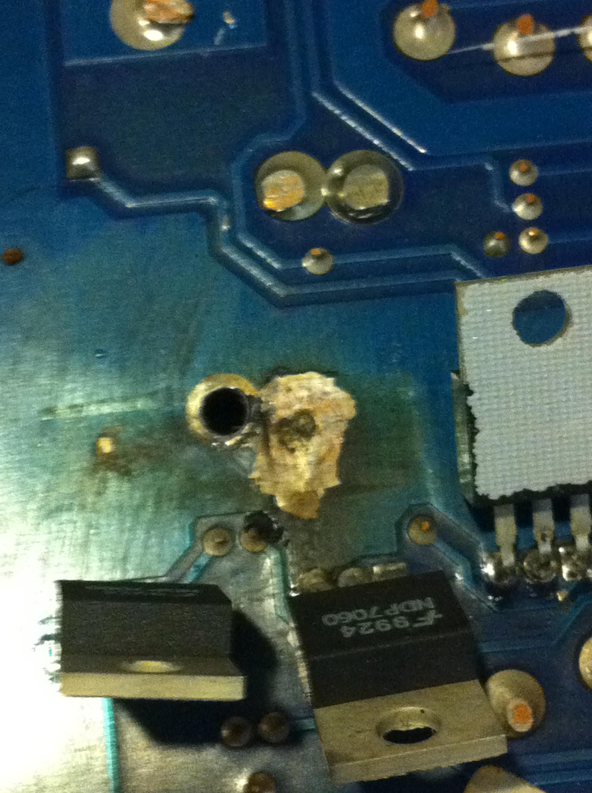

Waiting on the meter to arrive. In the meantime I took a really close look and found a small single strand (1/4"-3/8"long) of what looks like my speaker wire in the area of the damage(The wire is burnt to hell). Not sure if that had anything to do with it, but I'm pretty sure this failure was caused by external sources or by my over tightening the mounting screw that obviously grounded out(see pics). You can see on the second transistor at the top there is a little black spot where the transistor contacted the mounting screw
Anyway I was wondering what is the best way to repair the board where the covering is blown/burnt off?

As long as the board is not soft and is flat, it doesn't need to be repaired.
If the screw contacted the tab of the transistor, the wire was irrelevant.

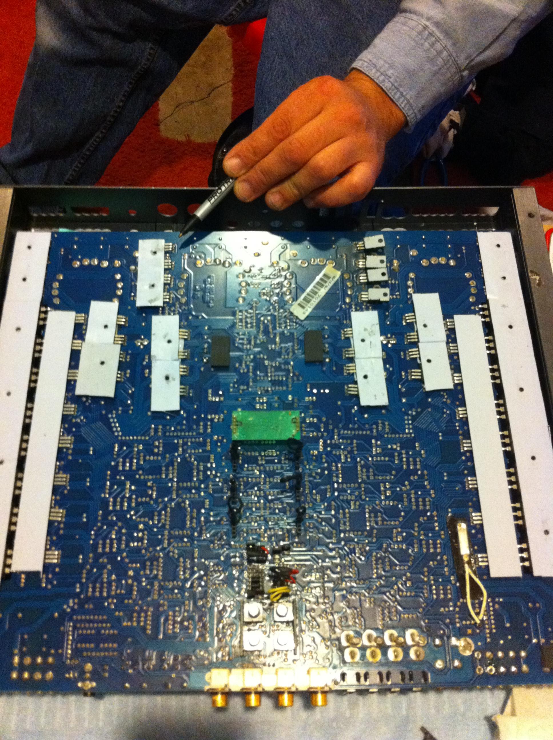

I made a rookie mistake by assuming that the visibly burnt area was automatically the damaged section. Upon further inspection I am getting bad readings in a different power supply that shows no visible damage.

It was the only one out of all four power supplies that read differently. The other 3 had nearly the exact same numbers as post #30. New sill pads should arrive later today. I'll get it put back together and test.
