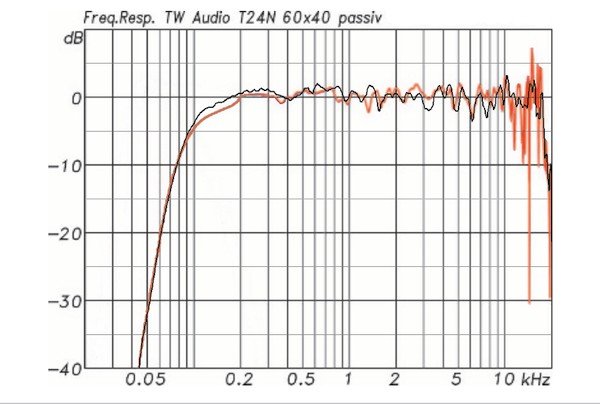

TW Audio T24N:
Frequency response 1m 4pi; Production Partner orange curve, me black curve:

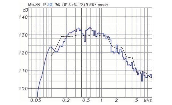

Max. SPL @ 3% THD; Production Partner blue curve, me black curve (note: my measurement intentionally limited @ ~130 dB):

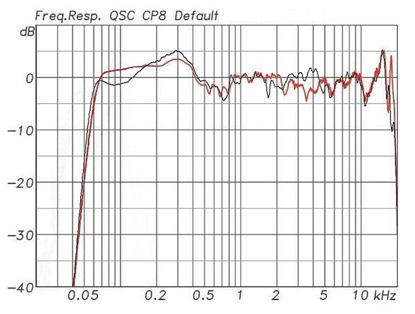

QSC CP8:
Frequency response 1m 4pi; Production Partner red curve, me black curve:
Max. SPL @ 10% THD:

TW Audio T24N:
QSC CP8:
Max. SPL @ 10% THD:

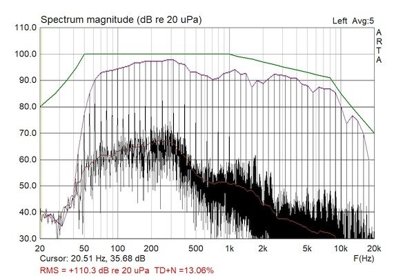

Using a using a perceptual based weighting in your distortion measurement, for example as in CEA 2010, can be a useful extension of this.
CEA-2010 & its modernisations, up to CTA-2010C, is probably the most meaningful max. SPL routine for subwoofers - but, for subwoofers only.
Only perception weighted routine used for full frequency spectrum I'm aware of is the GedLee Metric, which, warranted or not, has not been widely adopted. My view is that multitone distortion testing performed by the Production Partner & replicated by me, which is at least output filtered to represent a music signal, is probably fine for that purpose.
Thank you that is great information!
I do wonder with MD Anselm Goertz did measure -17 dB Distortion below 1 kHz while you measure -30 dB Distortion. In his measurement 12 dB crest factor is noted. Maybe 6 tones per octave isn't enough.
Do you know how Klippel Measures MD? @bikinpunk what do you use to measure MD? Would be very curious since you are the only person that does MD measurements of hifi speakers.

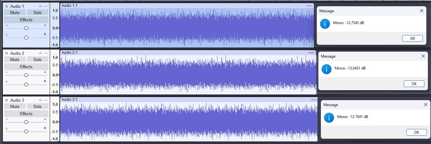

I did measure the arta output with audacity for 10 seconds, Amplified the signal to 0 dB peak. Measured the rms value for 12, 9 and 6 tons per octave. Why is the crestfactor the same?

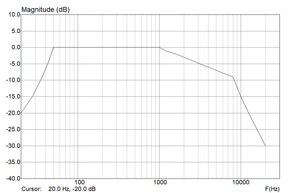

Also, attached is my EIA-426B filter as ASCII, importable in ARTA:

On page 50, the ARTA manual states:I did measure the arta output with audacity for 10 seconds, Amplified the signal to 0 dB peak. Measured the rms value for 12, 9 and 6 tons per octave. Why is the crestfactor the same?
"Multitone signal contains sine signals spaced 1/R octave in the user defined range from 5 to 20000 Hz. Crest factor is 13 +/- 1 dB. Resolution R can be user defined from 1 to 12 tones per octave."
Your Audacity levels are within .25 dB of a 13dB crest factor, verifying the ARTA output is producing the correct output level.
ARTA's three types of periodic noise, White PN, Pink PN and Speech PN, all have a crest factor of 12-13dB. That said, page 45 says:
"By further processing, the crest factor can be lowered to values below 6dB.
In ARTA, the periodic noise generation is implemented with a crest factor lower than 10 dB."

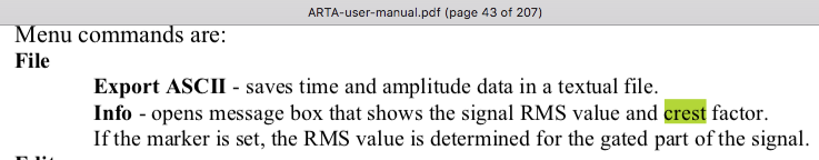

ARTA has menu commands to show the RMS value and crest factor:
So you can check the value of whatever signal you are generating before applying it.
Fixed or swept sine has only a 3dB crest factor, so heats voice coils rapidly by comparison to the other signals.
Art
I was wondering how it is possible that the crest factor is not dependent on the number of tones per octave used. Arta automatically reduces the Amplitude with increased number of tones to keep the rms value constant and additionally phase shifts the tones to maintain the same peak value.
