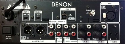

alright im gonna check today! but look at this:

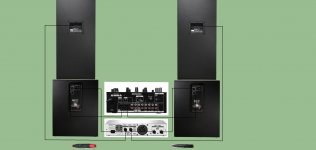

That is a schema that i draw of the pluggings:
Hope it helps :)

You've all missed it.
You're running the subs out of the booth monitor, which is an independent output from the main mix.
For each XLR output on the desk:
XLR goes out of the desk, and into the subwoofer. Do this bit first.
Then another bit of XLR goes from the subwoofer to the iNuke, which powers the tops.
Make sure your top speakers are wired up to the amplifier properly (store-bought SpeakOn cables will be fine) and you're set to go. Adjust the volume on each subwoofer equally - if you turn one up, turn the other up the same.
Since you've got the iNuke DSP, read up on how to do an active crossover on it. You only need a high-pass, set for 100Hz. Butterworth 24 should do the trick.

Oh okay , for the pluggings, i drew it to be shure i've understood well.
But for the crossover i have Gain ,Low pass and High pass. It just depends on the sound configuration : Stereo, Dual , Bi-amp 1, Bi-amp 2 and Bridge. So witch one do i choose?

Your sub takes the XLR input, and splits it in two - one is passed on to another subwoofer, or a different amplifier using the XLR output. The other is used for its own amplifier.
You're perfectly safe, but feel free to upload photographs if you'll feel more comfortable.
Edit - those crossover settings are correct.
