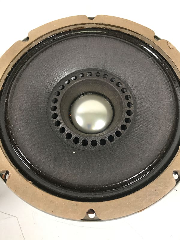

Here in Argentina we had LEEA, a factory which made VERY good speakers under Altec Lansing license, and one model had same multiperforated edge.
They also used the thin aluminum dome glued straight to voice coil, so it was not "cosmetic" or just "a dust cover" but an improvised dome tweeter, it certainly added some highs.
To boot, voicecoils were very short, wound on paper (latest models on Nomex) and using light Nitro type adhesives; those speakers had incredible highs for a 12" speaker, were MUCH used in 4 x 12" columns for Rock Concert PA.

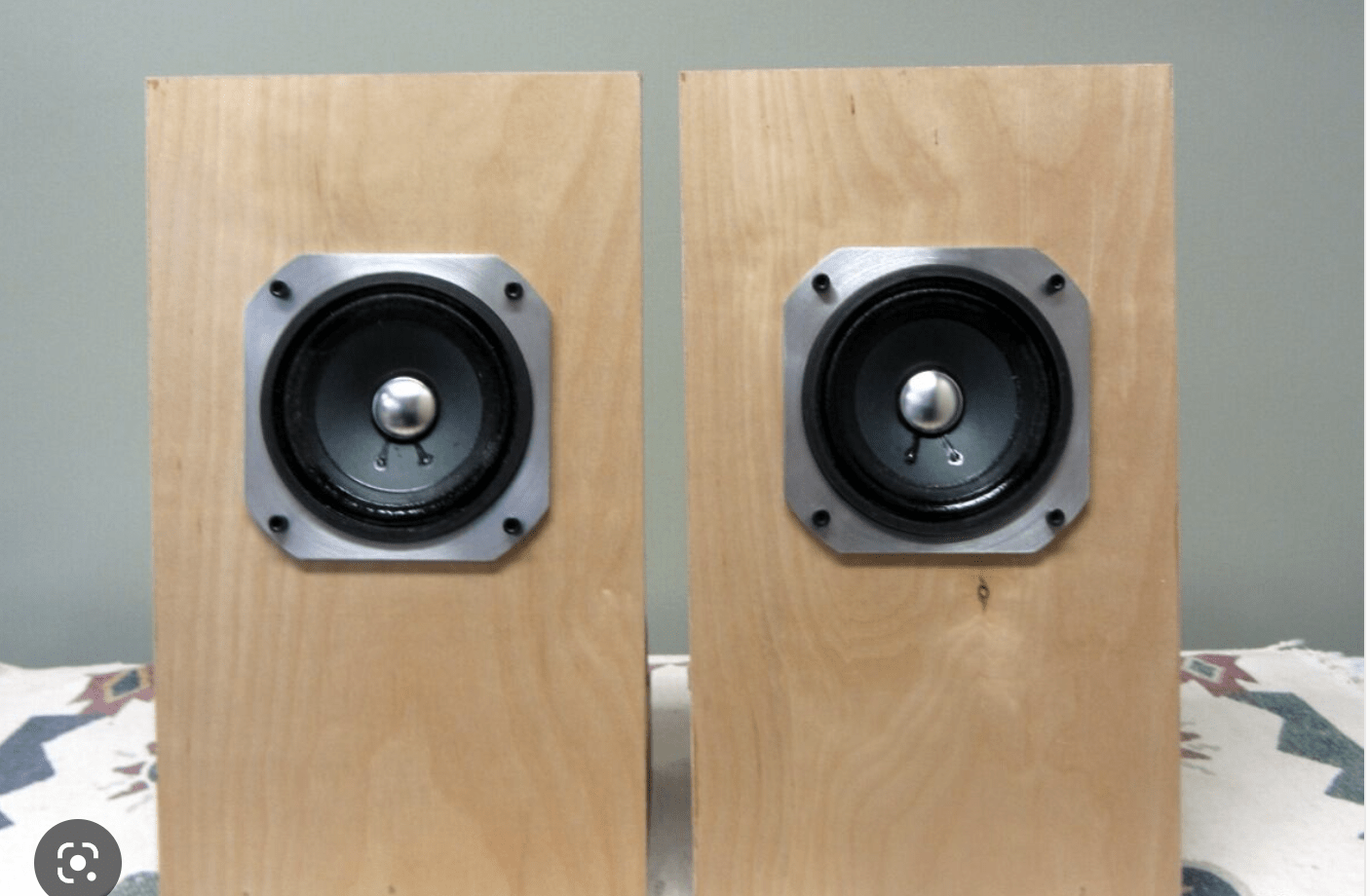

That's not that uncommon. My first intro to it was about 1980 with the Radio Shack 40-1311. Quite a good little 5" driver for the time, including the dome pseudo-tweeter and a cast basket. To this day I wonder if it gave more highs than a whizzer?They also used the thin aluminum dome glued straight to voice coil,
