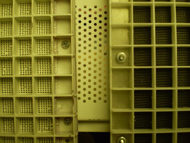

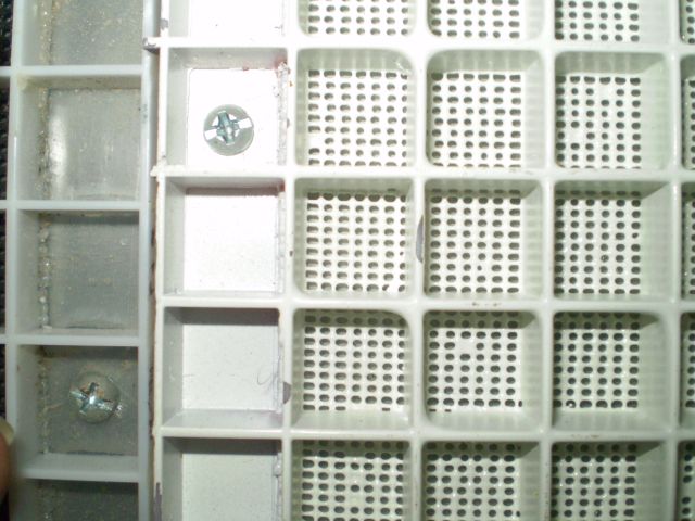

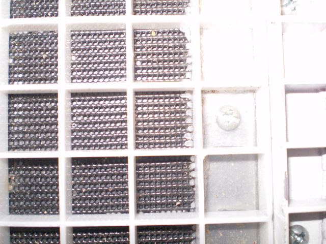

hi charlie, I have been meaning to get back to you on the open area topic, as i have been busy solving the transformer issue .
the very first panel I built used some preforated alu. (sofit vent) from home depot with 3/32" on about 7/64" centers, little did i know that the open area was only no more than 25% and even less with the coating as the holes were consideribly smaller by the time i got enough paint on them to properly insulate them from arcing of the high bias voltage i was using. So,when i finaly got them to produce a decent level ,i noticed right away that they were kind of dull sounding far away,but up close and next to my ear they were fine. I still have some of this material and will probably build some headphones from it.
That is when i switched to window screen it had 9.5mil wire at 16 holes per inch according to mcnichols charts this is an 71.9% open area.I then had the same issues of coating thickness,but they sounded great any how.Looking at the chart i estimate an open area of around 40%. As now my holes are roughly half the size i started with.But it did sound very good.
I then tried double powder coating ,as a single coat was not thick enough to handle the bias voltage. It was a much better insulator than the enamel i used and it yielded a much thinner and evenly coated coating than the paint.Thus,giving me a much higher percentage open area than with the paint.Right away i noticed a bigger,brighter and a more open sound.With such clarity that i wished it could be loud enough to feel it in my chest.
All of the panels had exactly the same size deminsions and stator spacings.As a i was investegating ,open area vs hole size and minimum and maximum hole sizes as well.but do to personal issues and properly driving the esl's, as stated before,i never got any farther than this.I plan on resuming my research and I am doing so now.
Also my bigger panles are exactly 4 times the surface area in oder to investagate the +6db gain increase in efficiancy theory.Not to mention better bass also.
These are some of the things i had tried to discuss with roger. but he would not give me a definite answer of what worked the best as he was being proprietory about his designs. I guess I can't blame him for that as R&D is expencive and time consuming.he assured me that he did not mind helping a diy'er and enjoyed doing so as he wrote his book for us.explaining how to do it using commonly available materials. jer
