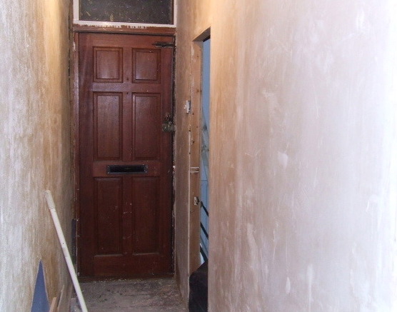

Uncle can't get to plaster the room until after bank holiday now which is 2 weeks away. So I've dragged all the stuff back in and set it up properly this time, including a mild DRC profile and 3 layers of 2" tiles to build up 6" of side wall absorbtion - I prefer this and gives back most of the imaging.

pinkmouse said:If it's any consolation, guess what I'm doing this weekend...
Is that plastering your handiwork? Looks good.
If so any chance you can pop up and do mine to save me waiting for 2 weeks 😀

ShinOBIWAN said:If so any chance you can pop up and do mine to save me waiting for 2 weeks 😀
Sorry, but I'm off debauching over the bank holiday weekend at the Towersey Village Festival. Lots of warm beer and black tie on Sunday evening for a gin and tonic workshop. 🙂
