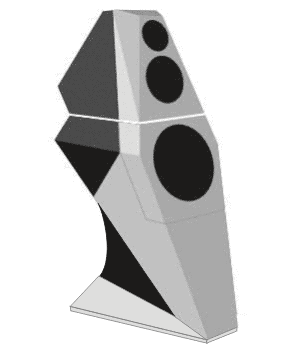

Finished the AKSA 55N+
I've had them up and running for about a week now and I must say they sound superb. I'm not one for really placing much faith in noticing great differences between electronics but I'm finally starting to come around to the idea after listening to these. The improvements are undeniable and unsubtle. Wonderfully cohesive and musical sound to these amps. Really add an extra notch of realism to the performance. The highs in particular seem much smoother that I'm acustom to after comming from Rod's ESP101's and Parasound amplification. Its still very detailed and with possibly more 'atmostphere' or 'air' but doesn't force itself on you like the others did, like I said before this is one extremely natural amp.
Possibly the best amp I've heard full stop or at the very least its the best I've had on the end of the Perceives that's for sure. Overall I couldn't be happier with them and they've taken the speakers up yet another notch or two.
Been deliberating over whether to use some 4u rack mount cases for the amps or redo the bases of the speakers to incorporate the amps like so:
Any thoughts?
Any thoughts?
Into very subjective territory here, but I'm not liking the look of that plinth. Not a fan of the pole that props it up either. Perhaps try modelling a a sheet of wood perpendicular to the rear to prop it up, or maybe clear acrylic so as to take focus of the prop and leave it on those beautiful enclosures.ShinOBIWAN said:Any thoughts?
