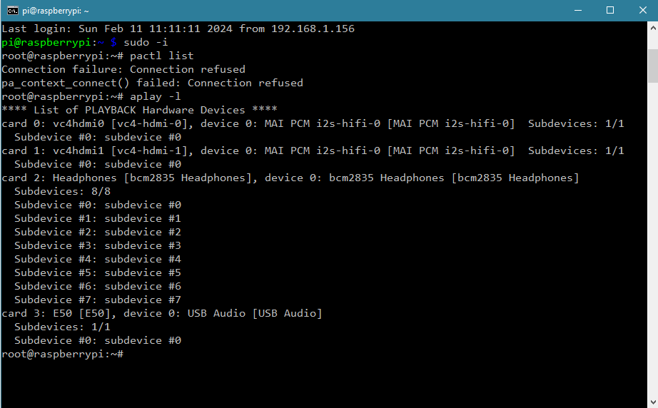

Is pulse audio also on your pi?
I ran pactl list to check if pulse audio is running and received an error.
aplay -l gave the following:
Use of .asoundrc is configured in default alsa configs /usr/share/alsa . Of course the player must run under the user of .asoundrc. What device is actually Tidal Connect using? Is it using the PCM device with peppymeter, or perhaps directly the hw device?

@phofman Is it possible to use the 'hw' directly bypassing .asoundrc?
If the Tidal Connect was started by different user then .asoundrc will not be used. The file /etc/asound.conf will be used instead. Please show the content of that file. You can also make a backup copy of that file just in case:
sudo cp /etc/asound.conf /etc/asound.conf.bak
then copy your user file .asoundrc to asound.conf:
sudo cp .asoundrc /etc/asound.conf
and see if that makes any difference.
The example of the /etc/asound.conf can be found in another issue:
https://github.com/TonyTromp/tidal-connect-docker/issues/23
If the player runs in the docker container, it's by principle "contained", only communicating with the kernel from the host POW. It has it's own user-space alsa stack (alsa-lib, configs) and only kernel devices (/dev/snd/xxx files) are passed from the host to the container.
