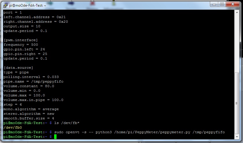

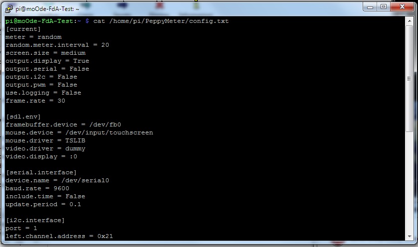

I am, now, working on the PeppyMeter: please find attached the config.txt, the list of the fb* devices and the command I am trying:

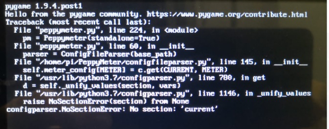

and the result, on the touchscreen is:
Please, be so kind to give some suggeastions to me.

Hello again,
after some test I discovered that it seems those errors disappered if the command is launched from /home/pi/PeppyMeter but the result is that on the display it appears only:
pygame 1.9.4.post1
Hello from the pygame community. Contribute - pygame wiki
Does make it sense for anybody?
Help me, help me, help me, please!

Hi Francesco,
I'm not familiar with Moode.
Where are you trying to start PeppyMeter? I hope you know that you cannot start it in the SSH session (e.g. putty) as there is no graphical context.
Best regards

So, I believe you are trying to display PeppyMeter in some display. Do you use Raspberry Pi or some other system? What is display model? How is it connected to the computer (HDMI, SPI, DSI)?
Did you modify the PeppyMeter source files? If not, you can start the program this way (from the folder /home/pi/PeppyMeter):
openvt -s -- python3 peppymeter.py
no need to specify pipe name in this line. It should be defined in the file /home/pi/PeppyMeter/config.txt:
PeppyMeter/config.txt at 994b00888c32e7e173dcb650719daac1fa36719b * project-owner/PeppyMeter * GitHub
You can also define framebuffer in the same file. In your case it should be fb0:
Best regards
