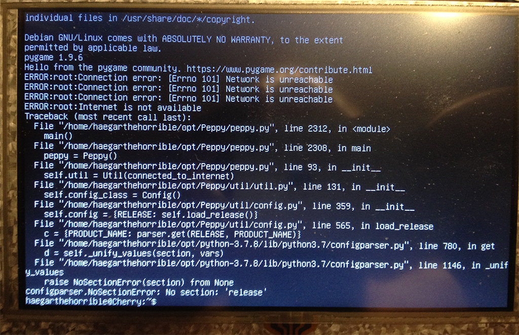

If i do that i get only this and Peppy does not start:
attachment.php
Maybe that Network error was there the whole time and i did not see it because it was hidden behind the Peppy GUI?
That logging code does not create a /tmp/error.txt file.
Damn, without logging its almost impossible to figure out whats going on.

The funny thing is that on my screen i see "no module named pygame"
That means its executed?

I have something that now starts Peppy up to the point where it says:
"pygame.error: unable to open mouse"
Is there a way to disable this "looking for mouse" thing (for testing)?
I did read something about
Code:
os.environ['SDL_NOMOUSE'] = '1'
os.putenv('SDL_NOMOUSE', '1')
But where do i need to place that in the code?

Hi MrGlasspoole,
Did you try to start player with 'sudo' when you see that mouse error?
If you need you can set SDL_NOMOUSE environment variable in .../Peppy/util/config.py in this function:
Peppy/config.py at 87daa889969de9b0215731785318e903b136219e * project-owner/Peppy * GitHub
In the same function you can see how it handles the mouse.
Yes, I don't use X but I use framebuffer as you can see here:
Pygame is a Python binding for SDL. SDL can use framebuffer.
Maybe if it works for you with X just use it (?) I hope that eventually you will find the oprimal combination/configuration.
Best regards
Yes sudo.
systemd runs as root and i also did:
Code:
ExecStart=sudo /bin/sh -c "export SDL_NOMOUSE=1 && /bin/openvt -s /home/haegarthehorrible/opt/Peppy/peppy.py"
But even doing this:
Code:
        if self.config[USAGE][USE_MOUSE]:
            if os.path.exists("/dev/input/touchscreen"):
            else:
it changes nothing and is still looking for the mouse. Weird - I don't get it
