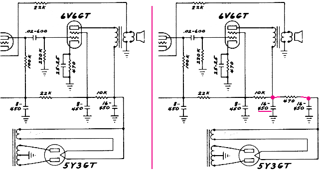

I'm trying to add a pentode - triode switch to my amp (5F1 type, SE). In pentode mode sounds fantastic, but in triode mode I am getting a lot of hum. The problem is that once you remove the B+2, the filter goes off.
The triode mode is achieved using Robinette method (B+2 off, pins 3 & 4 together with a 470Ohm resistor). I like the slightly darker tone and the volume drop, tough the hum is very present. I tried different ways to solve it:

As pentode, 6V6 is about 50K internal plate resistance. With 5K load impedance, power rail crap applied to the load is divided about 10:1.
As triode, 6V6 is about 2.5K internal plate resistance. With 5K load impedance, power rail crap applied to the load is divided about 3:2 = 1.5:1
Yes, it hums/buzzes about 7X worse.
This accounts for the rush to power pentodes in the late 1930s. More than power or gain, the pennies saved in a cheaper power supply.
The 5F1 is already minimally filtered, even for the small (poor bass) stock speaker, because it was CHEAP amplifier. Using the data above, you would think to up-size the main filter cap about 7X (33u to 49u does not begin to get there), so triode is as clean as pentode. However that is severe abuse on the vacuum rectifier. And up-sizing the first cap is poor leverage.
If you are choke-adverse, at least add another R-C filter to the B+. You have a 16u cap. The 6V6 cathode cap is a suitable value for R; do you have another several-Watt 470r resistor? These values give about 5:1 reduction of 120Hz which will be a real difference. Power output is down some, but this Champ won't rock the stadium in any case.

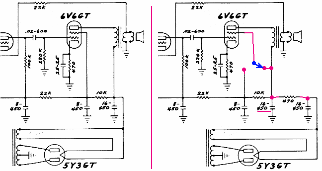

In the stock circuit, if you move the screen from the screen node B+ over to the plate, you lose the cleaner filtered DC of the screen B+ node. Since this is single ended, the amp has no natural hum cancellation like a push pull.
Note PRR suggested essentially moving the whole circuit down the B+ string one node. Now the plate and screen are both connected to what had been the screen node. SO it is better filtered, less hum to start with. Certainly should work.
When you tried adding a cap to pin 4 in triode mode, your new cap essentially filtered out your signal, because pins 3 and 4 would be connected together, so a big cap from plate to ground swamps the signal.

In triode mode G2 is connected to the Anode.
The gain will go down slightly. No extra hum.
Then is it OK to connect pins 3&4 directly without detaching B+2? Every schematic I have checked disconnects B+2 from g2.
If it works, looks like a very easy mod.
