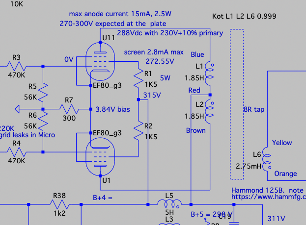

I'm currently going through running ltspice simulating Rob Robinette's EF80-based push pull output JCM800 Marshall amp, and I have a simple question. Usually you'd have the pentode screen grid at a lower voltage than the plate but the sim indicates that the design (with a 1K screen resistor) is higher than the plate. So even if the ltspice model is wrong, the resistances and currents means that the voltage drop for the screen is smaller than the voltage drop over the transformer at idle.
However if a PP output transformer is 22.5:8, the resulting grid is 1/4 of that from my understanding so around 5K6 in terms of plate resistance, the screen resistor plus the choke is 1270R (1K+270 DCR). The diagram below gives the schematic but ignore the voltages noted on the diagram, I've given the measurements below:

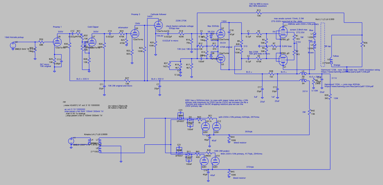

Note the diagram and the components follow Rob's design, although I have a separate pre power supply and so there's less current through the choke (but even an extra 5mA at 270R is only going to drop 1.35V).
B+4 = 324Vdc
B+5 = 327Vdc
Up = 288Vdc, Ik = 8.6mA
Ug2 = 322Vdc, Ig2 = 1.7mA
So you can see that the grid is sat above the plate which is not healthy from all my self-taught knowledge. Is there some difference between pentode screen use on HiFi vs Guitar amps that I'm not aware of?
If I add 20K to the screen resistors, it reduces the screen voltage below the plate and the screen current remains about the same (within spec). The plate swing drops and from my knowledge that would also make the kink more pronounced as it's not particularly negative below the plate). However I've never heard of 20K+ screen resistors (this is my first pentode output push pull).
Any wisened thoughts would be welcome.

I think your schematic is incorrect, but it is hard to tell for sure because the power supply is obscured. The B+ after the rectifier goes to the OPT center tap, then there is a choke then there is a supply to the screen. I am looking at Rob's page, comparing with the schema for JCM800 6V6.
I'd cross checked with this: https://robrobinette.com/images/Gui...ro/RR2104_Master_Volume_Micro_EF80_Layout.png
His EF80 uses SS rectification, but I was going to use tube:
The reason for the second rectifier is to add a reverb section (6at7, 6k6gt and a 6at7) at a later date so it needs ~30mA more and it makes it easier with the lower voltage power and higher voltage pre sections.
Yes, I looked at that too. It looked to me that the screen supply is after the choke, and the centre tap of the OPT from before the choke. The choke has resistance, and the screens have stopper resistors, so how do you see a problem? Is it just simulated and your OPT model in LTSpice the reason for it?
The choke only has 270R. With the screen 1K, that's 1270R but the output transformer is around 5K6. Hence in DC operation the EF80 plate sits at 288V but the screen sits at 322V. So yes - it could be the ltspice model causing a problem.
The concern I have is the pentode screen sits 34V above the plate at DC idle. Everywhere I've read, the pentode sits below the plate voltage for pentode operation and at/very near for triode operation. The datasheet (Frank's datasheet here) indicates both Va and Vg2 max as 300V which would suggest that this is outside of the safe operating limits.
I know Rob runs his EF80 plate voltage at around 270V (the B+5 being 289V) which could be why, the +30V screen above plate ensures that the Vg2 is under the 300V limit.
So this boils down to this question: is a screen 34V above a plate at idle safe?

The resistance of the OPT is not 5K6, that is the impedance which is what is 'seen' by the tube. The DCR is the measurement you need, It will be around 170R going by this other thread ... Resistance of OPT
Very good point. The full specs are here https://www.hammfg.com/files/parts/pdf/125B.pdf and that DCR is 296R across the primary so half that for each side so 148R.
So my ltspice model is wrong for DCR but how do I then model additional impedance (I suppose put a 148R resistor in series with each winding)?

Removing the 5k6 and adding a DCR of 148 results in a screen below 2.4V which is how I would expect it to be 🙂
Now to test out the impedance itself (ie through the inductance turns ratio).

Using a 10k series resistor to the screen will drop the screen voltage, reduce the quiescent screen current; but it will also severely drop the output power, unless you use a bypass cap from the screen to ground.
Caution: the bypass cap can supply Lots of current, when the tube is clipping (more on the clipping below)
Pentodes were made to operate with a constant screen voltage.
Normally, when the plate voltage swing took the plate voltage down to 50V, the screen constant voltage at 300V, caused the screen to draw Very Large screen current.
That was OK for transients, like a loud music passages (no clipping allowed, most Hi Fi nuts do not want to listen to clipped Philadelphia Orchestra playback).
But you are talking about a Marshall (electric guitar) amplifier.
Hard clipping causes the Push plate to spend 50% of the time at 50V, and the screen to spend 50% of the time at Very Large screen currents (then the Pull plate and screen to spend the other 50% of the time at Max currents too).
Yard on that Marshall for Max Distortion: Clip, Clip, Clip, until the screens glow Red, Red, Red, and melt into the control grid, or suppressor grid, or in the case of a beam power tube into the beam formers.
Short, Short, Short. Ouch!
Triode wired came along, the screen voltage completely follows the plate voltage swing. Just like a push pull Williamson amp with triode wired KT66 Beam Power tubes.
Then along came the Ultra Linear circuit, where the screen voltage reduced with signal, typically 40% as fast as the plate voltage dropped.
Just like a push pull Dyna ST70 with EL34 tubes in Ultra Liner.
There are more details there than meets the eyes . . .
