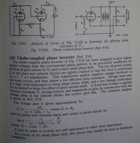

Not a pentode LTP but how about using a cascode LTP like L B hedge - The Wireless World Archive about half way down the page. Morgan Jones used something similar in his Crystal Palace amp, see Valve amplifiers M Jones. You could also parallel two triodes or use a choke instead of a resistor as anode load.
