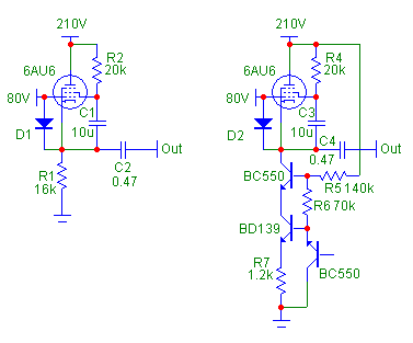

pentode buffer
I need a buffer for a 7pin project. I want to DC couple it to the previous stage. I see it mentioned here and there, but not that many detailed examples. I cobbled this design together, as I have all the parts. Any real advantage of using a CCS with this buffer? If I do, I'll probably sub a more robust part for the bottom transistor (the NPN as voltage reference, I lifted from someone here - Ian, I think). Anything out of wack here?

Being constant current devices themselves, trying to CCS load a pentode is, at best, highly problematic. "Head butting" occurs. IMO, the way to improve on resistive loading of pentode CFs is the installation of a suitable inductor ($$).
You said this is for a 7 pin project. Think about paralleling the sections of an inexpensive 6J6 twin triode, as the CF, in combination with CCS loading. The cathodes are already tied together. 😉
I know you don't want to use a CCS plate load for a pentode, because the plate is isolated from grid1. Therefore the current through the plate won't change much with voltage changes at the plate, meaning the current source would be trying to drive a high impedance.
I don't see the same issue when using a current sink under a pentode follower. Connected at the cathode, the current sink is working into a low impedance. Isn't this the same as for a FET? You wouldn't put a current source to load the drain, but a sink under a follower is pretty common. Is there an analysis of this written up somewhere?

A 6AU6 is terrific for the CCS (high plate resistance), but its transconductance is too low to make a really good CF.
I should be more specific. I'd be using it to drive a preamp, but not a lot of cable. My current one (DEQX) has 50k input impedance. Would that still be an issue? Or, where would you draw the line for this tube?

50k and small capacitance shouldn't be a big deal. But you know me, always trying to get things optimal...
The real advantage to a pentode CF is lowered input capacitance (yes, there's slightly higher gain, but we're talkin' the difference between 0.92 and 0.97). I've gotten interested in trying them myself (see the SY/Pete Millett crossover thread), so will probably have some distortion spectra for the 6AU6 as a CF in the next week or two.

Yes. Not impressed. 😀 The problem is that you really don't get much better performance from it in the context of audio. The capacitances are reduced, which could be significant for an electrometer, but meaningless here. Distortion was low, but source impedance was still 1/gm, so not really any better than a triode. The only other performance advantage (in exchange for a higher parts count) was a slightly higher gain. But if you can hear the difference between a gain of 0.95 and one of 0.98, you're a better man than me.

With a reasonably quiet supply, wouldn't a resistor do almost as well as a ccs, especially with a ccs on the cathode?
Brings up another question that puzzles me. I would think that the impedance of g2 should be paralleled with the dropping resistor, to calculate the cap to cathode. But I'm a bit mystified as to how to calculate, or even estimate that. Data sheets don't show grid curves with other factors held constant. I'm thinking that it would typically be relatively high with a current source on the cathode, as a voltage change at g2 could only change current at g2, in opposition to current at the plate.

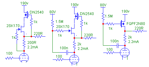

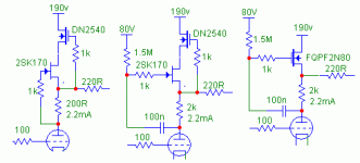

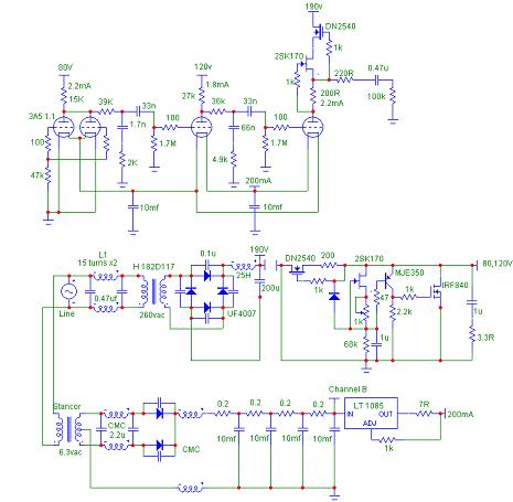

Been thinking about the follower, and came to the conclusion that a mu follower would be the better choice for my project. Here's what I'm planning on using it for, and three different versions of the mu follower. I'm thinking that at the low currents I'm running, the SK170 might be the better option as the controlling device. Or?
BTW, phono amp is from Dmitry Nizhegorodov. Shunt supply a version of Salas's supply.

Right now, I'm thinking that the gyrator mu follower will be a nice fit. If I use the cascoded version, I'm also thinking it would good to bias up the top device some with a battery. Of course, an enhancement mode device on top would need to be biased. But even with the depletion mode device for the top, some extra voltage across the lower device might be desirable. Without additional bias, the DN2540 would only put about 2V across the SK170.

An IXYS 01N100 or 10M45 would drop -3V Vgs at low current, which is probably OK for a 2SK170 bottom device in a cascode. Based on the 2SK170 datasheet the Ciss would be about 33pf at 3Vds and would only decrease to 30pF if Vds is increased to 10V.
I'm thinking about a cascode gyrator using a 2N7000 + 01N100 myself, but the 2SK170 is a great choice for lower current operation and the 01N100 will work fine at a couple of mA.

Thanks Michael. I was thinking not so much the Ciss as getting on the flatter part of the curve, but 3V looks pretty good there if the data sheet is accurate. Don't know if that matters much here. The 10M45S does look like a better fit than the DN2540, and I have a couple. I'm liking the gyrator idea, as I can set the voltage so that tube drift will be less of an issue. Plus, the voltage from the input supply is just right for the output tube.
Also, since this is the output tube for the preamp, it's a good spot for a slow start circuit for charging the output cap. I've use simple RC circuits to delay power for other projects, and Greg (Geek) mentioned the application for the gyrator. It should flatten any power on thump. Alas, I suspect that I'll still get some thump on power off, as there is little storage in the HV supply.
