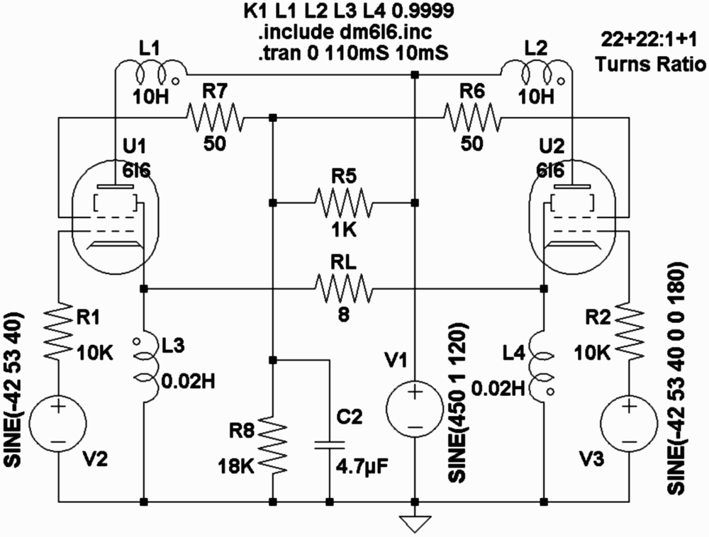

I been messin with LTSpice, trying to figure the best way to abuse
a pair of Pentodes in AB1... But not going so far as to define exactly
how "fixed" bias should be generated. Here's some simulated 50W
output stages. Assuming a pair of 6L6's and 450V B+.
The best of the batch seems to be in Pentode mode, with output
windings fed back to cathodes. This was clean well beyond the
rated output, without needing an absurd amount of drive.

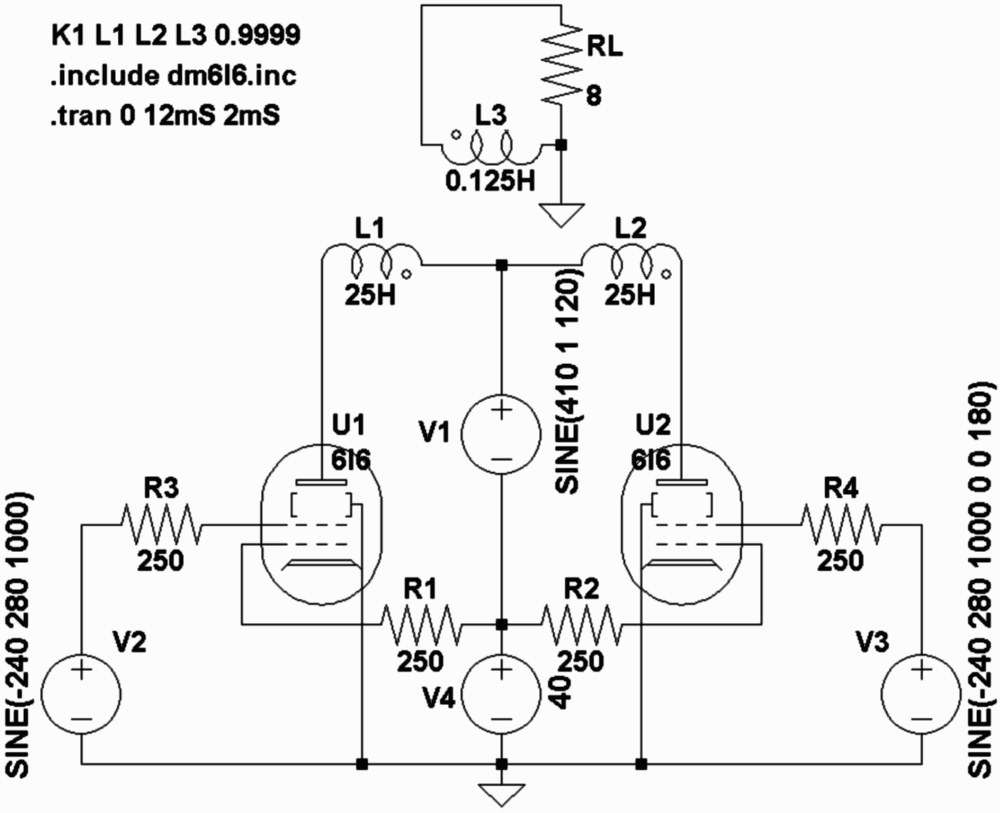

The oddball here is Screen Drive. I had problems getting this one
to work well for me. Till I experimented to see what happens if I
dump 1W into G1. And run with G2 screen mostly in the negative,
and never higher than the lowest dip of the plate... G2 negative
(Space Charge Mode?) looks very promising, at least in the sim.
You may need to put the BeamTet symbol in your Misc Folder.
Same folder as the default Triode and Pentode symbols. Its
pins have been renumbered to work with the spice models.

Drive goes positive, but never exceeds cathode, so its never in A2.
There is 1V of 120Hz ripple on the power supply to investigate for
possible PSRR problems? Good news, there don't appear to be any.
Then again, its only a sim...
And only a stage, not a complete amplifier...
Oops.. I left input set on 40Hz in the Zip above to tweak the Henries!
Also the sim time was set rather long to capture that. 1KHz will show
much better behavior. And the sim time can be very short, as filtering
caps for PS are not modeled, DC stabilizes rather quickly.

Duncan warns his model for G1 current is only an approximation.
So this sim run could be completely and totally invalid.... Seems
plausible??? Drive voltage swing is high, but very little current.
Also not sure if the Miller effect is modeled to G2 swings or not?
1W of continuous dissipation at G1 seems effective to replace
several Watts of discontinuous dissipation at G2, when screen
voltage would traditionally have been much higher. The plate
here would have to dip below 60V before drawing a G2 current.
More than enough plate swing for the targeted 50W output.
I am sure that allowing any G2 current would be a disaster.
Positive G1 could then focus beams directly onto G2! And I am
confident the Spice model is unaware of that effect. So I did
not care to press the design into the realm of G2 dissipation.
The FFT looks pretty decent for not having any NFB. Perhaps
G2 driven negative is asserting a constant Mu, like a Triode?

ray_moth said:I don't have Tube-Cad, I have LT Spice.
Incidentally, I think I've found a good solution
Why you holding out on us? .ASC (zipped) please!
P.S To run thr model, you'll need most of the files I've included. The
IRF820 in the PS uses a special circuit element that looks like a N-MOSFET with extra connection to the source-gate. If it doesn't work, you may need to use one of the existing symbols.
To run in reasonable time on my system, I had to dumb down the
circuit to just one channel, and completely fake the power supply.
My butchery may have ruined it??? Still seems to spice pretty good.
Was 1VAC in the speaker circuit to emulate a back EMF?
We can see GNF religiously track the input with back EMF disabled.
Your circuit must have had an absurd amount of gain before that
tracking correction is applied...
All the same its clear, GNF here makes for one very clean sinewave.
I'm not sure what it will do for music? And transients that may clip...
Like an op-amp with an iron hysteresis loop in the feedback path.
We may need a less idealistic model of an OPT to really know...
