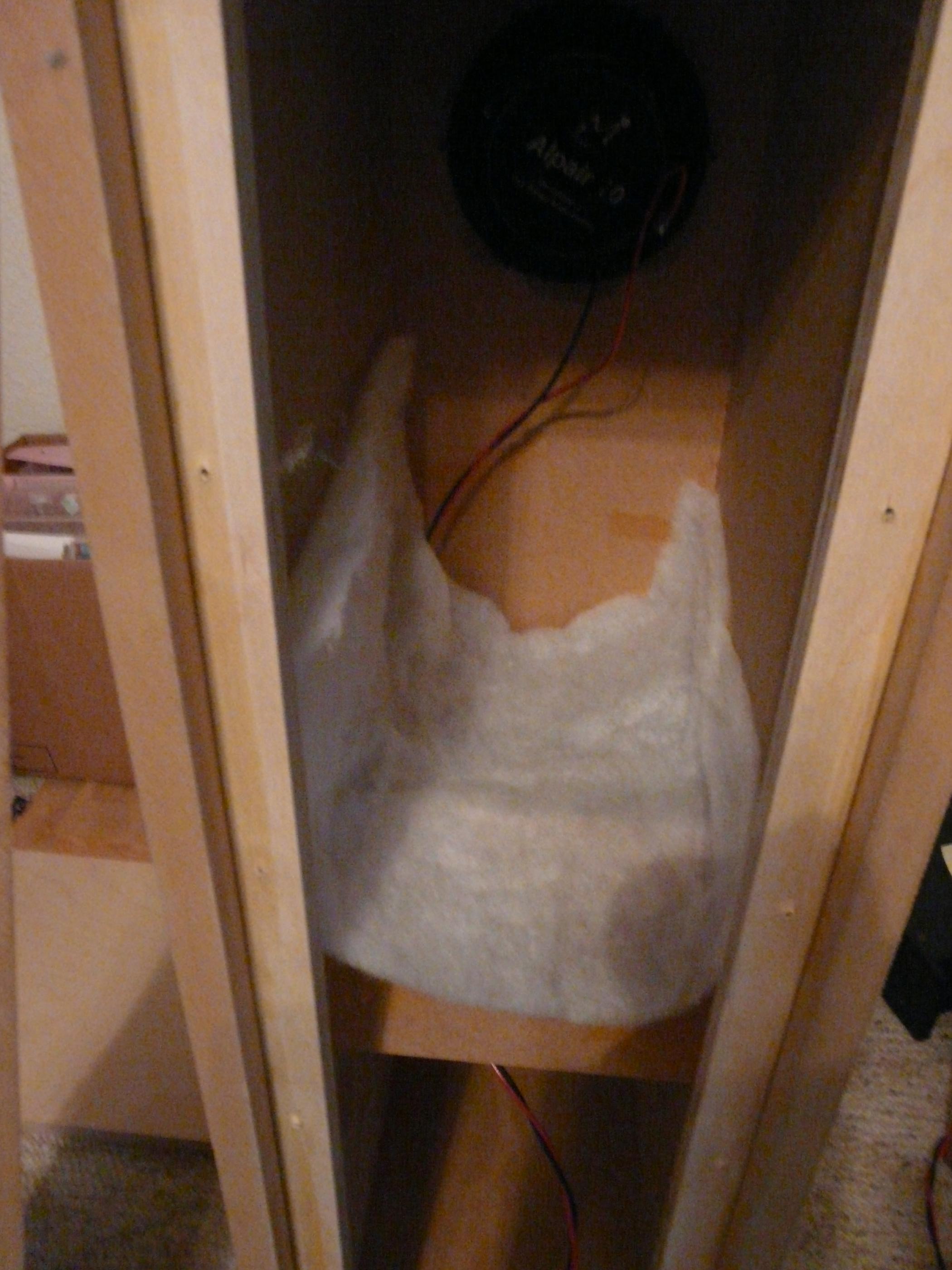

I have recently completed a pair of Pencil 7.3s and Pencil 10.2s. ALL of my previous builds were sealed cabinet designs. Stuffing and tuning those cabinets was easy. Stuffing the Pencils was, and remains, a mystery. I'm just not sure how to achieve the best performance by tuning the type and amount of stuffing in a Pencil.

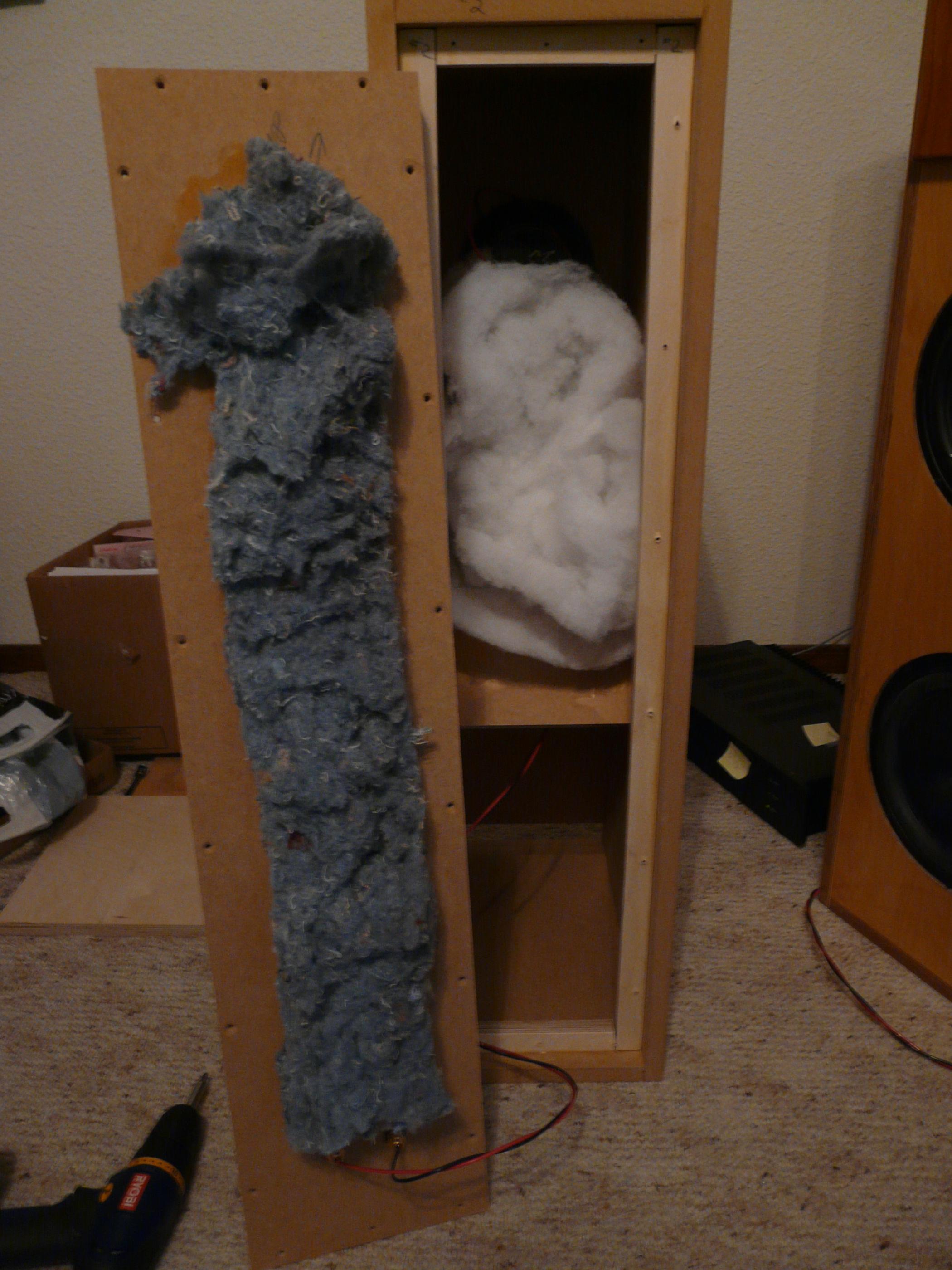

I built the Pencil 10.2s from MDF with an off-center brace about one-third of the way up from the bottom of the cabinet. (This is a "test box" and was never particularly intended to be the last word for these 10.2 drivers.) I deeply beveled the edges of the driver opening in the baffle as recommended. The box was stuffed with teased polyester above a "sling" made from polyester batting (like for a quilt) to hold the stuffing in place. The sling is about half way up from the bottom of the cabinet. I thought the stuffing was pretty sparse, but maybe not (this stuff REALLY EXPANDS A LOT!!). There is a 1 inch or so layer of recycled denim on the back panel top to bottom.
The results from this arrangement was decent bass but a very sibilant treble (as in "running out of the room with hair on fire and ears bleeding" sibilant).
I removed about 60% of the polyester fibre fill and experienced a serious improvement in the treble / reduction of the sibilance but an unexpected chestiness and minor congestion in the mids.
I'm wondering if a different TYPE of fill may be better.
Also interested in understanding whether it's necessary to line the box with some sort of absorbent material.
Bill

OK, lets give this a try....
I went back to something chrisb said about removing a lot of stuffing and using dacron fill. These are pictures of the CURRENT Pencil A-10.2 boxes. I have removed about 1.5 cu ft of stuffing from each box just leaving a little above the sling. The current sound is reasonable. Bass is OK, treble fairly smooth, but a bit congested. The sibilance is pretty much gone, just a slight edge. Maybe some more breaking will help overcome that anomaly.
Only one speaker shown due to what seems to upload size limitations..
