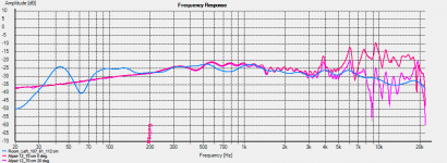

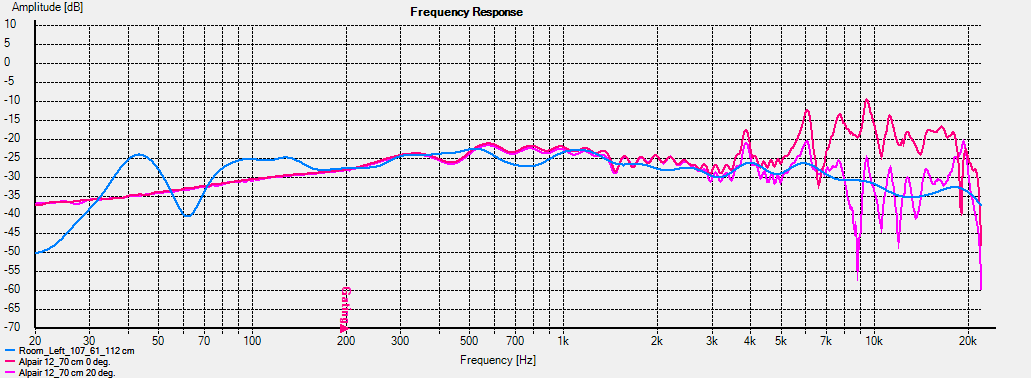

I did couple of measurements yesterday, to check if there are any problems in frequency responce. According to those measurements there are no big issues. What you think about those small "hills" (blue graph) around 500-600 hz and >1 khz? Are they shouting to my ears?

Hmm. No real step-loss indicated in those plots, which show a pretty flat (it's not half bad for an FR based speaker) response to ~5KHz where the A12 begins to peak up. They wouldn't really benefit a great deal from a wider baffle in this sense as driver & box are largely self-correcting, although in terms of wavelaunch & edge diffraction it will obviously be different to a narrower baffle cabinet.
The A12 was designed to be listened to slightly off-axis, as is also indicated in the above plots, along with those from Mark & the Japanese magazine measures, so sitting off axis (about 10 degrees) as noted by Norman is a good move.

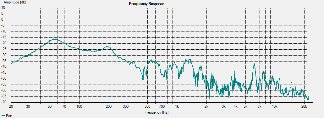

About port tuning: is it normal behaviour that it boosts also ~200 hz? The graph may also show some diffraction from Alpair element, so it's maybe not absolutely correct.
