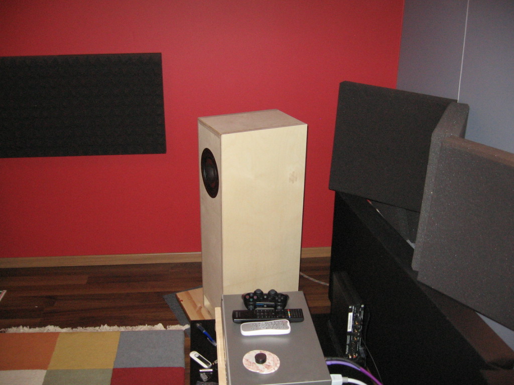

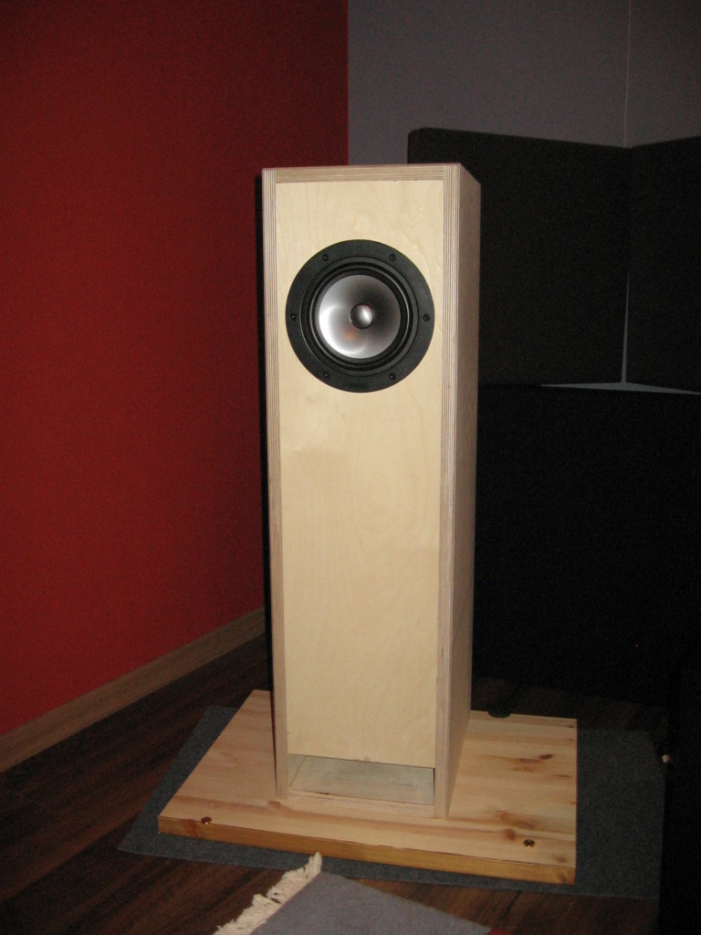

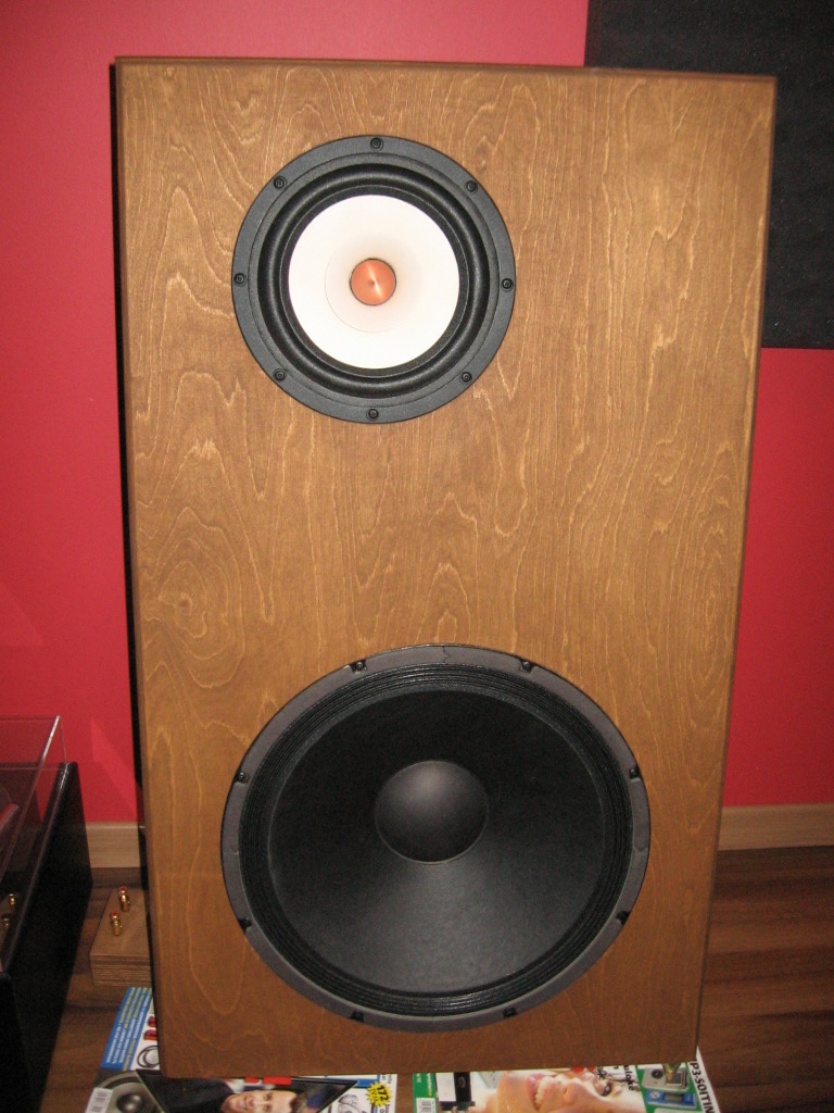

I decided to build Pensil 12 cabinets. One cabinet is allmost ready. Hopefylly I will get first listening impressions during next weekend. I used 21 mm plywood with internal 23x23 mm strips to fix plates together with home tools. I think that cabinet is very rigid now. Bracings are maybe not needed.
I will maybe add additional 30 mm thick plate with spikes under the cabinet. According to my experiences spikes are very useful, but I will need an extra plate to fix M6-threaded inserts properly.
How about chamfering/filleting the front corners? Is it needed?
I will use Polyester stuffing inside the cabinet. How much stuffing is needed for Pensil 12?

Hi Kn,
Shouldn't be necessary to chamfer the corners. Add around 0.5lb (227g) of stuffing, adjust this material volume to suit your listening taste.

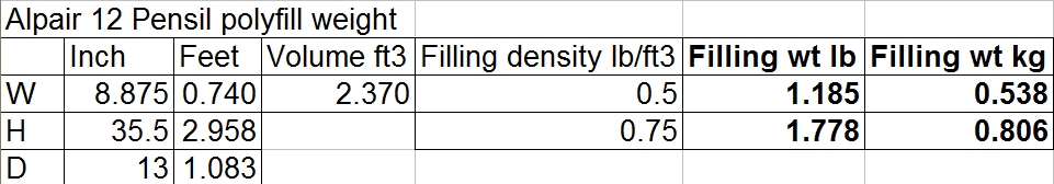

Hi Mark,
Based on the calculations, would the right amount of stuffing to be around 0.5 - 0.8kg?
Edwin

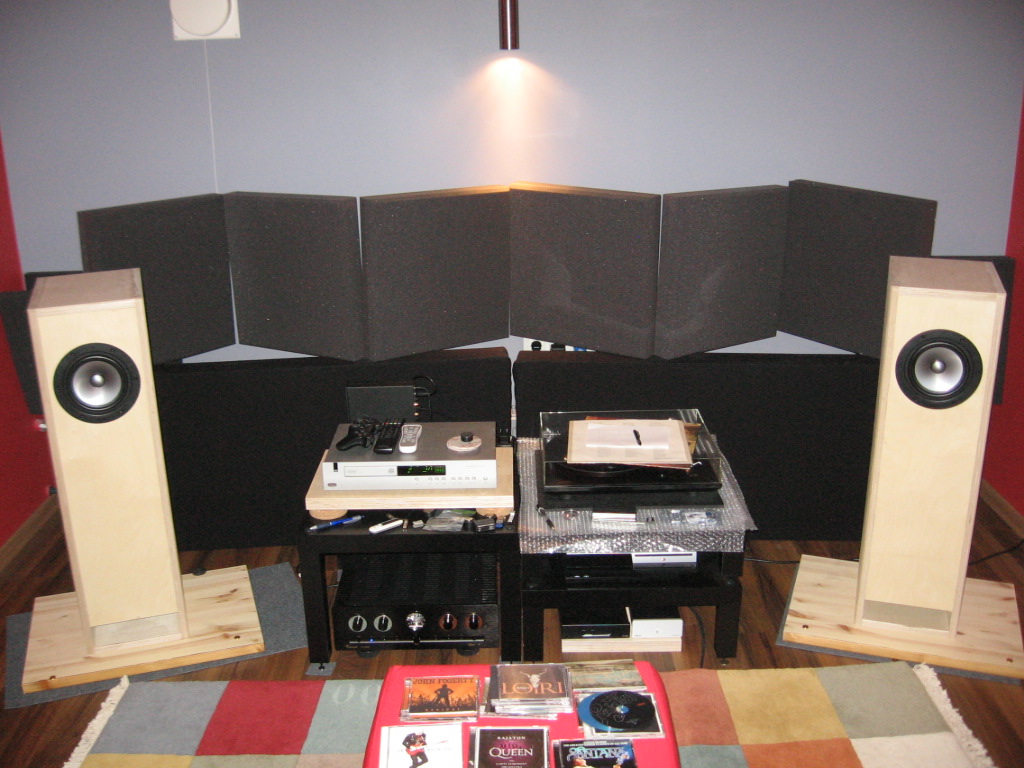

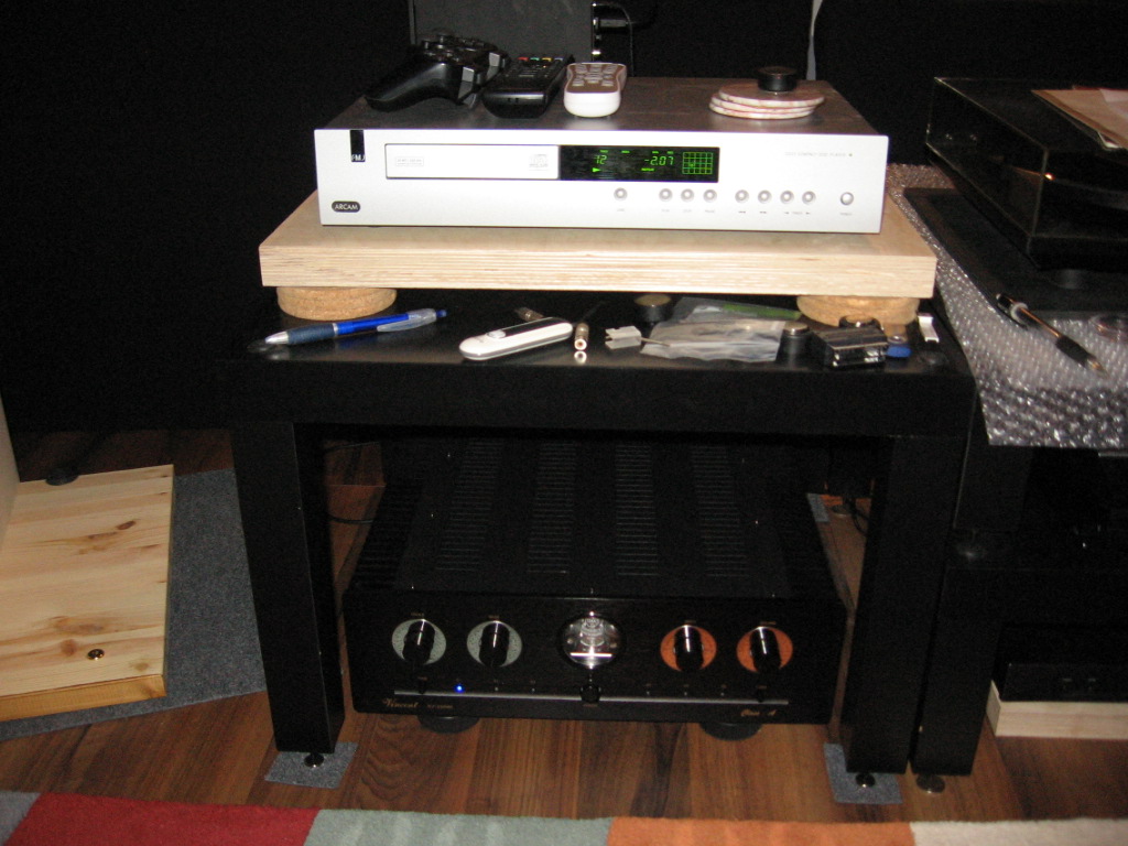

Some listening expressions after 5 hours of listening: very neutral and clean sound without any listening fatigue. Male/female vocals are awesome. Imaging is pretty good. Some piano tracks sound a little bit strange? Maybe too thin voice, not so full bodied as could be. Stuffing: 500 grams of polyester (polyfill) / cabinet. Setup: Arcam fmj cd33 cd-player and Vincent sv-236mk integrated hybrid amplifier. Setuo of Pensils: about 100 cm to front wall and 50 cm to side walls. Room: 4,2 x 3,3 x 2,4 meter. Listening distance >2m.
Which kind of setup you prefer? How much toe-in is needed?

Hi Knight Rider,
Looks like a very nice build. Its too soon to judge your speakers. Give the Alp12's at least 100 hours of gentle run-in. Looking at your pics and room and taking your listening distance into account, I'd suggest a slight toe-out of around 5 to 10 degrees. But you'll need to further experiment once the driver's have run gently for at least 200 hours.

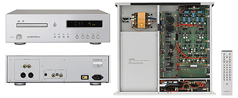

Last year, I made Alp12/Pencil 12's for respected pianist John Morris. He runs Alp12's in Japanese Walnut Pencil 12 cabs, fed by a Luxman L-590-A11 int. Class A amp and a Luxman D-06 CD player. John chose this combination after many hours of listening. I spent time helping John to set up his system using my collection of Murray Perahia (mainly Naxos) CD's. John's room is fairly large (from memory 9m X 6m)

In the long run, I think you'll need to do some experimentation. I'm not 100% sure if the potentially powerful Vincent is the ideal amp on your system given your listening distance is relatively close and room size is slightly tight for these big Pencils. I'm not certain how the Vincent's auto switching between Class A to A/B will effect the drivers. From what I can see Vincent and Shen Ya share technology and possibly components? If they do, its not necessarily bad news but most amplification in this sector of the market is geared to "commercial" reality. Design and component selection will be affected by this factor.
I'd also be tempted to keep a look out for a separate DAC if you intend keeping the Arcam. Good it is, but not quite in the class needed to make the best of the Alp12's. I personally only use CD players with dedicated or in-house made transports. Sadly, this means spending allot more money as yet I've found no short cut that satisfies my testing needs.
