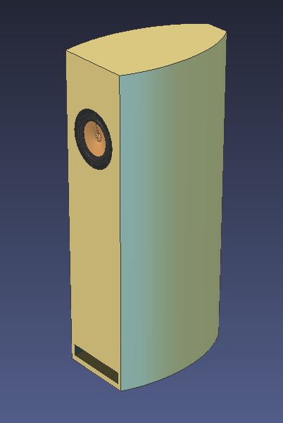

Hi Scott/Dave,
Which aspects of the Pencils' dimensions are critical? I'd like to play with the idea of curved side panels. If I keep the enclosure height and cross sectional area the same my hunch is the tuning will be unchanged. Is that a reasonable assumption?

So far so good I think, but I'd raise the questions of curved in what direction and what fabrication technique did you have in mind?
the millwork trade has a simple abbreviation - "CCM" no matter what materials / techniques are employed, curves cost money

So I think that you'd want to be careful that bracing/support framing for curved panels didn't interfere with the QW action. If you'll note from Dave's drawings and pictures posted elsewhere, panel bracing on these is best oriented vertically.The Pencils are a small range of easy-to-build floorstanding cabinet designs for Mark Fenlon Audio drivers. They use a combination of traditional quarter-wave design, a custom T/S volume alignment, and Transmission Line damping to provide a balanced response with a flavour of both vented and TL enclosures.
Depending on the particular drivers being used, the Pensil can be a pretty skinny box, making access to adjust damping / fill levels a bit a of a challenge, so at the very least I'd consider fabrication with either front or rear panel removable
Cross section area, line length (height), driver placement from the top, terminus area, placement* & depth (don't go building a 2" baffle)
Regardless of box, bracing is best placed longitudinally (ie along the longest dimension and not at the centre of a panel).
This is more formally stated as: The brace should divide the panel such that the sub panels have a larger aspect ratio than the original panel.

Well my curvy Pensil 10.2 works out at 425 deep with a random by eye boat profile, 17mm deeper than regular. I have assumed 18mm material and kept the cross sectional area, height and baffle the same. I think its a looker, which is important to me. I'm tempted to build it!

looks great - how where you contemplating fabricating the curved wall panels?

Stunning! I had a set of Rockets (RS450's and RSC200) that have curved sides and they look great. VERY similar profile to what you have suggested. Go for it!!
