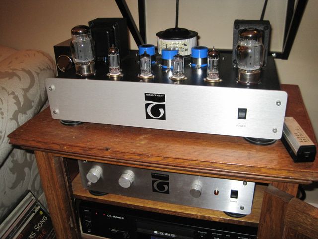

BTW, nice amp - you bought from Trancendent directly or put it together? How does it play with the OTL tech?
On the cabinet side, excellent designs by Scott (Pensil's) Mar-Kens (Dave).
Hi Zia: I bought the amp partially wired---Yes, these drivers are impressive... even with few watts there seems to be plenty of music 🙂 and I am getting amazed by the clarity - so revealing, yet not harsh.
Actually, it's not an OTL, it's a cathode follower. Bruce discontinued them to focus strictly on his 'signature' OTL's.
On paper, it's looks underpowered paired w/ the MA 10.2's, but in a real-world situation, it's a very satisfying pairing.

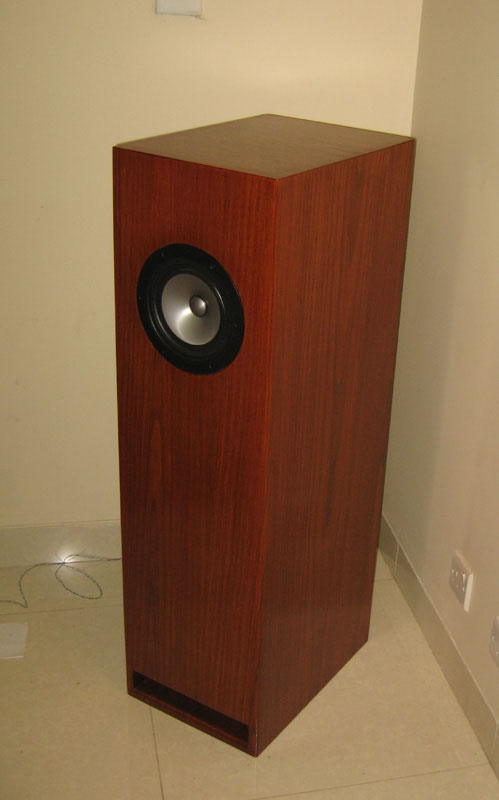

Don,
I was a bit apprehensive after putting the boxes together - the Super Pensils looked BIG. But after veneering, finishing, and installing the drivers, they have a solid yet stylish presence about them, and definitely look elegant. Will post some more pics this week.
If you are planning to do with Alp 10.2, then size should be more manageable, and still look great, especially with your P10 treated drivers.
Zia

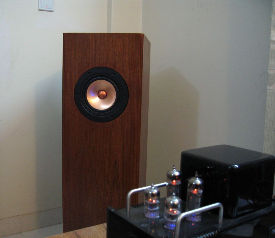

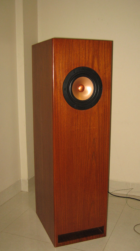

Some more images of the Super Pensil 12s.
Very nice. Beautiful.
And like a some Canadian Inuit canines, two different eye colors. 😀
Probably not confined to Canuck dogs!!😀Very nice. Beautiful.
Yes, your speakers turned out beautifully!
