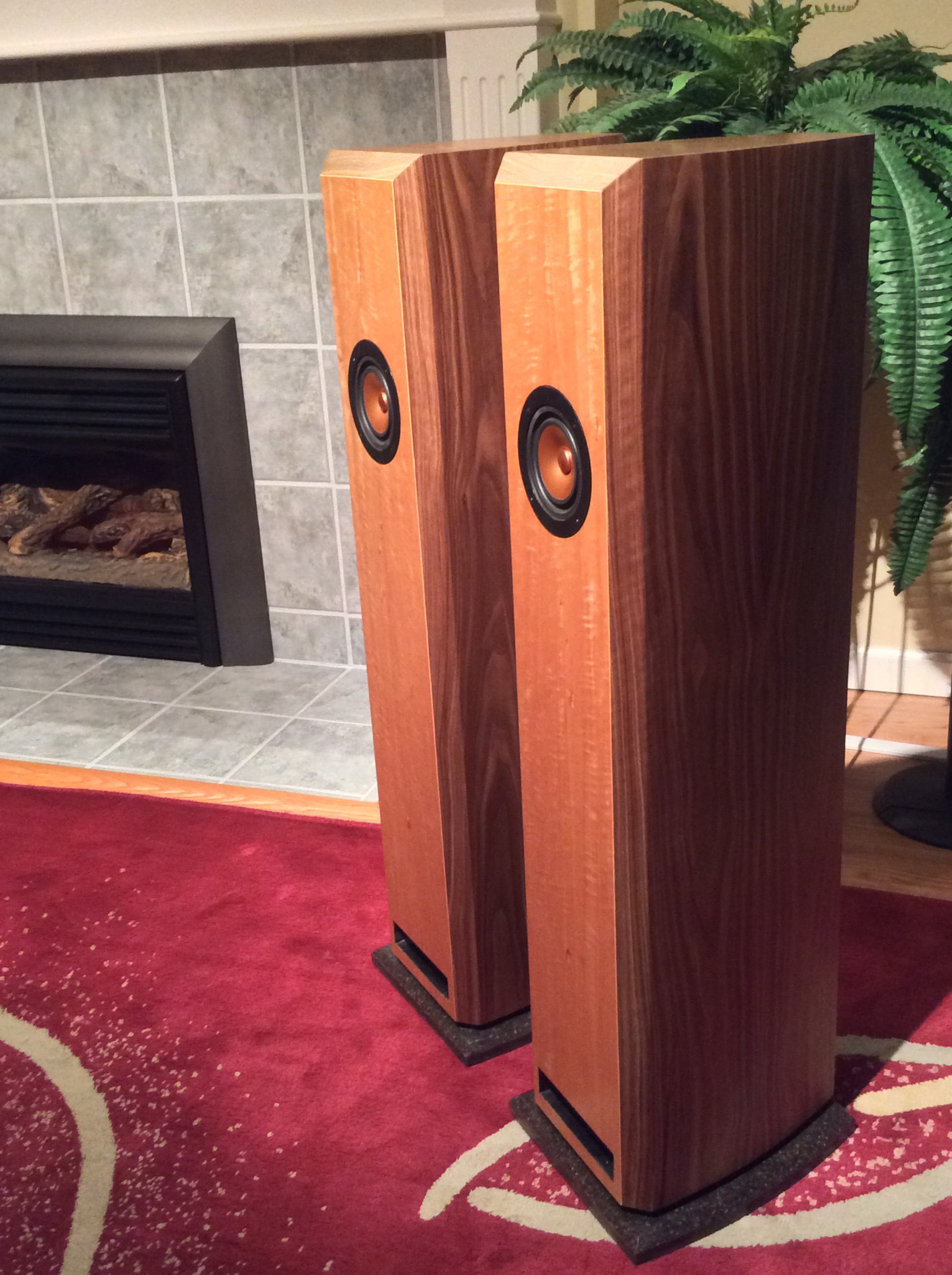

Those are beautiful chris. Do you notice any subtle (or not so subtle) differences from flat face non curved versions?
Haven't made an extended comparison, so I can't speak to the sonics, but sure do love the look of the curvies - they were a bespoke build, no longer in my possession.

Any info on these? Sealed? Bottom port? Rear port?
Pensil design family is vented at the bottom of the line, so there's no reason the ports couldn't be placed on the rear, or even the bottom? provided sufficient clearance to wall/ floor boundary .
