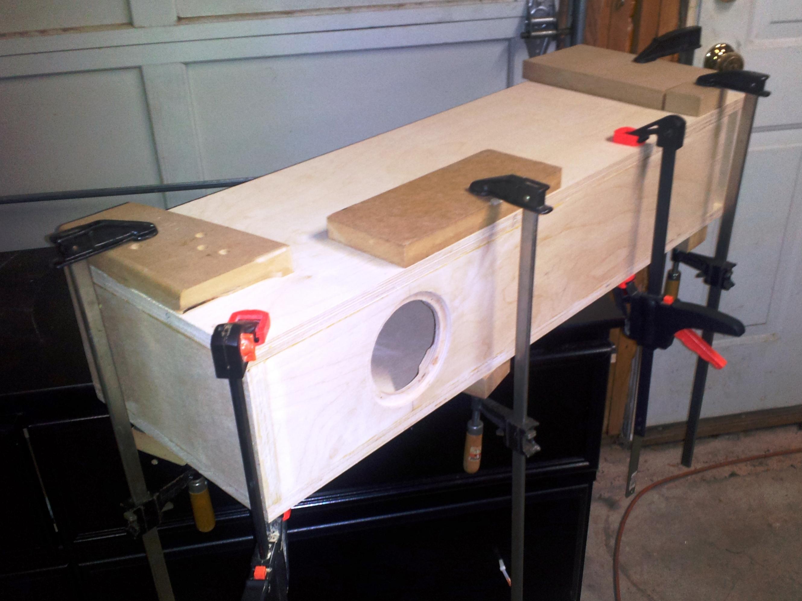

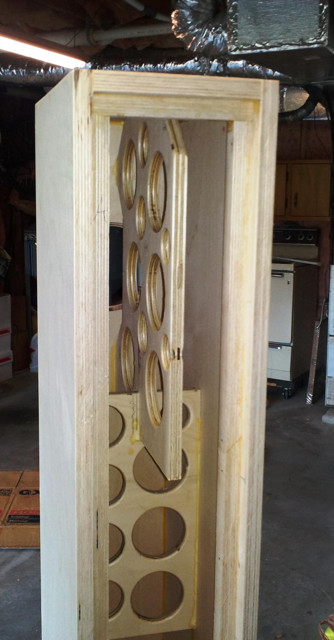

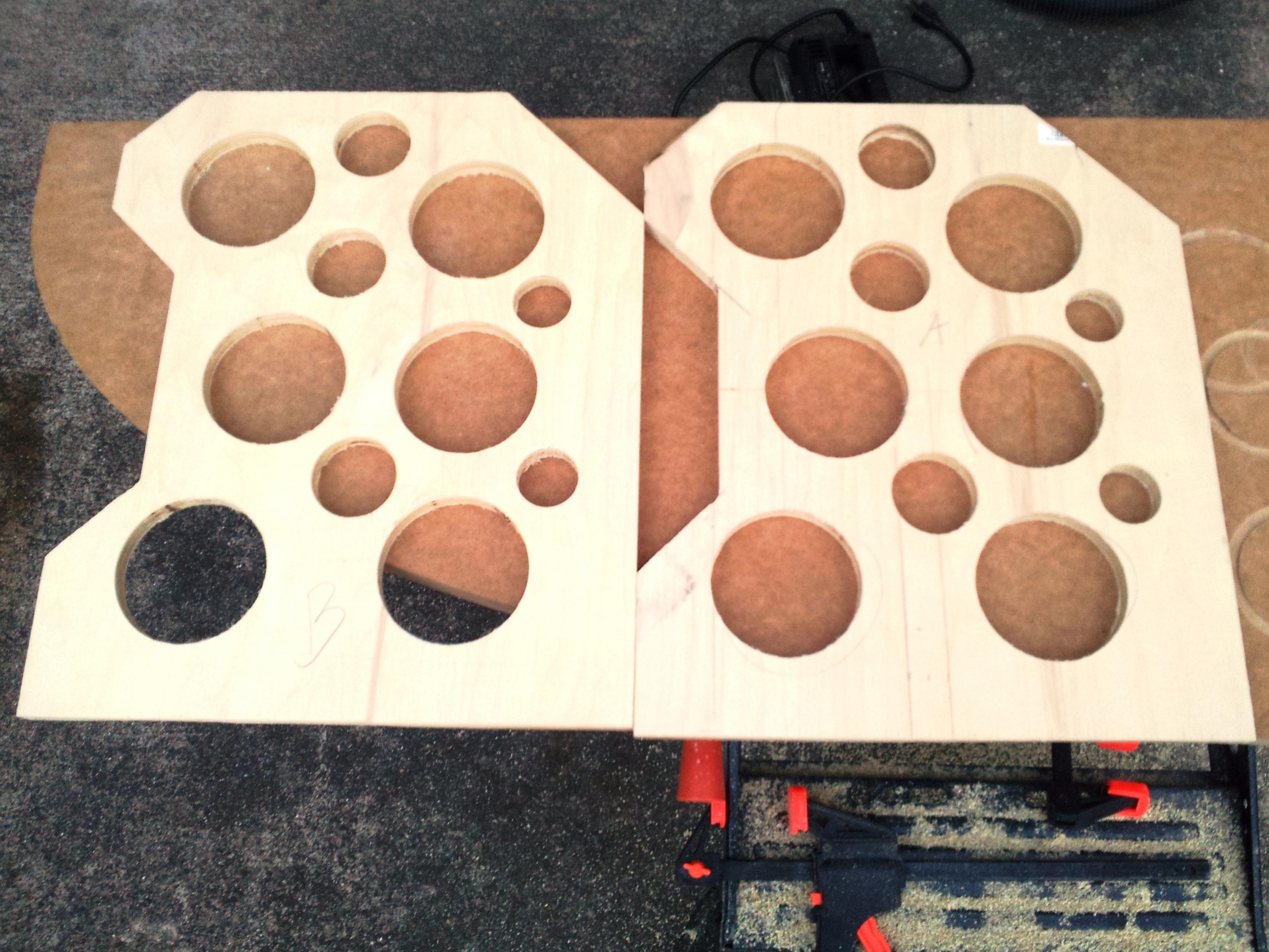

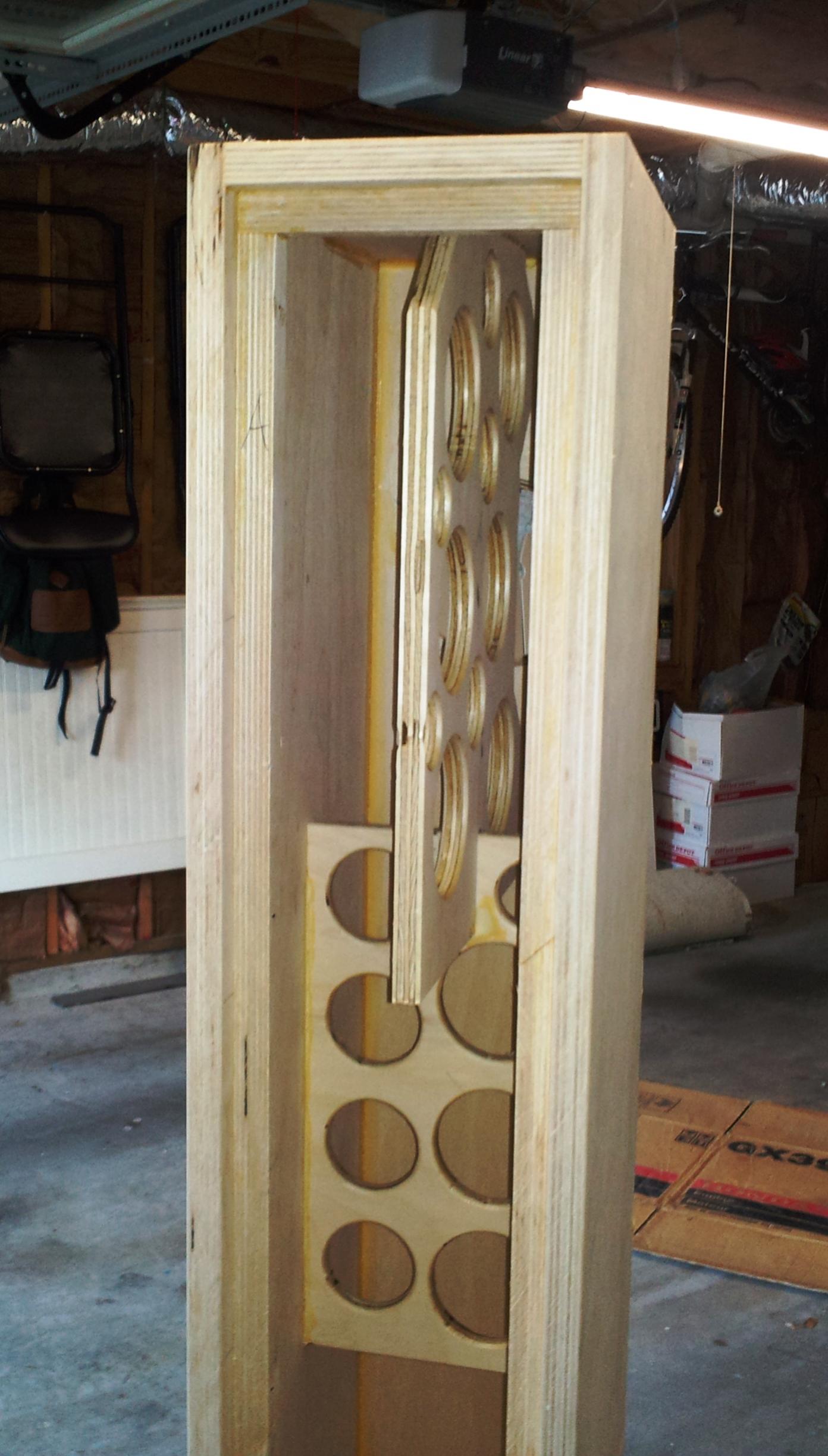

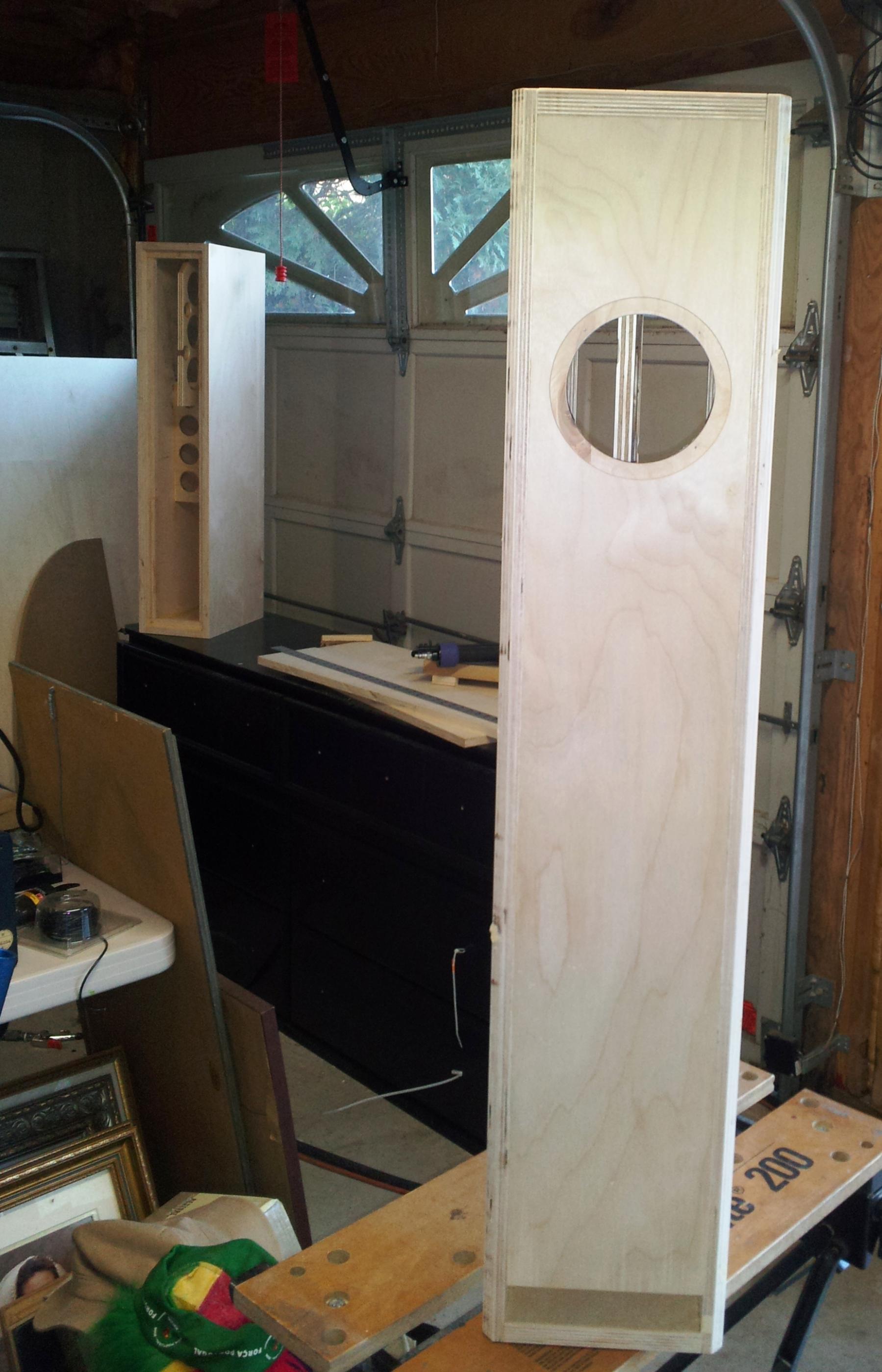

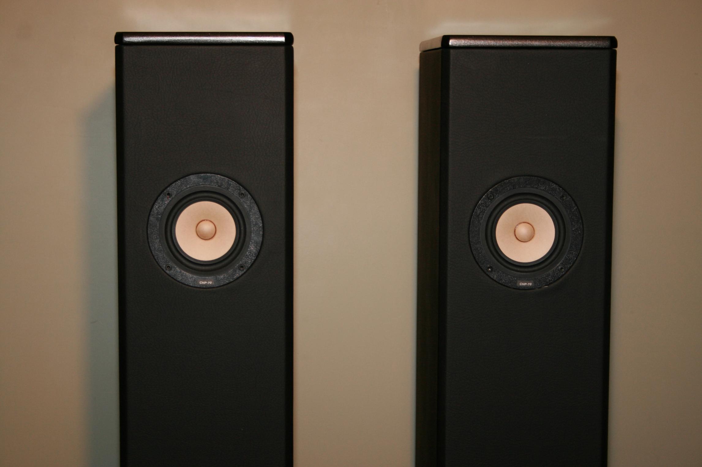

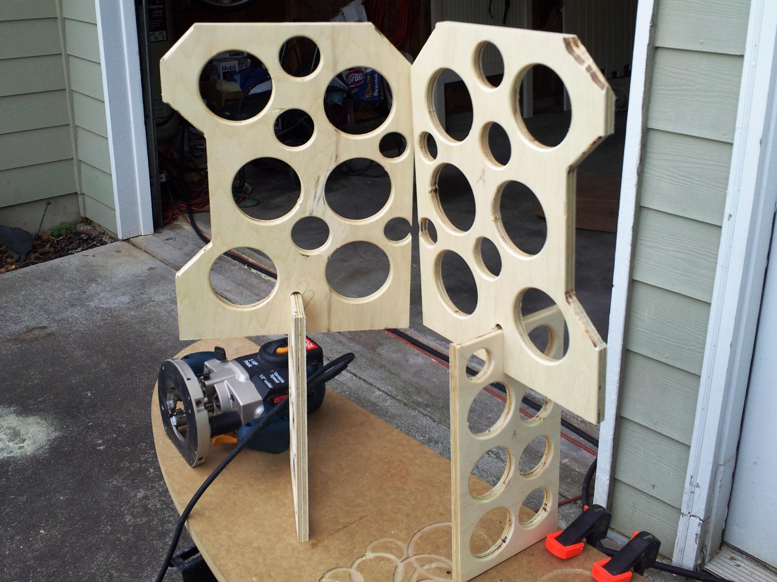

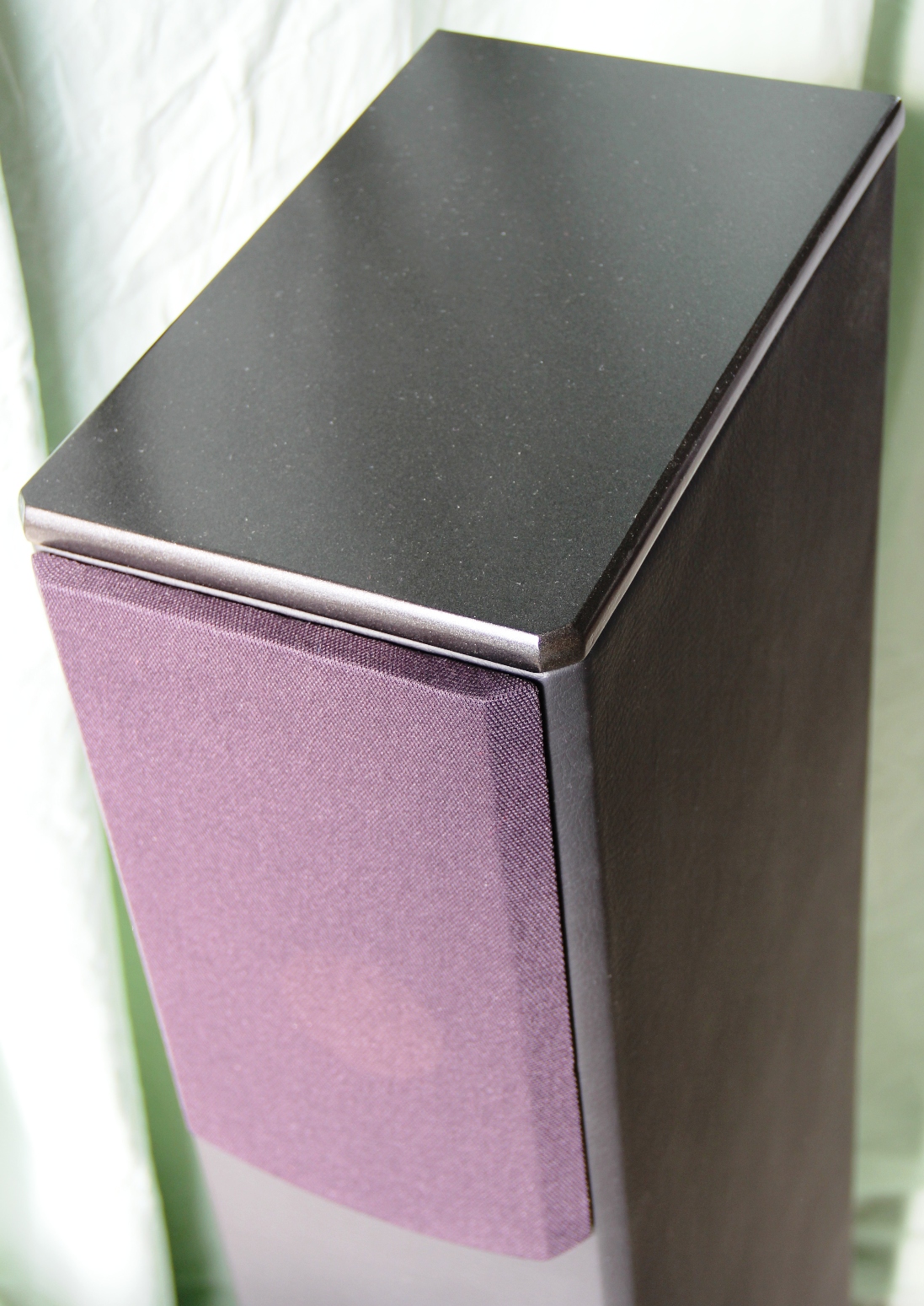

Here are some pictures from my most resent build. Glue up and a few pictures of the brace. Yes the brace does take a lot of time to build. Hopefully it was worth it.

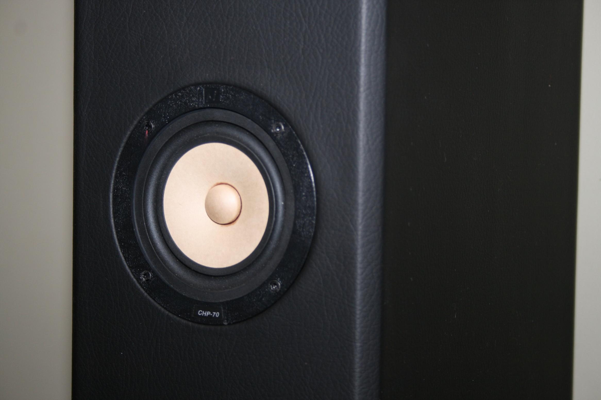

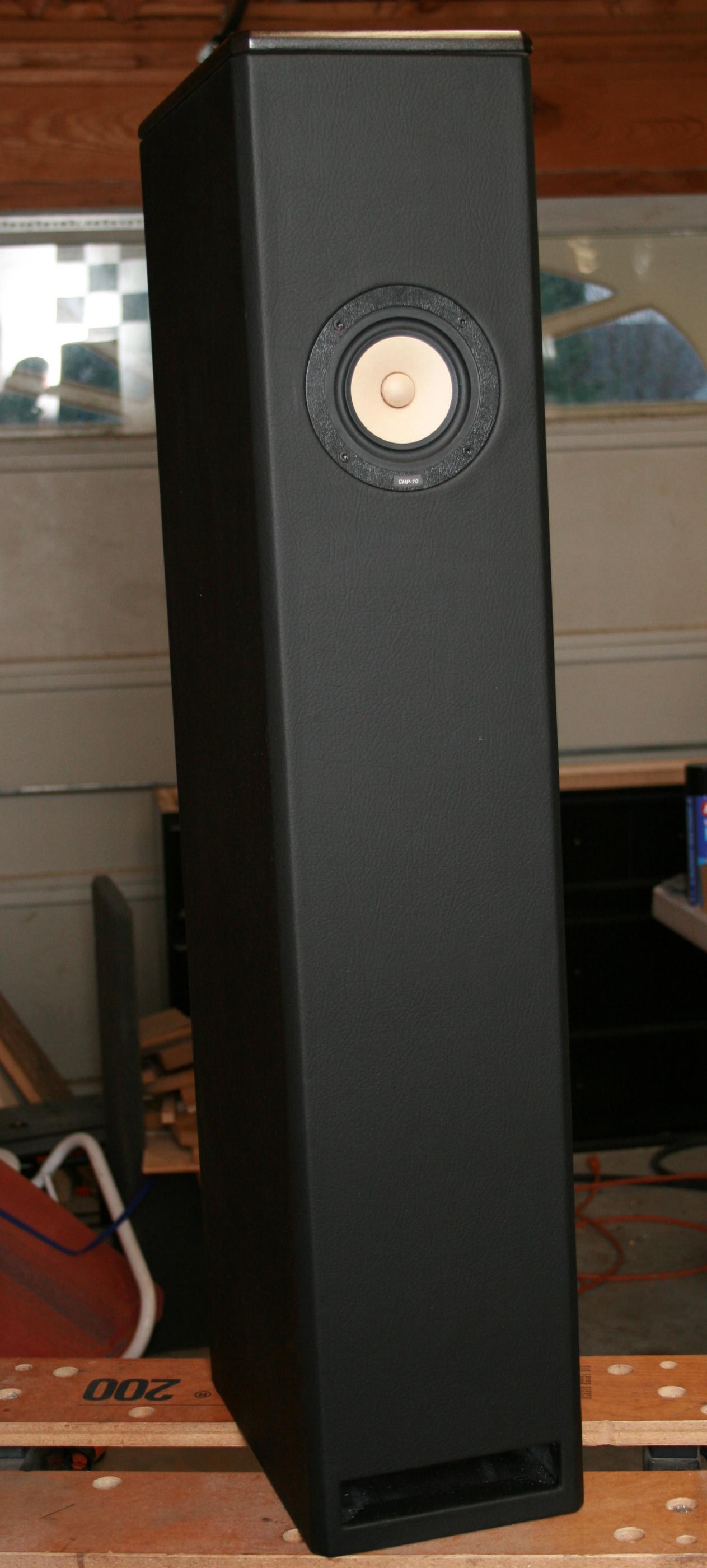

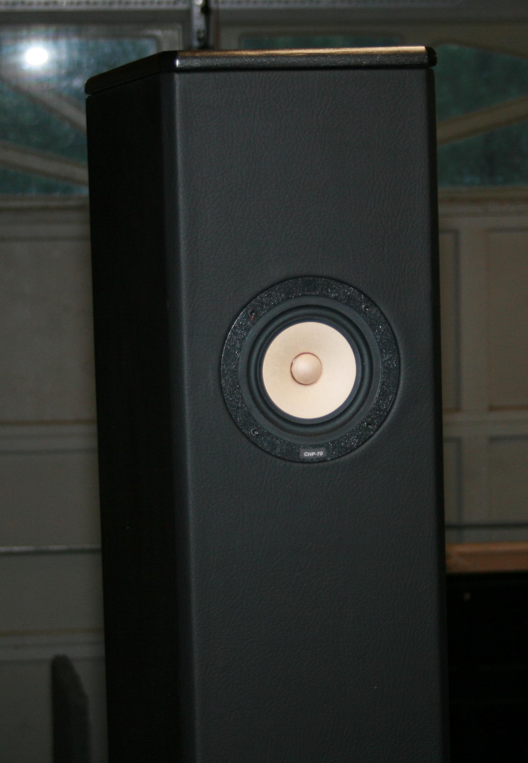

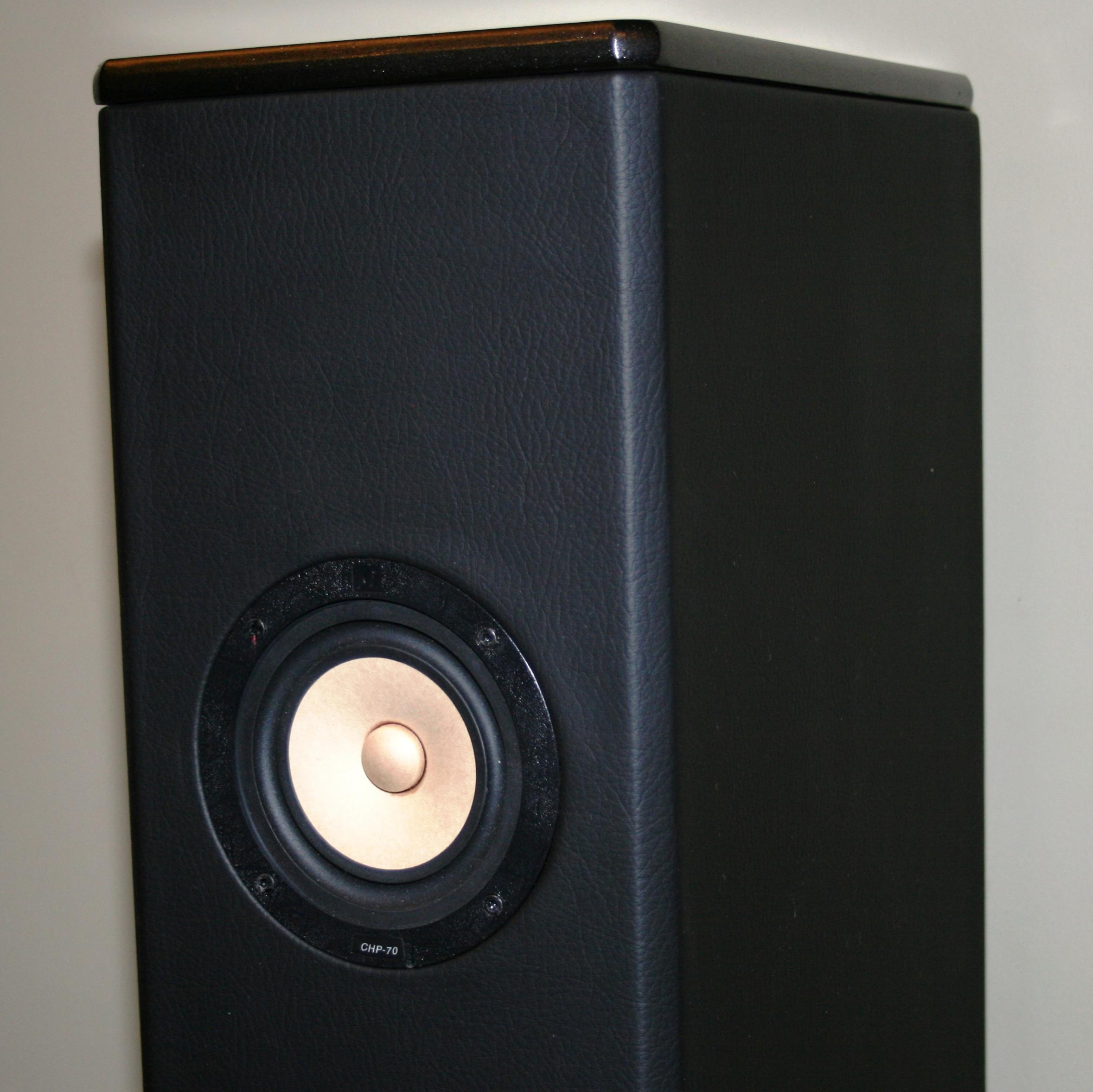

I wrapped them in black vinyl. First time I have ever done anything like this. Next time will be easier.

Last ones. Enjoy. I have not have a chance to sit and listen yet, but it is amazing the sound that can come from such a small driver.

Hello Malibujeff,
Good looking project and nicely made.
The standard of fit and finish is becoming top draw giving branded products a run for their money.
If you have the time, can you post some pics of the equipment you used. Any build information and advice you can give would help newer Diyers.

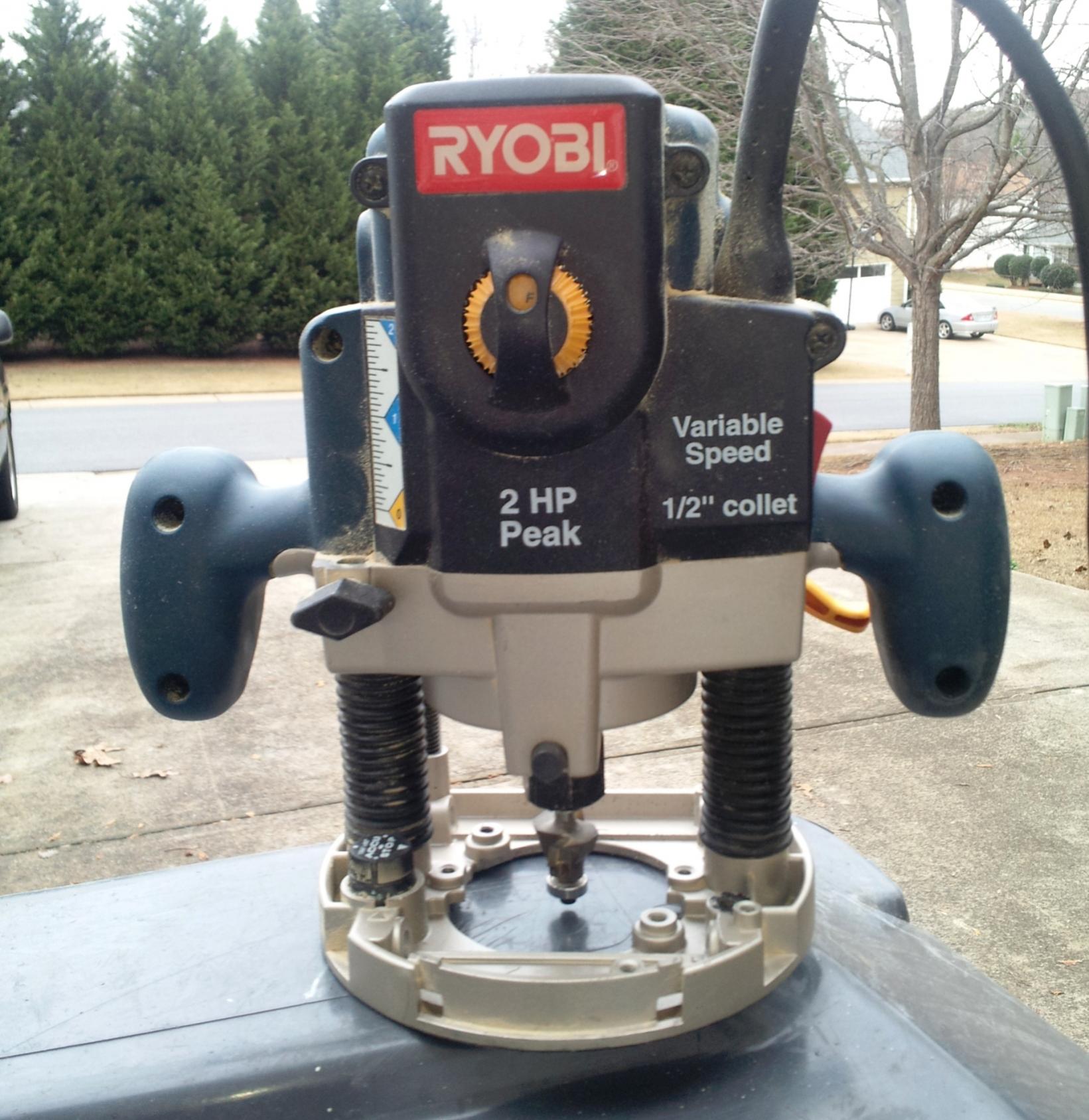

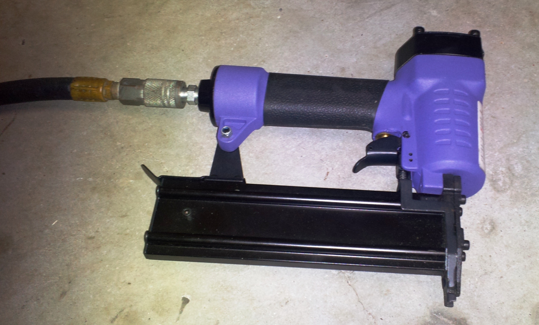

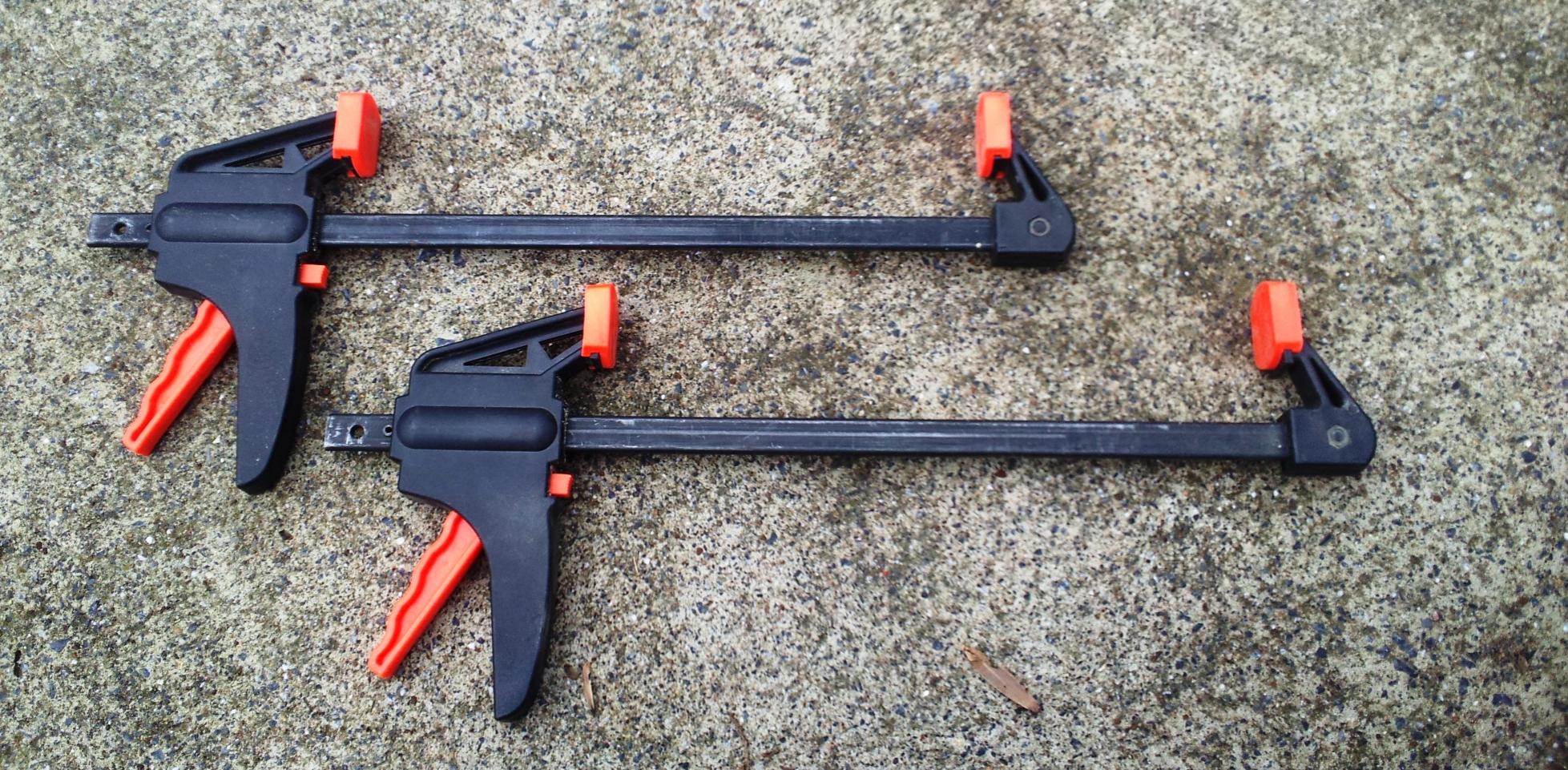

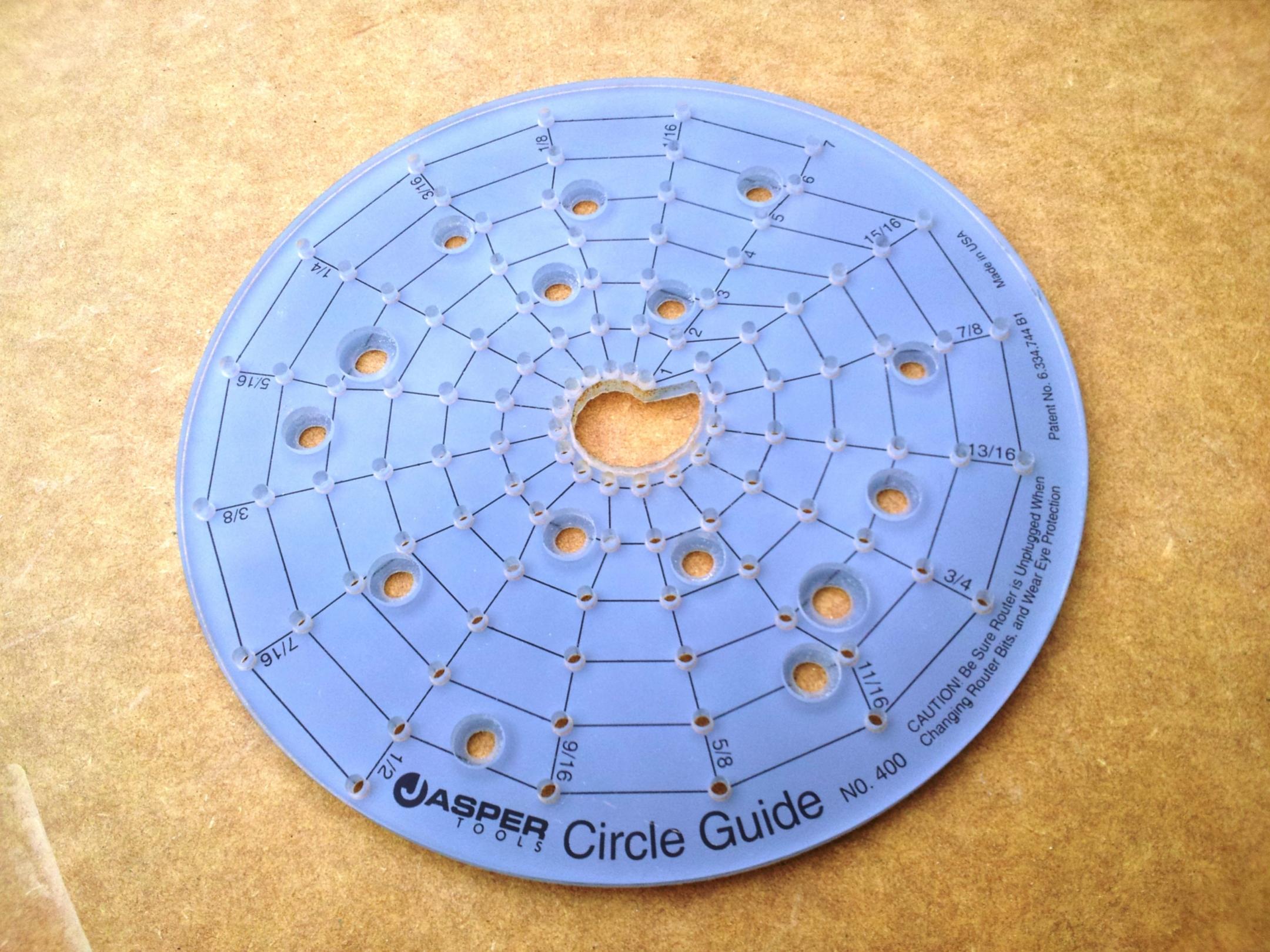

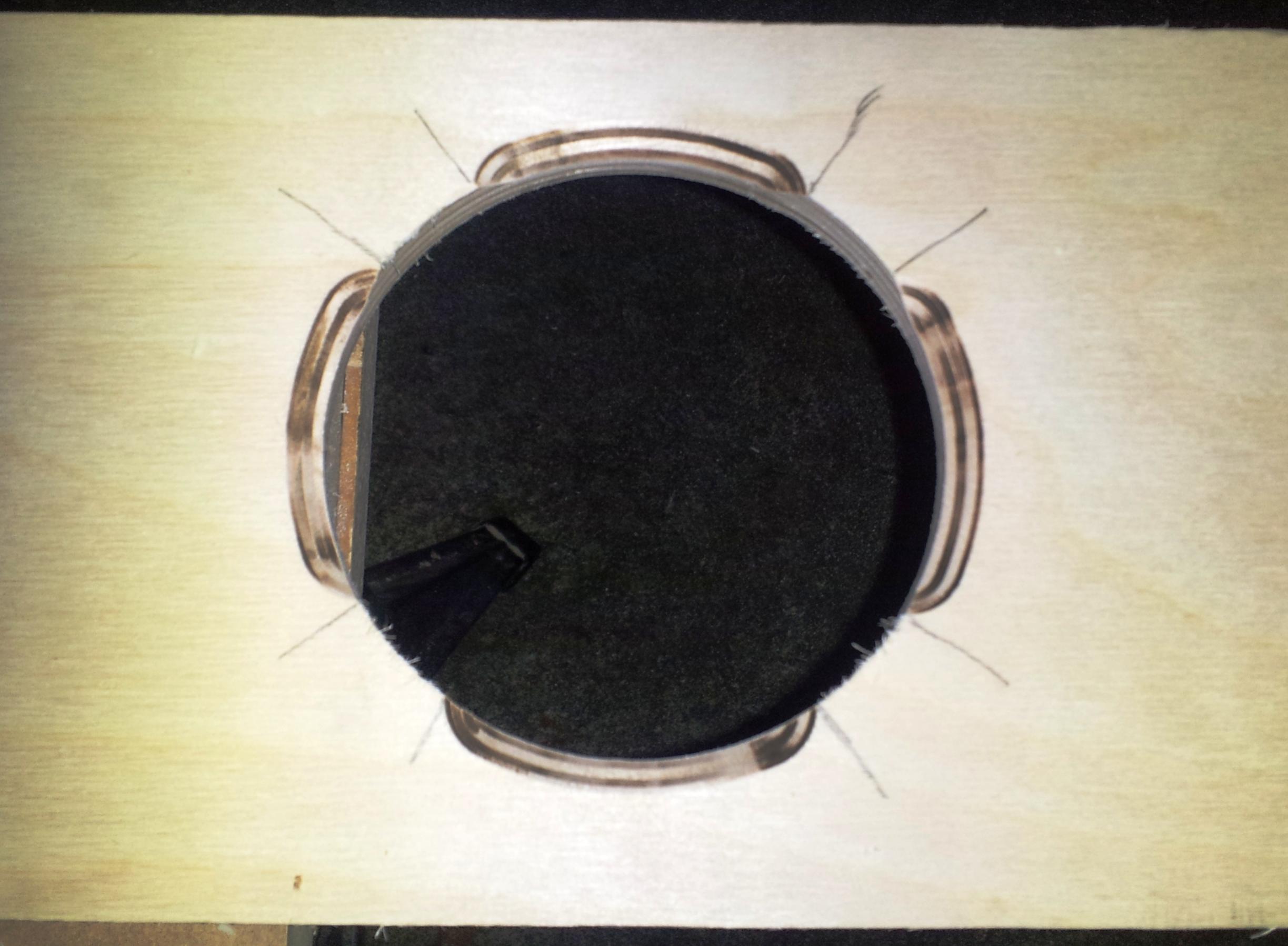

Thanks Mark!

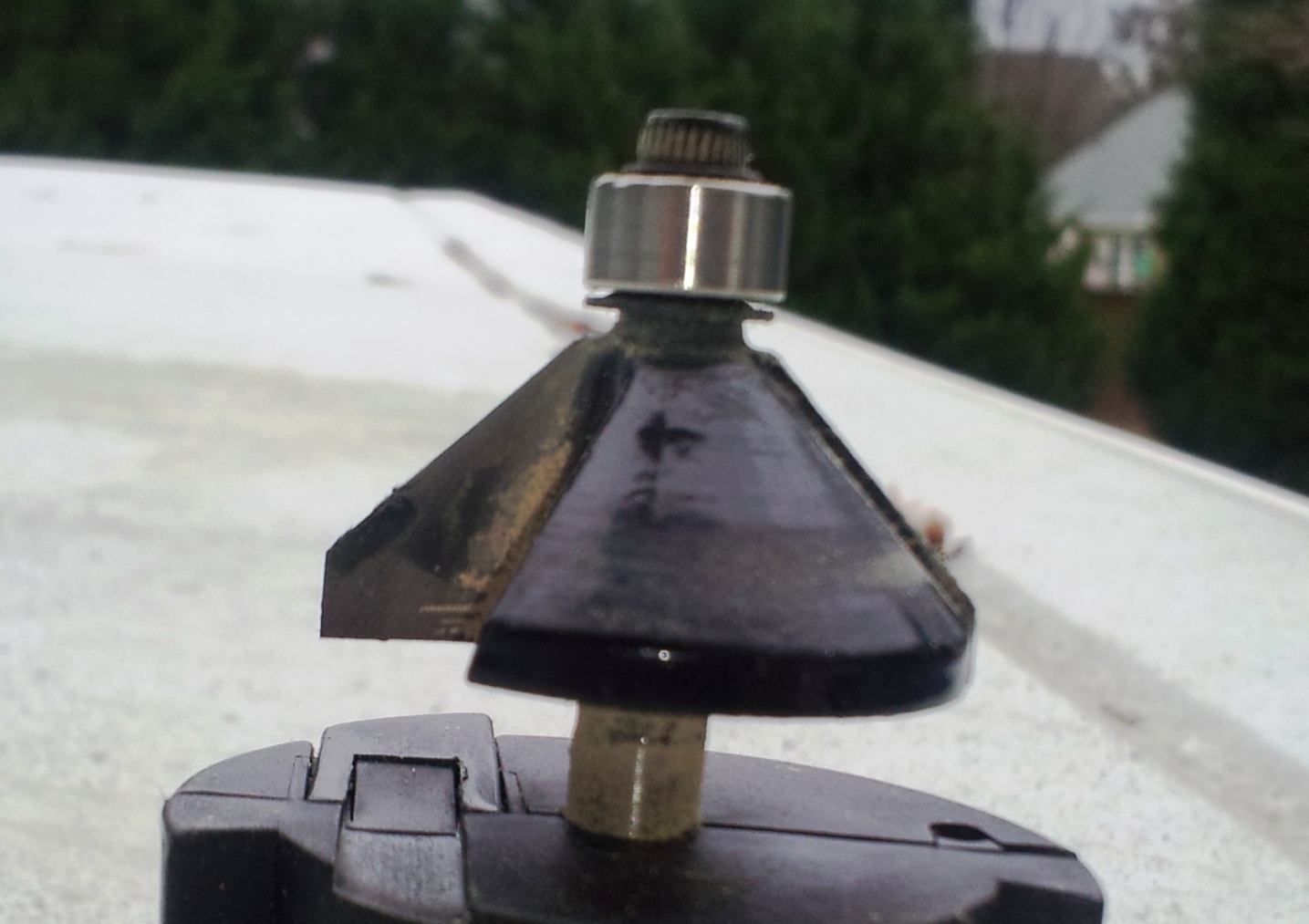

No special tools here, just the basics. I have a Craftsman Table saw that I used to cut everything. I used a nail gun with some small brads to keep the sides from sliding around during glue up. This works well if you don't have the tools to use dowels or biscuits. Here are a few picks. First is a Ryobi plunge router. Next, the Jasper circle guide used to cut the hole in the baffle. I use Titebond glue for my projects with great success. Must have multiple clamps. The more the better! The forth pic is the 45 degree router bit used on the back side of the baffle. And last, it the brad nail gun.

That's a beautiful build. Make sure to post pics in the Pensil Pics thread! How did you finish the back? This definitely gave me incentive to do a vinyl wrap build myself. LOVE the look!
Scott
EDIT: just saw you posted a couple pics in the thread already. Feel free to post more though 🙂

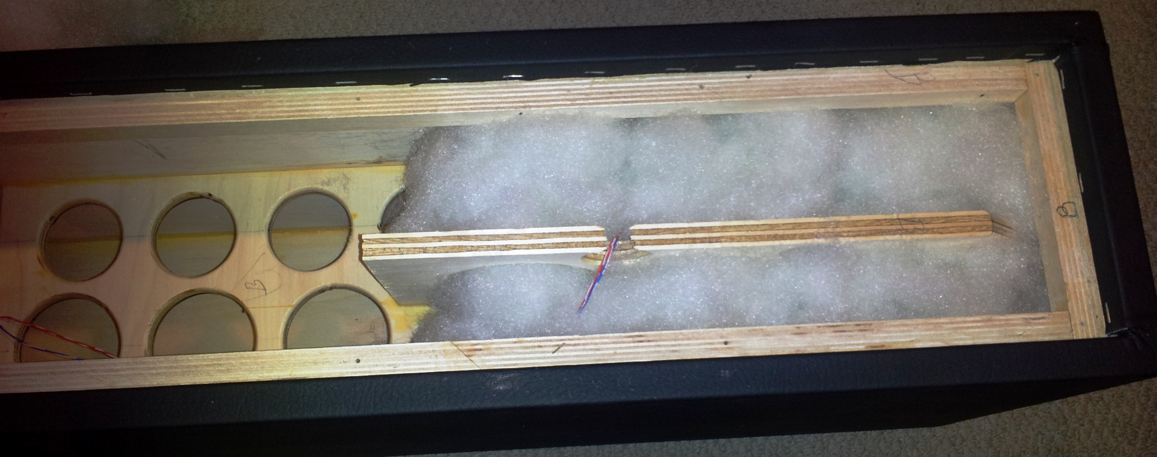

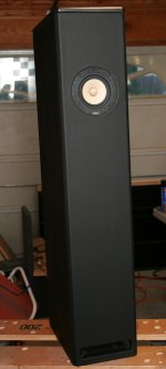

Sorry it took so long to reply, been super busy. Here is the only picture I took after I wrapped the vinyl. I have about half of the stuffing installed here. I pulled it around and used staples to make sure it held tight. Probably overkill, but I always tend to do that in my builds. I painted the back black and when installed, it hides the staples, etc...

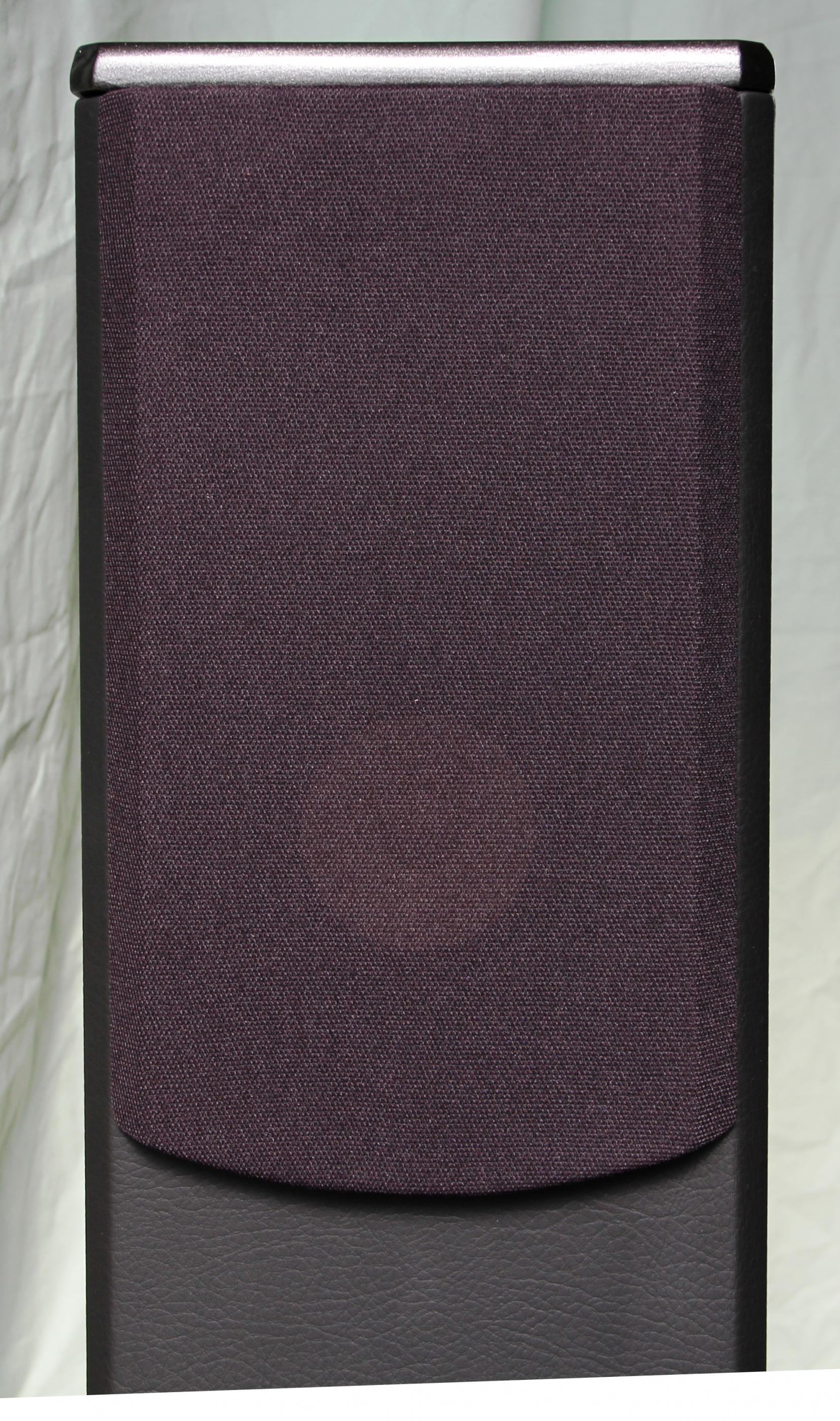

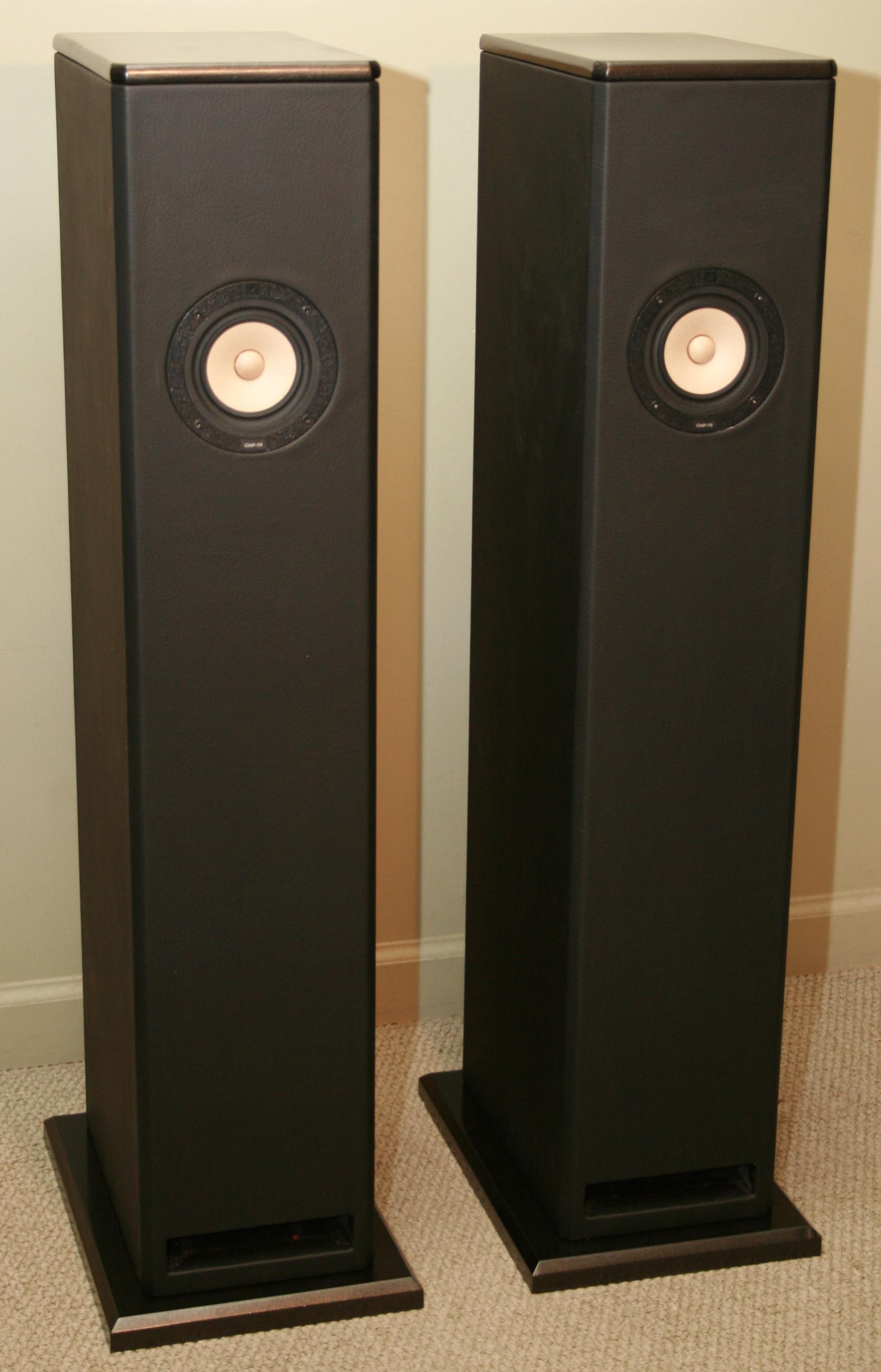

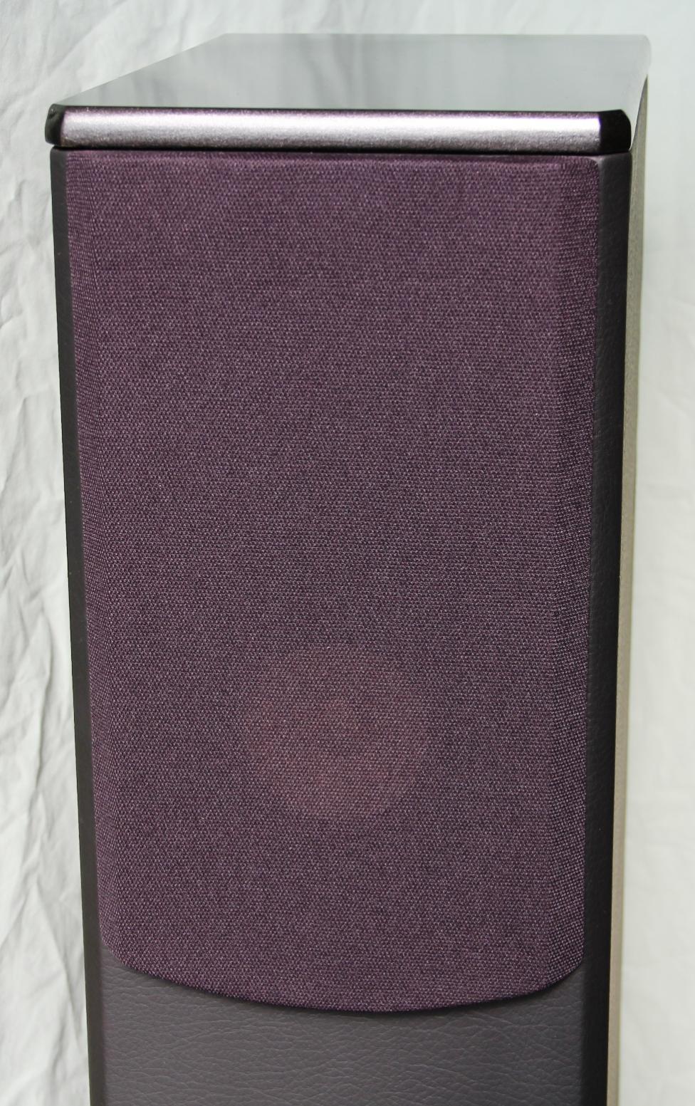

I finally finished the grills a few days ago. Here are a few more pictures. The grill cloth is black. Not sure why the picture makes it look different.
I have really enjoyed listening to these over the last week. With a sub taking care of the lows, it really does sound good...really good.

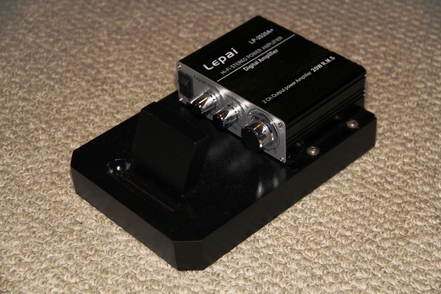

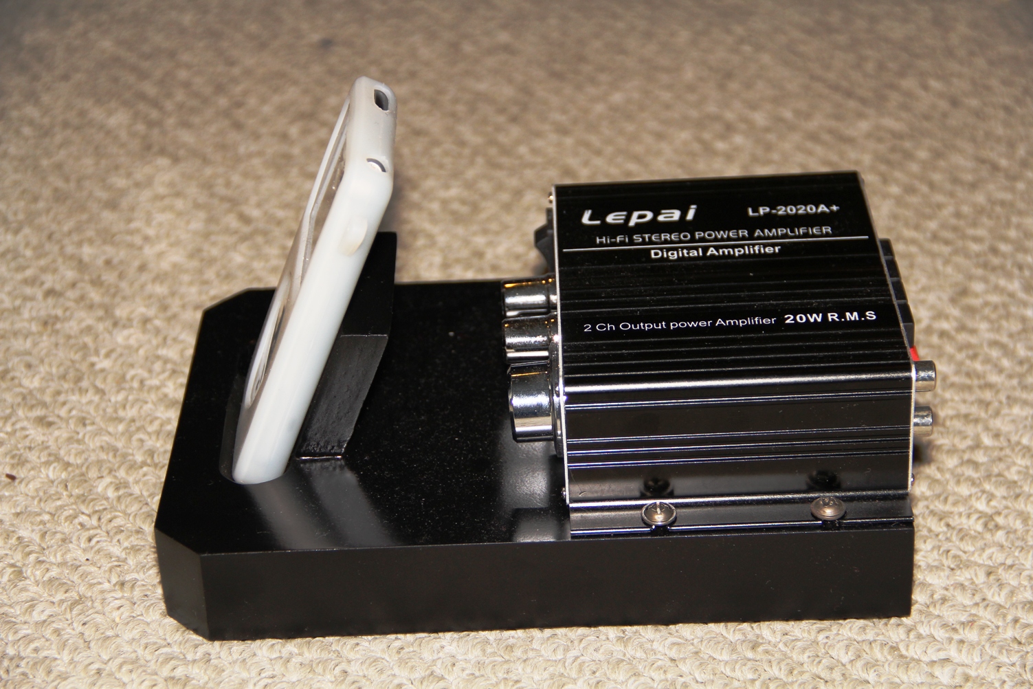

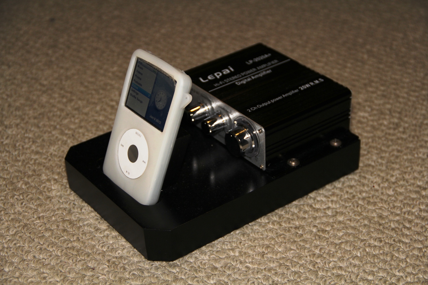

Tomorrow, I am giving them away to the HOPE Center for their conference room. They have been using a cheap clock radio and it's time they had something that sounds good. I'm using a small Lepai amp. See the pic below for the little amp mount I made. It has a place in front to hold an iPod.
