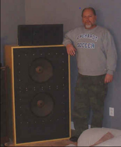

I'm sure they don't, but rooms are acoustically 3D, so any offset in one or more dimensions will put the driver/speaker in a different set of complex resonant interactions (eigenmodes), so in theory maybe enough to be audible even if you are raised to stay on axis, just not as much audible change of course.
All that said, it's these sorts of situations that early on made me a believer in speakers in general or at least the >500 Hz mid/tweeter BW be up high and angled down, toe'd in to 'taste', so in your case I'd personally use a normal seating and raise/tilt/toe-in the speakers and maybe even higher to get the driver centered in a 3D 'cross hairs' of eigenmodes.
